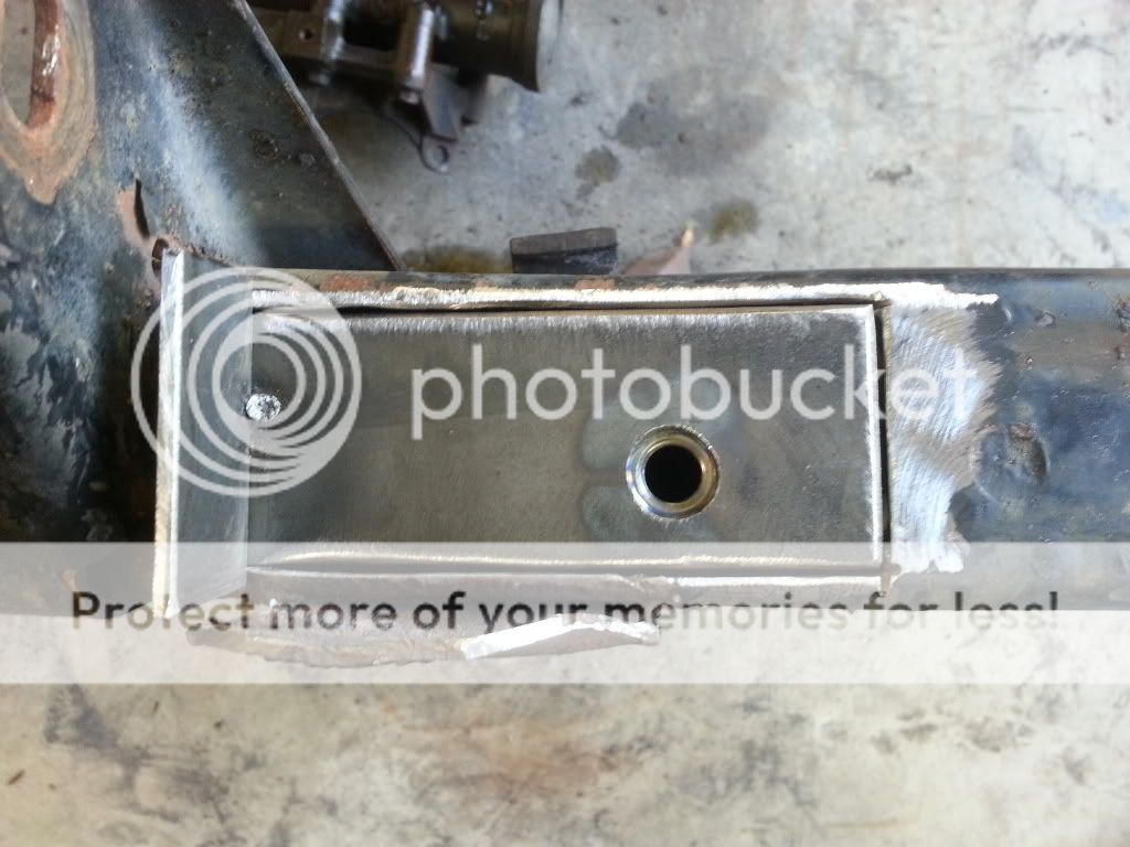

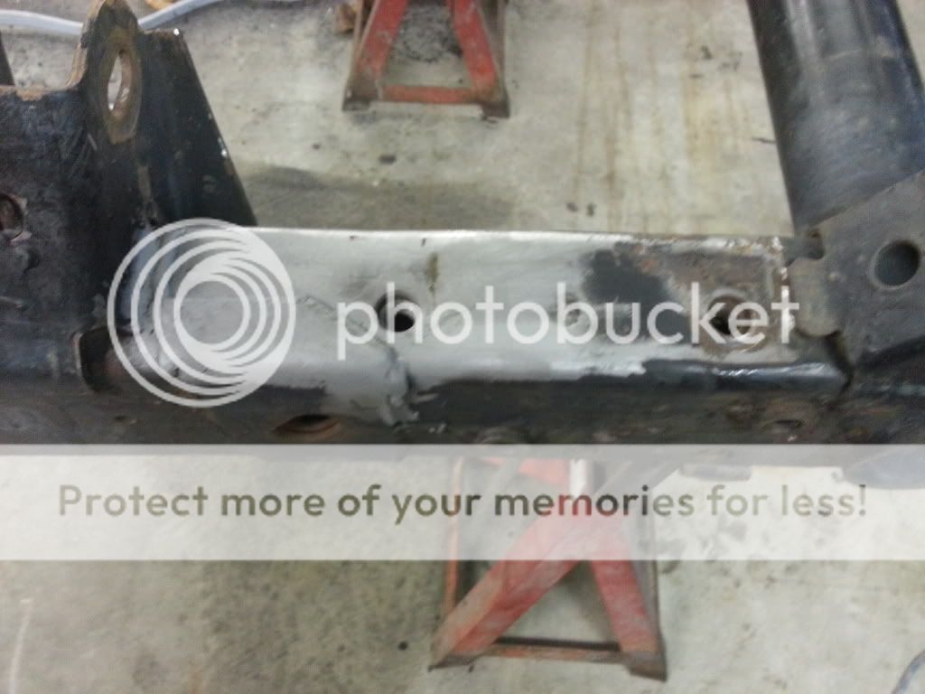

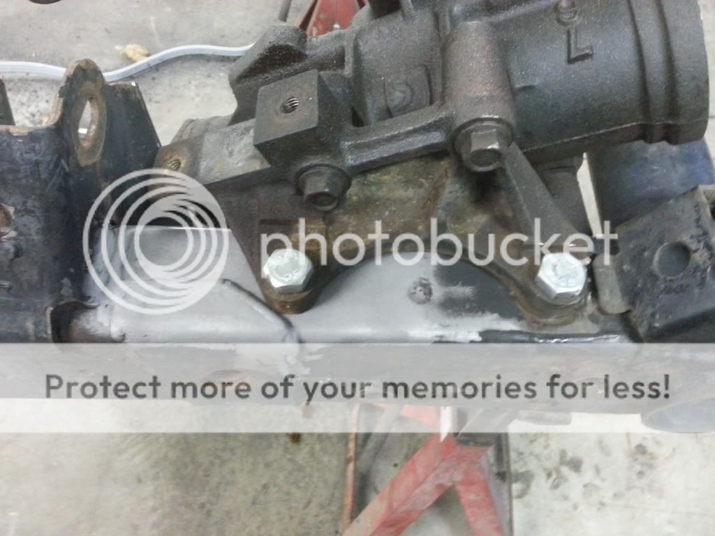

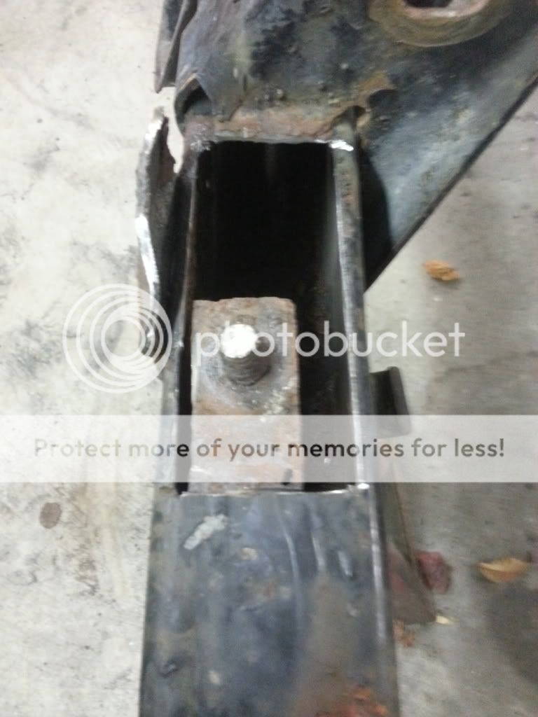

I was able to work on the patch by the steering box, I think it came out very good.
I welded a flanged nut to the back of the 10 ga. patch and fit it up:
All ground, sand blasted and test fitted:

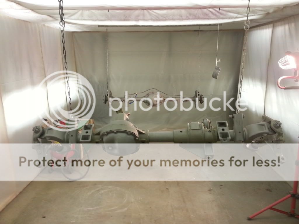

Zack and I have been trying to get out to the garage as much as possible but it's been hard. We've been sand blasting and epoxy priming some parts and the frame.
Here are the axles blasted ready to prime:
Primed with 3 coats of SPI Epoxy primer:
We also did some small parts and sprayed some parts silver to add some color under there:

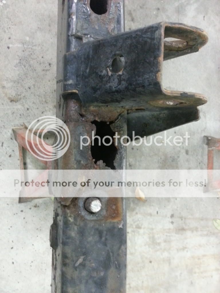

Unfortunately while sand blasting we found 2 more rust spots that will have to be patched, here is one:
I have a 7 day recoat window with the epoxy so if I get my repairs done before then I can just shot over the existing primer without having to scuff or sand.
I'm still debating if we will try to fill any of the pits left from the rust, I'm tempted to but I have to keep telling myself it's just the frame!!!:

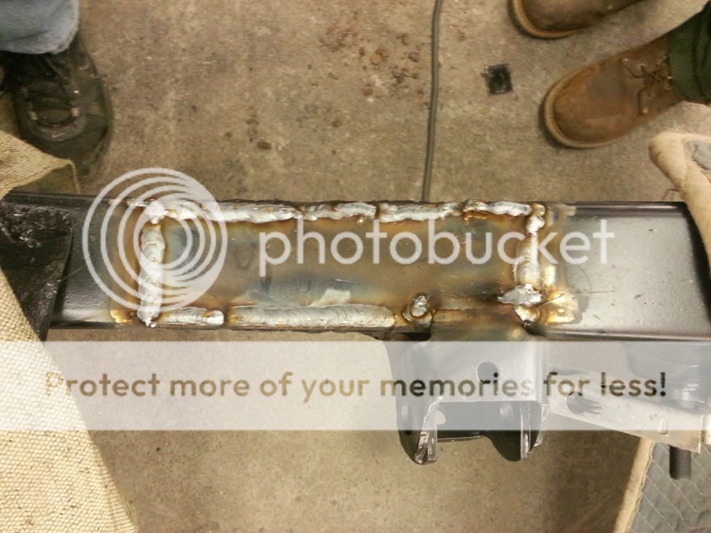

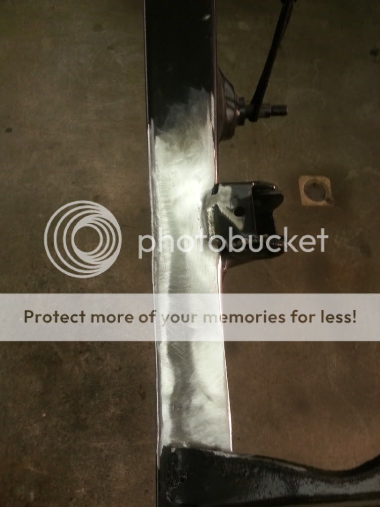

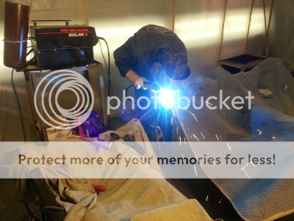

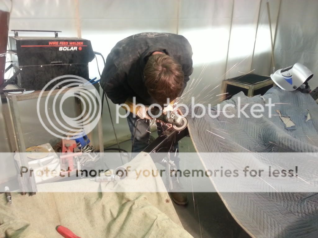

Zack and I worked on the last 2 rust spots we found while sandblasting the frame during the week.
Here's the patch all fit up ready to weld:
Zack welding it up:
I'm not expert but I think he did a great job welding (any advice would be appreciated):
Grinding it down:
And the finished product:
I was very proud of the job he did, I tried to stay out of the way and let him do most of it.

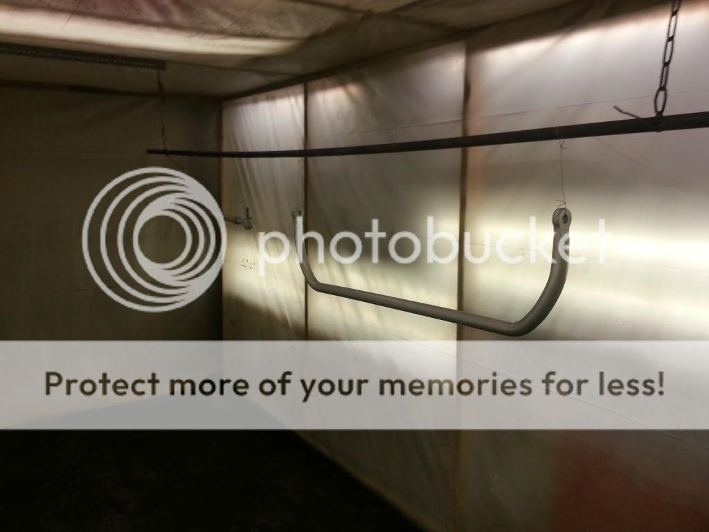

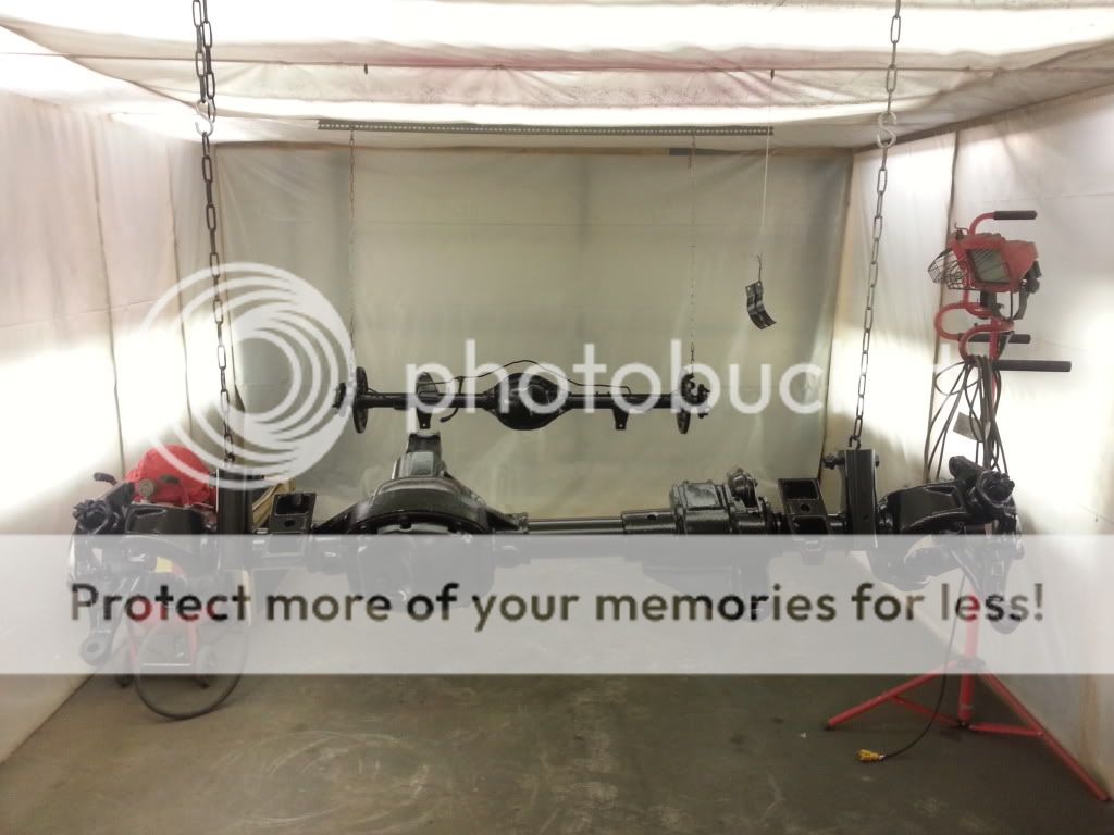

Saturday Zack and I spend quite a bit of time sandblasting, cleaning up and priming more parts:
We still plan on spraying the new springs that came in the RC 4" lift then we will be able to start reassembling the suspension!!!

Man it is coming along great. The only thing I would have considered doing was putting a bit more steel around where the steering pump mounts. The less flex the better. Otherwise, looking pretty darn good. You guys keep it up.

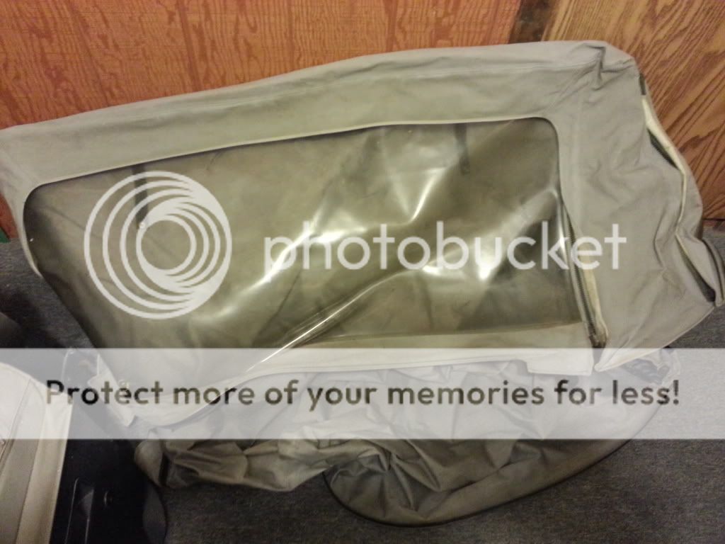

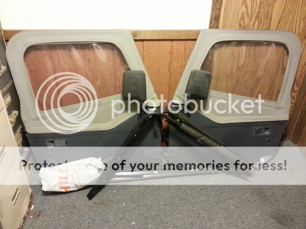

I finally took some pics of the 1/2 doors and soft top we picked up from Craigslist a few days after we bought the Jeep. We got the doors and Besttop frame and canvas and the best part was they were only a couple of miles away. I one door will require some work on the lower corner but other than that they are nice. The top is in okay shape, we will probably just end up using the frame and get a new black canvas.
So now we have the options of the original hardtop and full doors or the softtop and half doors.
