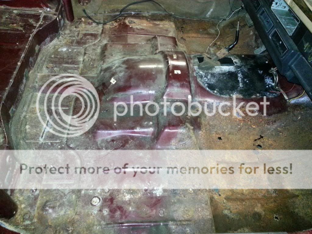

My youngest son turned 15 on August 6th and he is into cars like me. Ive always wanted to do a project with my boys and I thought a Jeep Wrangler would be great. I bought the Jeep from my brother-in-law who is a car dealer, it has high miles (220,000) but runs and drives great and the 4 wheel drive engages and seems smooth. My B-I-L has sold some Jeeps so he knows where the bad areas are on the frame to watch out for, and this frames looked good. We knew it would need floor pans and a few patches on the body but for a New York vehicle it was solid!!
Here are some pics of when we purchased it:

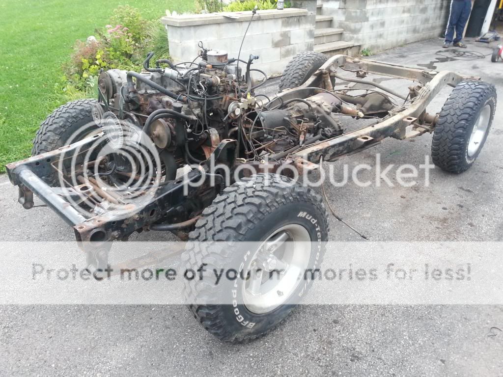

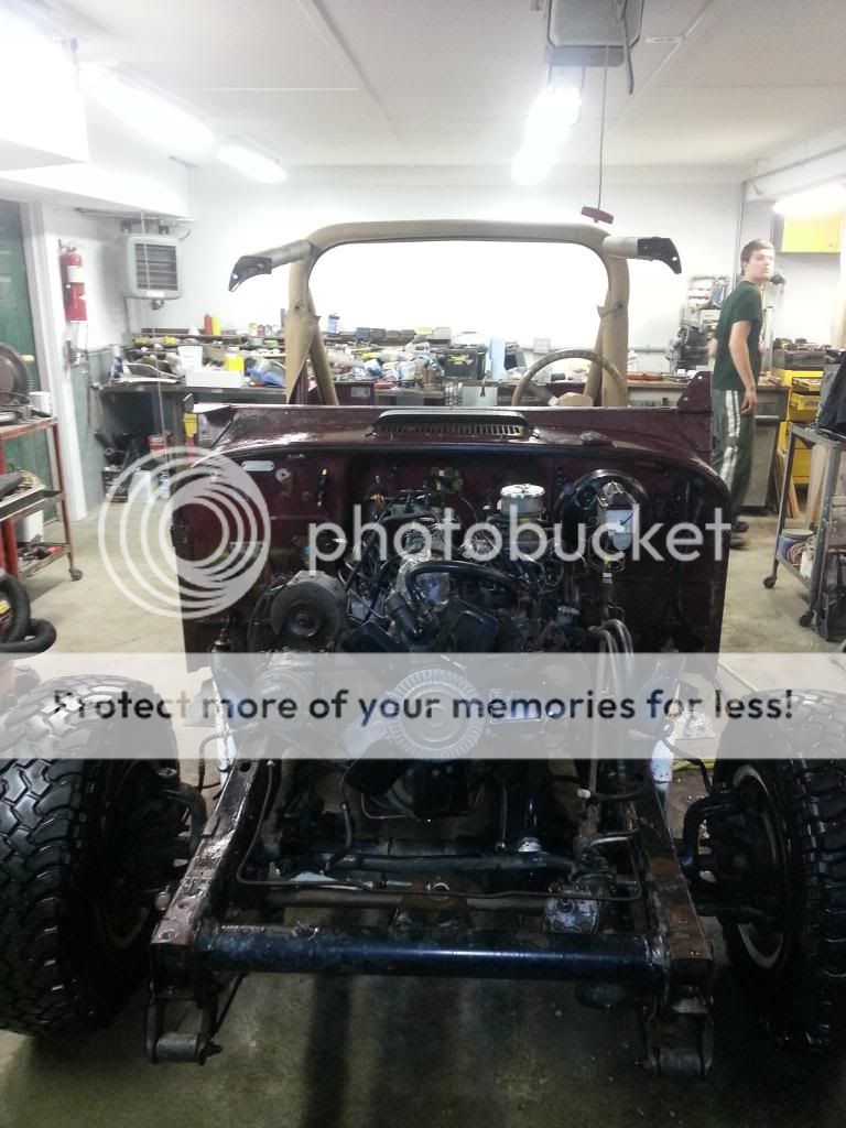

I didnt really say that we purchased the Jeep about 2 weeks ago and have been making progress on stripping it down so I wanted to update where we stood last night.
We pulled the motor out last night and hopefully tonight we will get the trans/transfer case out and all power washed up.
This is the way it sits right now:
And a couple of other shots:

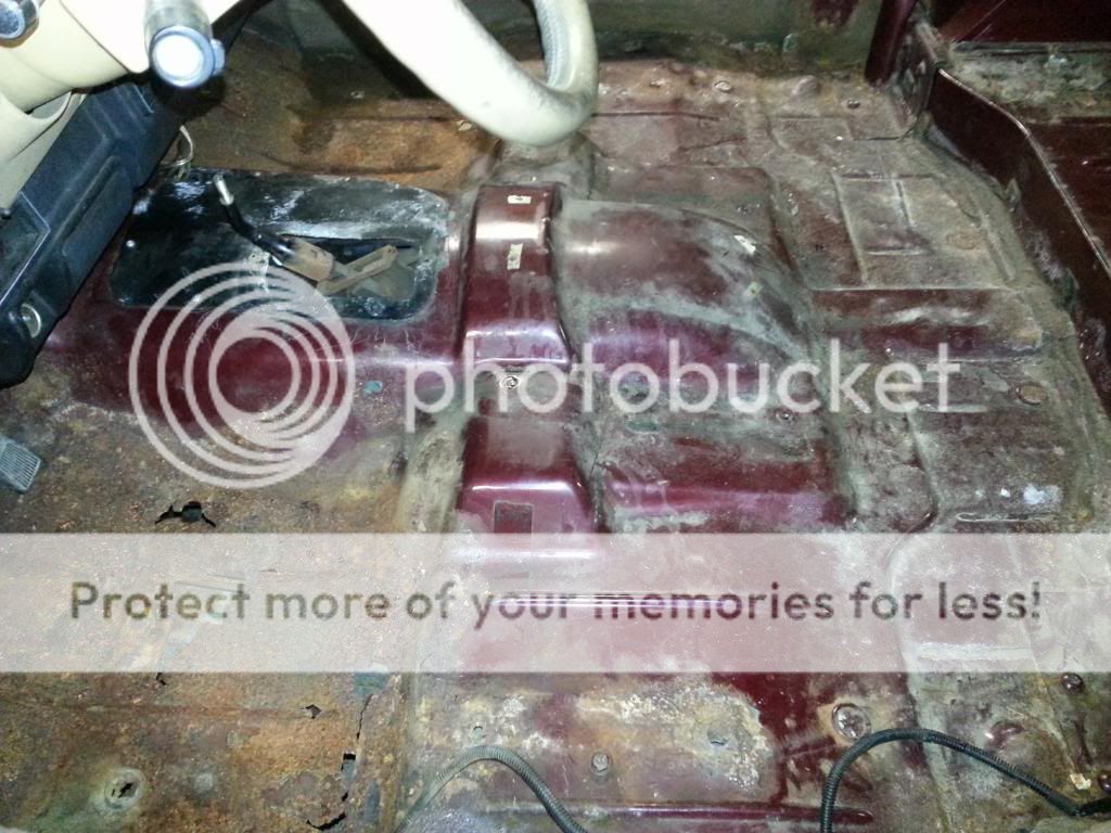

Here are a few pics of the front floor pans we need to replace. Im not sure if I want to purchase just the front pans or the rears also. Im very thankful the floor seems very strong around the roll bar mounts:

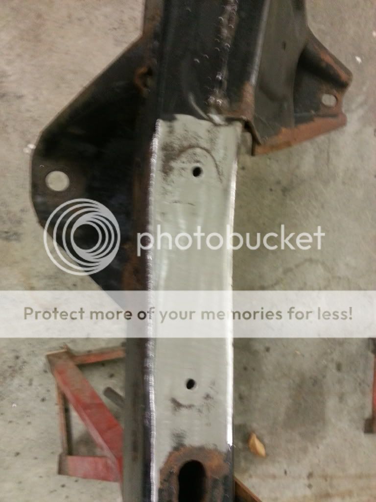

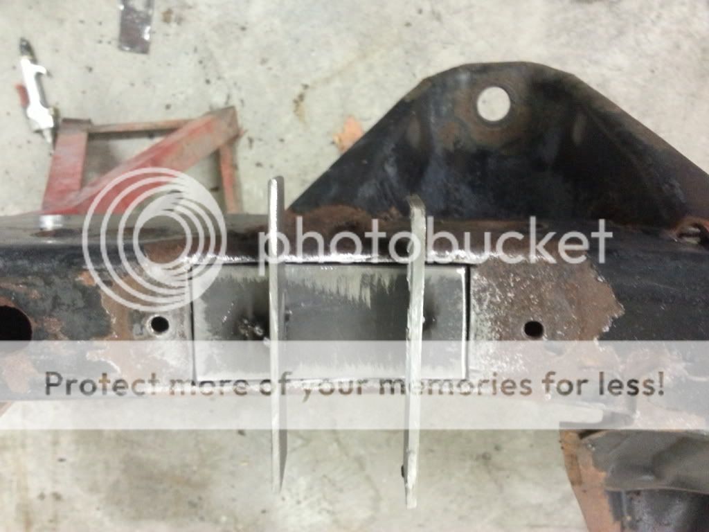

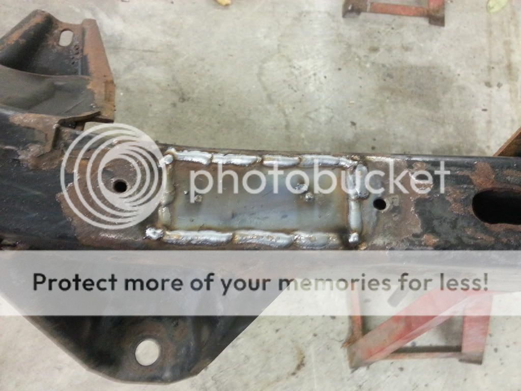

My son wasn't feeling well tonight so I went out to the garage and did some welding on the frame, I repaired 2 spots. I got some 10ga. steel from work to make the patches.
Here is one of them:
I have not done much welding just some sheet metal panels, does anyone have any suggestions, should I have a bigger or smaller space between the patch and the frame to help with penetration? I did put a small chamfer on the metal before welding.
Thanks, Steve

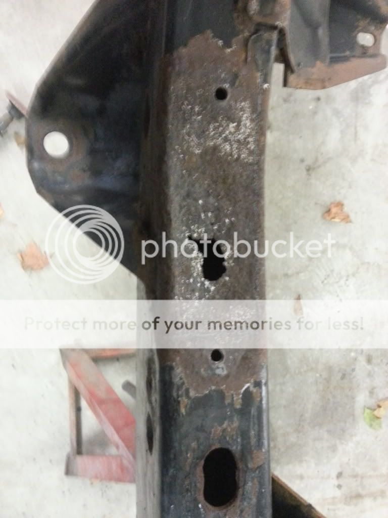

This will be the next area I need to fix:
If I weld a nut to the back of my 10ga. patch will that be okay? I realize I will have to retap the nut from the heat.
Any sugguestions?

That's how I'd do it. Only I would use a flange style nut
Why a flanged style nut? There's more material there so the heat might not distort it as much?
Thanks, Steve
