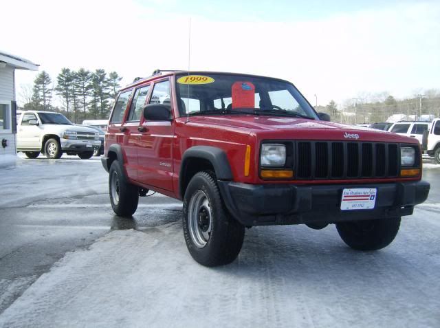

So I went and looked at those two Jeeps... They weren't bad but I don't think either of them was quite worth what was being asked. I did however find a super clean Jeep at a dealership which is really reasonably priced but more than I wanted to spend.
1999 XJ 4 door 5 speed red super clean 105k miles
They are asking $4995.00 I called and offered them $4500 out the door taxes, title doc fee all that stuff. I am waiting on a call back from the general manager. I didn't want to eat up all my funds, but in the same sense I don't want to buy junk either. I would rather get a nice vehicle with low miles and upgrade later when I have the money than put a bunch of money into something just okay and still have 4 or 5 grand invested. I booked it and what they are asking is exactly what it books for. That seems fair right?

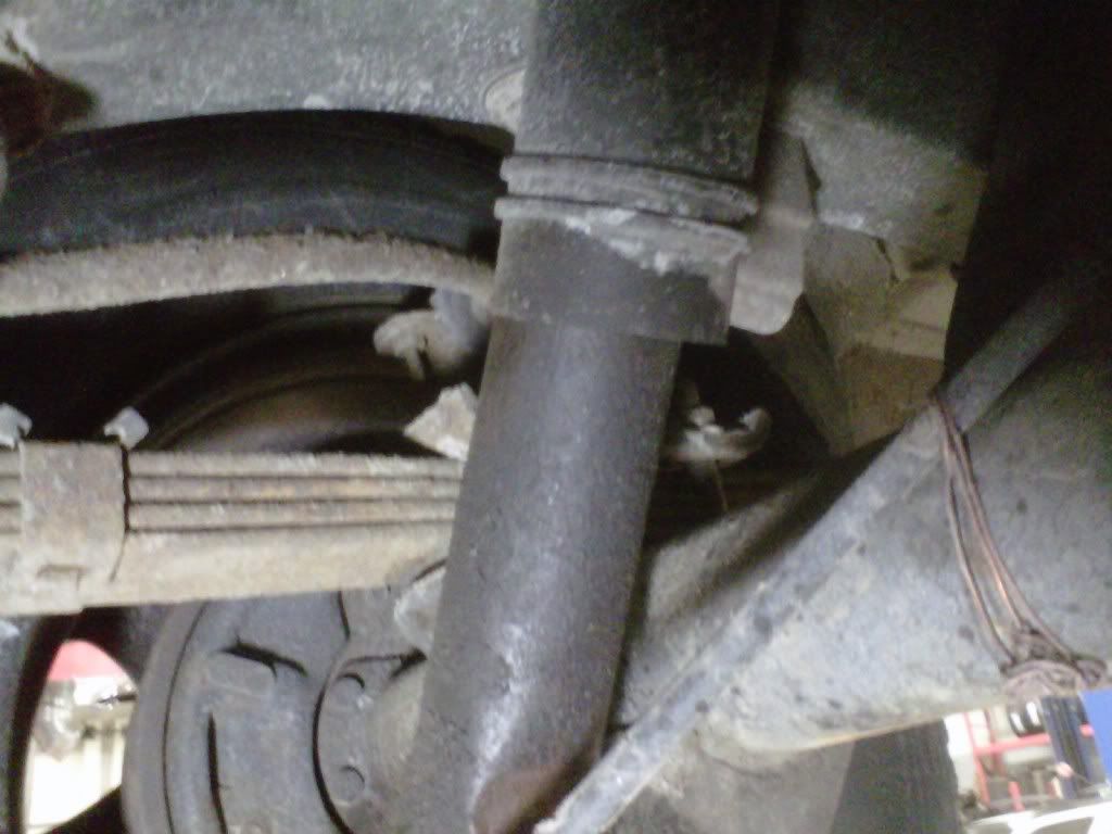

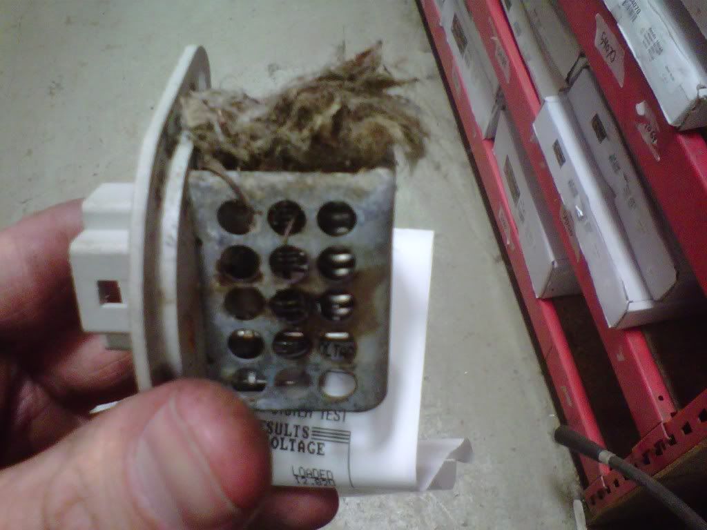

I brought the Jeep into work today and checked it all out on the lift. I greased and shook the front end down and it was tight as can be. It does need a few minor things but nothing serious.
Brake Rotors Are Nasty
Rear Shock Leaking
Front Pinion Seal Leak
Blower Motor Resistor...Not Sure Why It Wouldn't Work :dunno:
Minor Rust Spot On Passenger Door
Paint Chipped On Flare
Overall the Jeep is in real good shape I am not too worried about the minor stuff. I want to get that rust fixed first off before that becomes more of an issue. I also need to reattach the passenger rear fender flare the bottom is a little floppy. I am going to fix the brakes and pinion seal once it warms up outside and the damn snow is gone. I am also going to drain and refill both front and rear differentials and changeover to synthetic fluid...the fluid in the front differential was naaaaasty. I had to add a little bit of fluid to the front and rear differentials but not an alarming amount. The shock isn't really a concern of mine because I intend on lifting it this summer and it will come with shocks. I did change the blower motor resistor out because I only had heat on 4 and it wasn't even the right speed but it works perfect now. Fluids under the hood were all good and my air filter was clean. I cleaned the throttle body plate while I was under there, but it wasn't too dirty. When I was looking it over I did find out that it has a front tow bar which is sweeeeet.

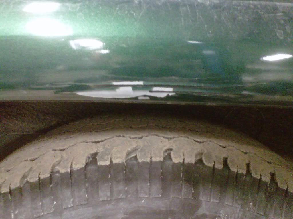

So I decided to sand down that rust spot on the passenger door. I was hoping that it was only surface but sure enough there was a small hole there :brickwall
You Can See Where It Is Bubbled...
Sanded...
Sanded A Little More...
This Is What I Ended Up With....
Filled With Short Strand Fiberglass
Sanded And Shaped...
Painted...
Finished Product...
I know that filling rust with bondo is not the ideal way to repair something but it only cost me $5.27 in paint. We had some filler kicking around the shop and sanding discs are free...if it lasts even a year or two I won't complain. If it rusts through then I will buy a door and have it painted right, but it works for now. I know it isn't perfect, but I intend on bedlining my rockers and the bottoms of my doors with herculiner and that will cover up any imperfections.
