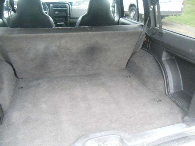

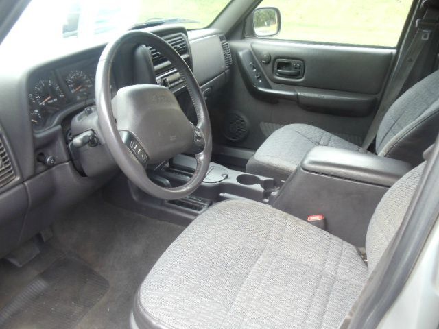

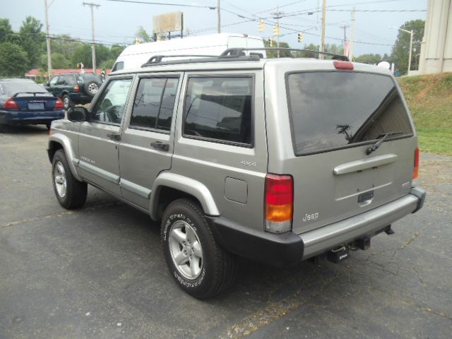

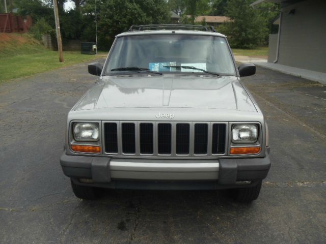

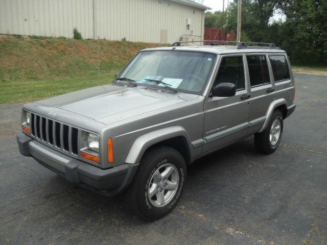

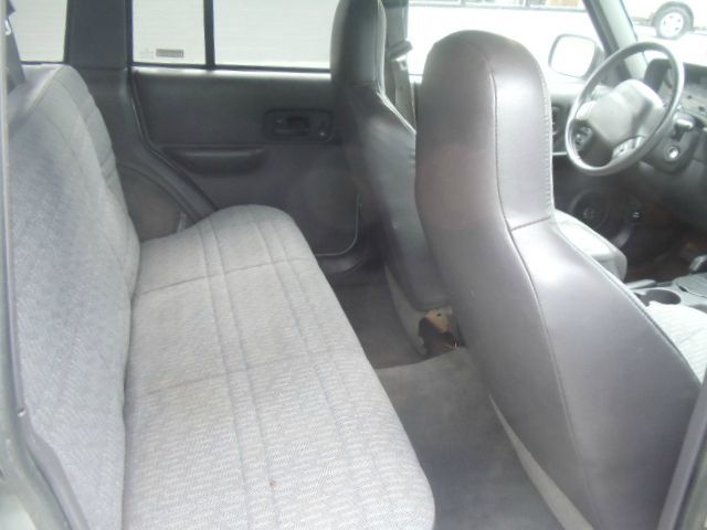

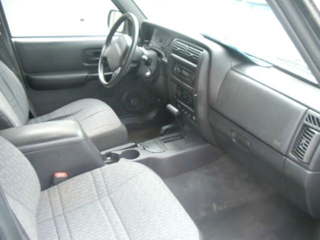

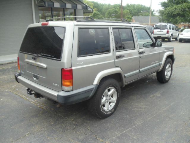

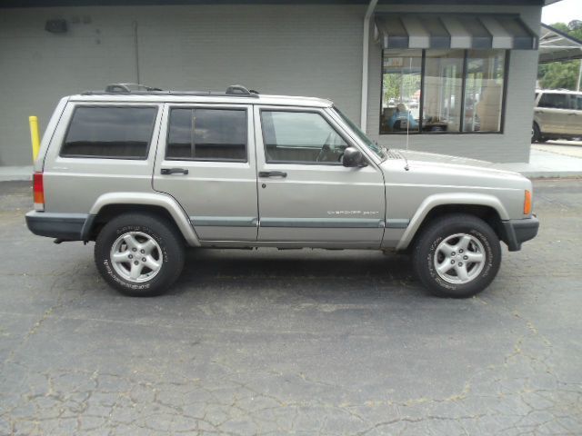

Well, I finally found a suitable DD to give my TJ a break and allow me to use the TJ in the manner I built it for.
I present to you my new XJ.
2000 Jeep Cherokee Sport
4.0 auto 4wd
D30, C 8.25
No rust
Mopar Hitch
Stock minus some stereo equipment
When I got it:
How it sits now:

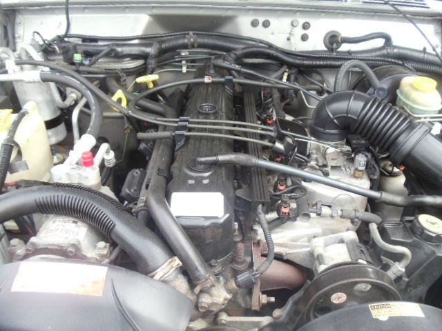

One of the things I regretted about my TJ build was not having the sense to save copies of the dealer pics for reference of what I started with. I made sure to not make this mistake twice.

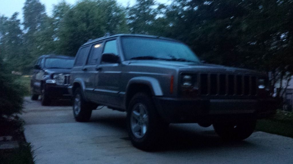

At its new home. The Liberty is my wife's. (forgive the slight blurriness)
My other 2 Jeeps:

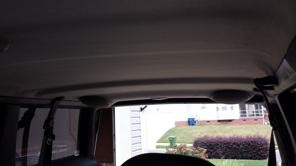

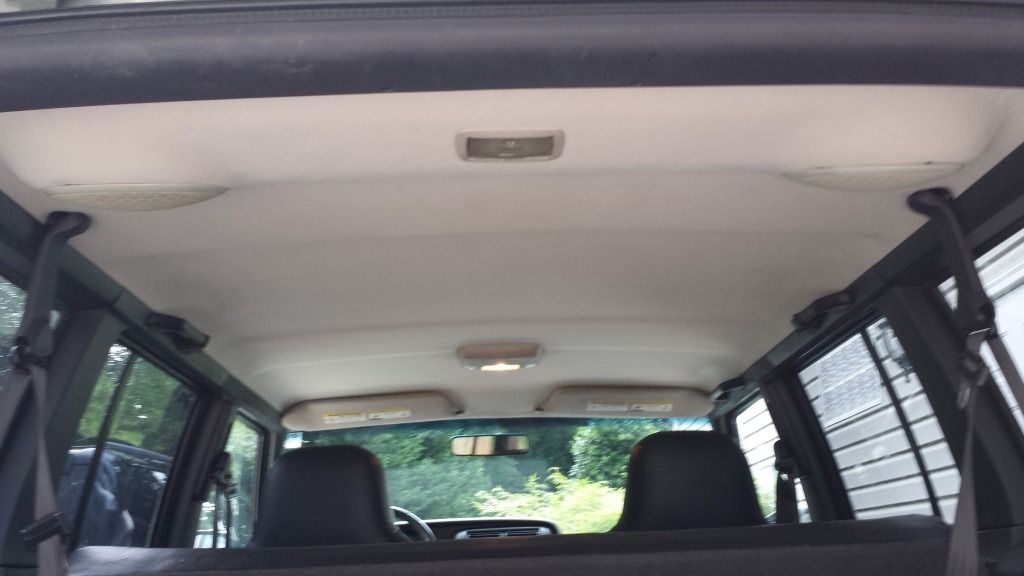

New headliner is in. Very very nice. Definitely taking my Waggy to that shop for interior work when the time comes. ****ty tweeters one of the PO's added to the rear are also gone (my request).
Pics of the headliner:
