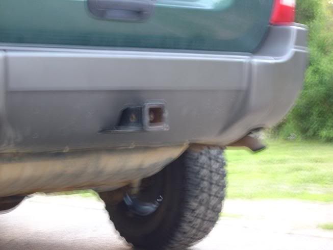

Need recovery. Lifted Rear Hitch and front OEM hooks.

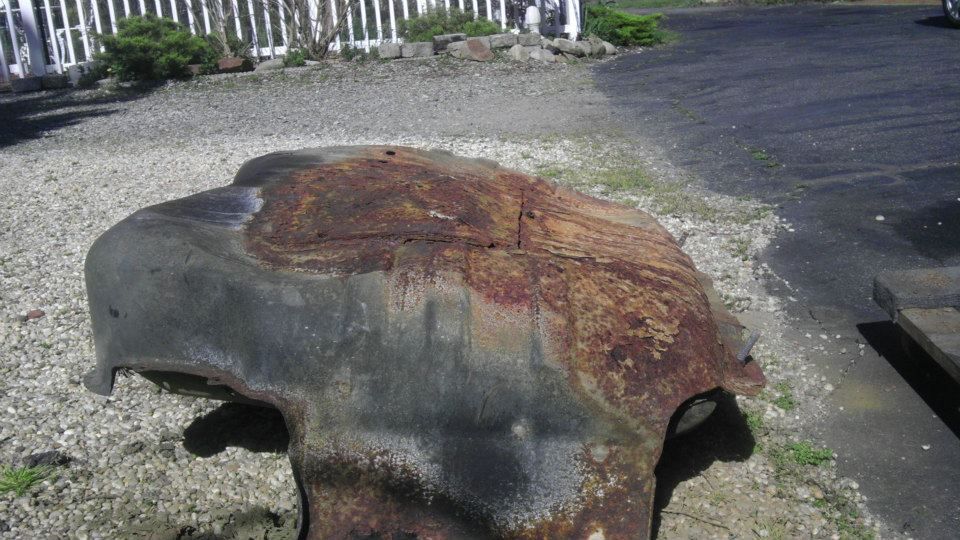

Since now I had A ton of spear parts i traded my old 31s for a new tank and skid plate. When empty and with the light on I could only fill up about 16 gallons in my Jeep Tank. (CHECK its suppose to fill like 21 gallons).
I could push my finger through the rust.
Here is the new tank skid already cut and being mocked up for welding.
Had an other friend Tig weld it for me.

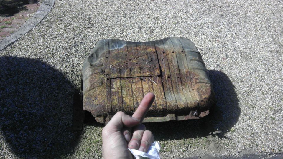

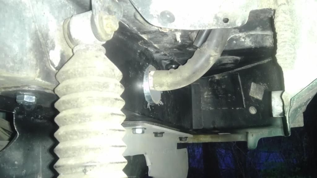

Two things here about doing the task tank tuck. Always put in a tube in the frame. WJ is a UniBody and any hole in the boxed part of the frame will weaken it. Dont care what anyone says. So I got a piece of conduit and made it more oval to fit longer ways with the hole in the frame. Second was since the tank was higher sharp angles cause a backup when filling (TJs sometimes have this issue) I straighted out the filler tube and shortened it so that the rubber tube is more slopped and less at an angle.
That was the best slope I could get without cutting the body up.
Now with the tank in i was able to mock up everything and start finishing up.
Cant Find a pick but the tube was welded to the frame.

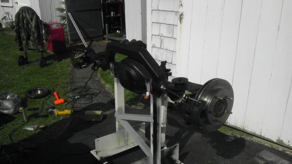

So now this pretty axle is ready for installation. I made that axle stand from an old server rack. The stand is FREE for pick up only on Long Island New York. If your interested in picking it up PM me.
With the Tank Lifted about 4 inches and pushed back about two inches the rear Now Fits.

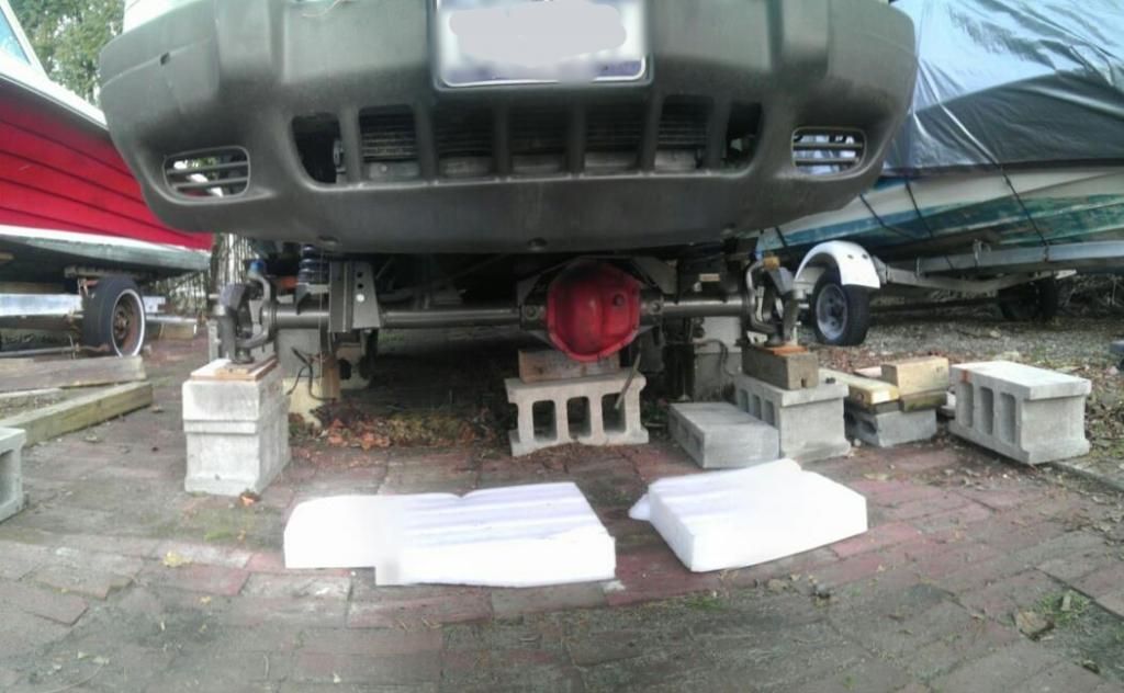

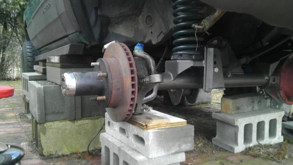

Here are some pics of the rear Installed.
The rear drive shaft had to be shorted because the ford 9" is a third member I guess the gears are more forward.

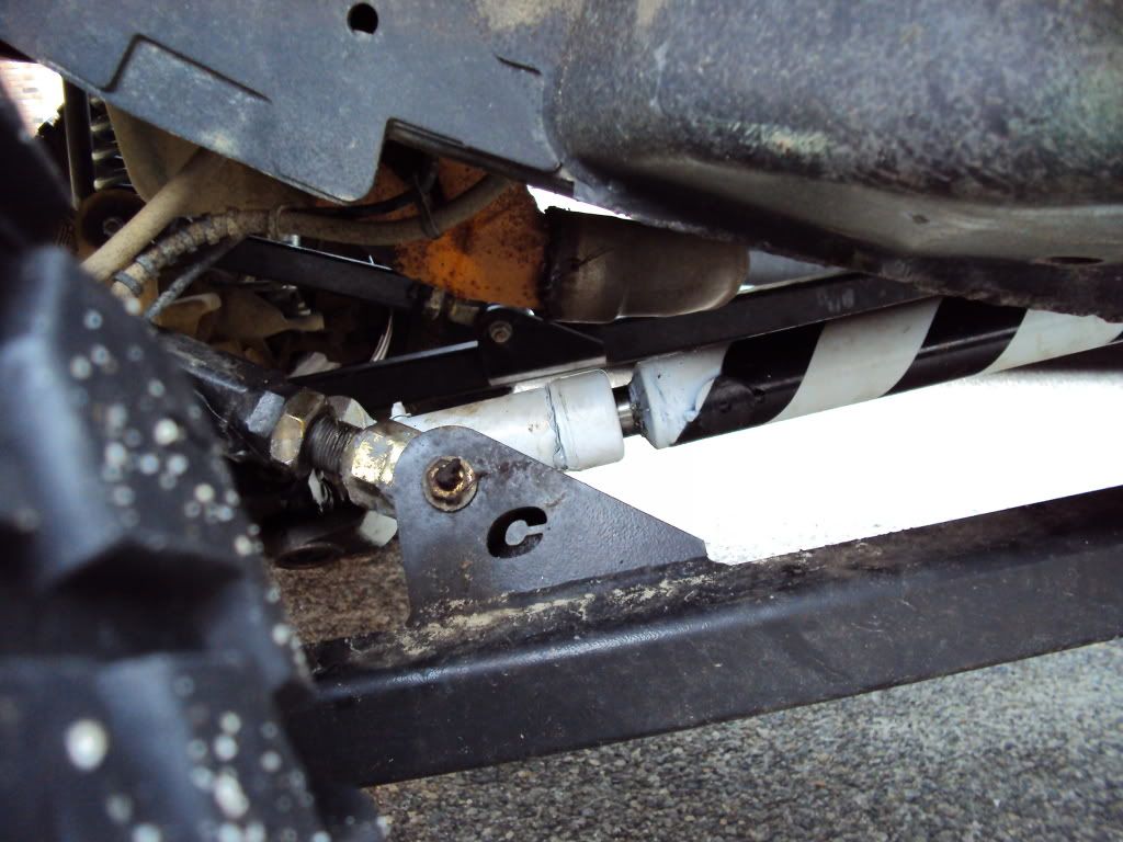

Finished the Front up with a Steering Stabilizer. Planning on later on putting in Ram assist. So that ugly piece of metal to the left of the trac bar will be widely used.
That mount on the Steering Stab. is actually a BPE mount for a shock by Iron Rock.

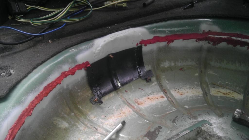

Welded in most of the old tire tube back in. Then I sealed it shut with 3M Fire barrier.
Made a trap door so that I can get to the filler tubes if the tank ever has to come down.

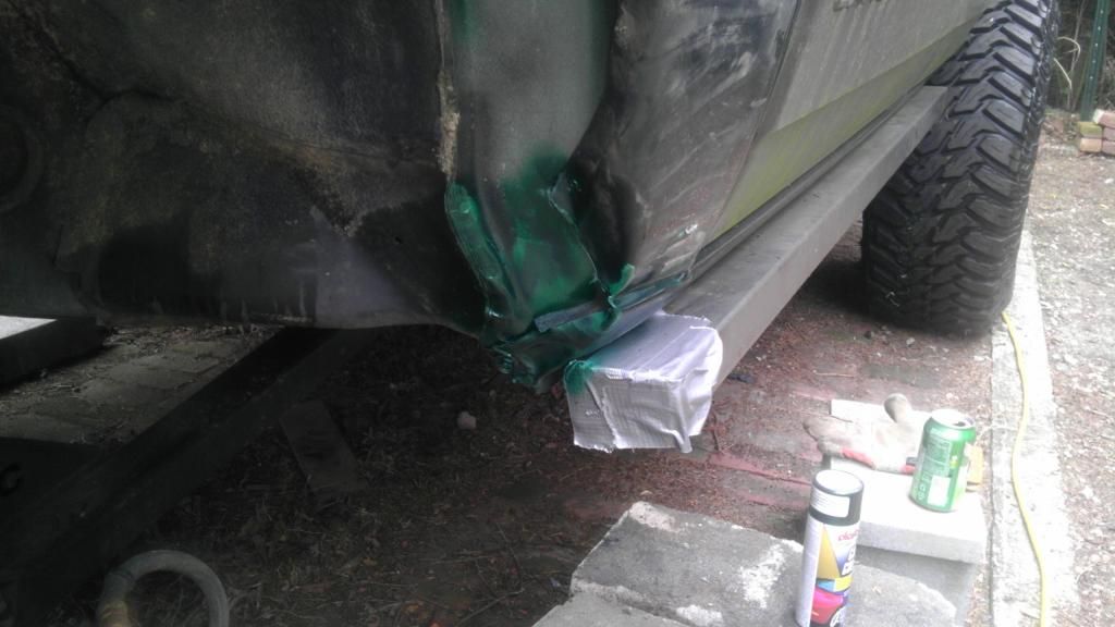

I had to cut back and re-weld my sliders.

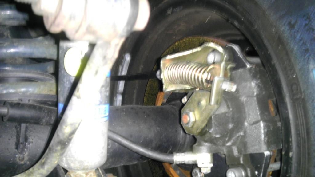

The jeep has been drivable I had brake issues soon after getting the jeep moving. I used rear calipers from an old caddy that had some sort of ratcheting caliper that requires an e-brake cable to put tension on the caliper, or something like that.
Member Olese was nice enough to share this link about adjusting the rear calipers. http://classicbroncos.com/reardiscs.shtml
So I bought E-brake cables for a '79 F150 and had a machinist shorten the inside cable to make it fit right, but the ends snapped right into the Jeep body and Caddy calipers.
After getting the E-brake in the brakes got a lot better. But I still have to pump once before they really work. I did bypass the ABS unit had have straight pipes from the Master Cylinder to the calipers.
