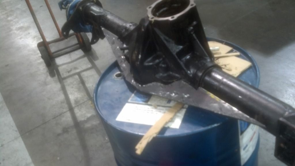

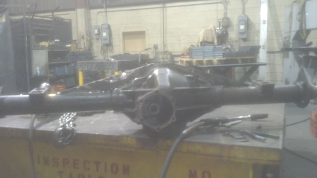

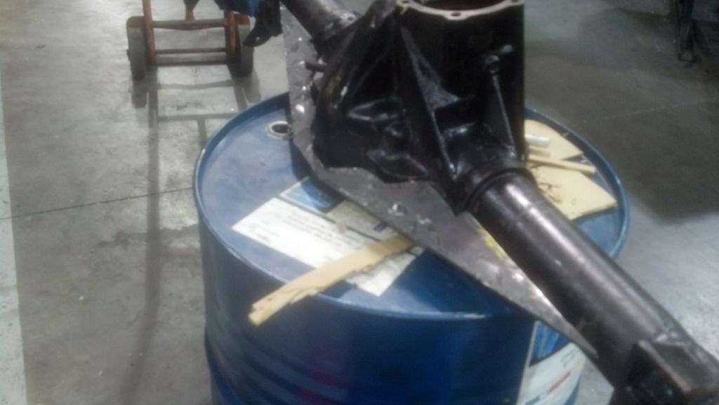

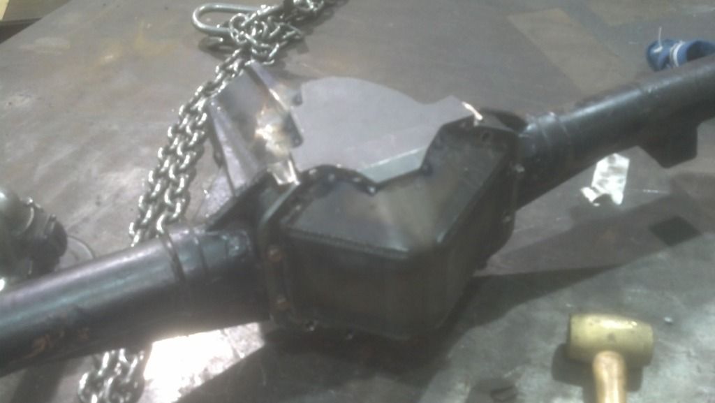

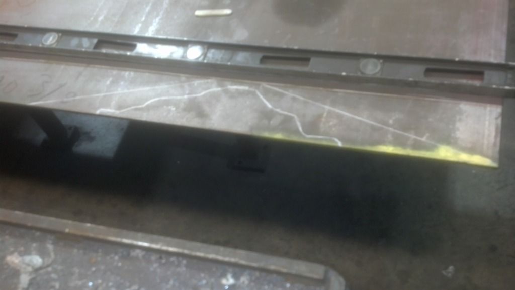

Did some work on the 14 bolt
-Cut out and tacked out part of truss
-tacked on shave cover
-had the ring gear turned down, don't have a picture of it yet though. Ill take some to show clearances.

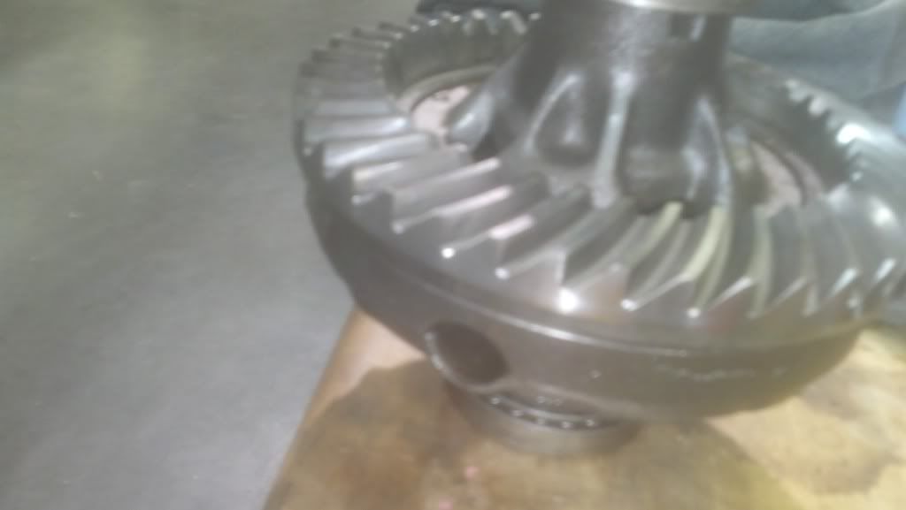

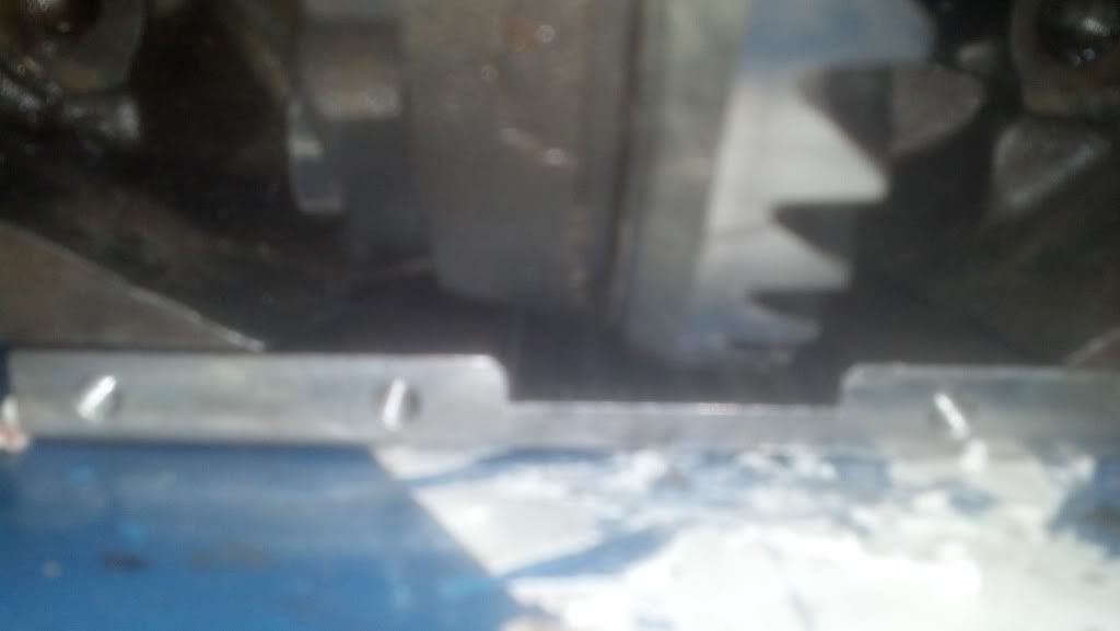

post #29 of 40 Old 11-09-2012, 10:14 PM Thread Starter
Jakes89Wrangler
Location: linden
Posts: 210

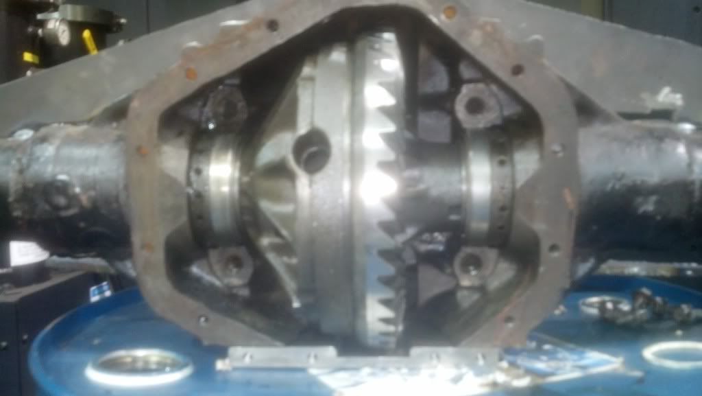

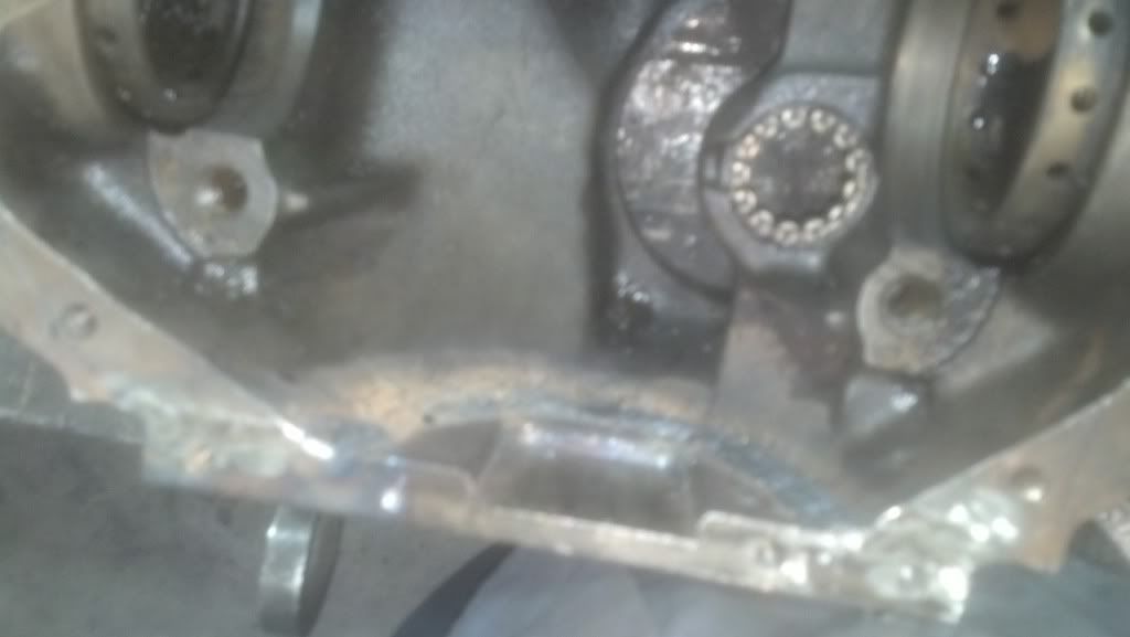

Shaved gears/ checking clearances in housing
Jakes89Wrangler is offline

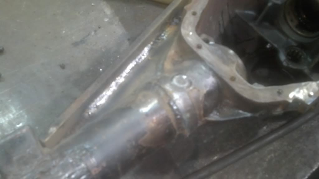

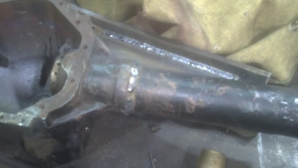

post #30 of 40 Old 11-16-2012, 10:31 PM Thread Starter
Jakes89Wrangler
Location: linden
Posts: 210

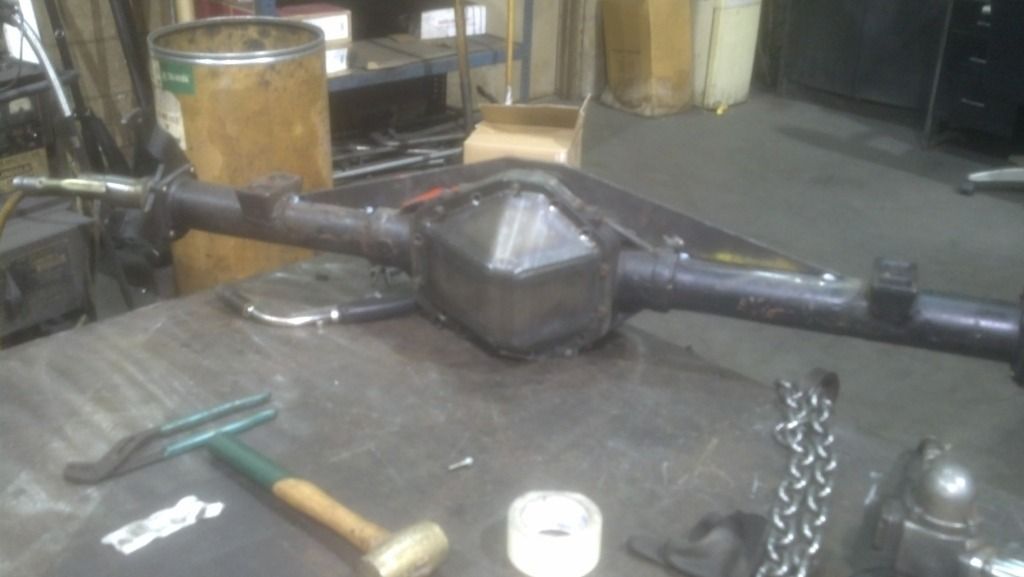

The truss is on and the plates are welded.
