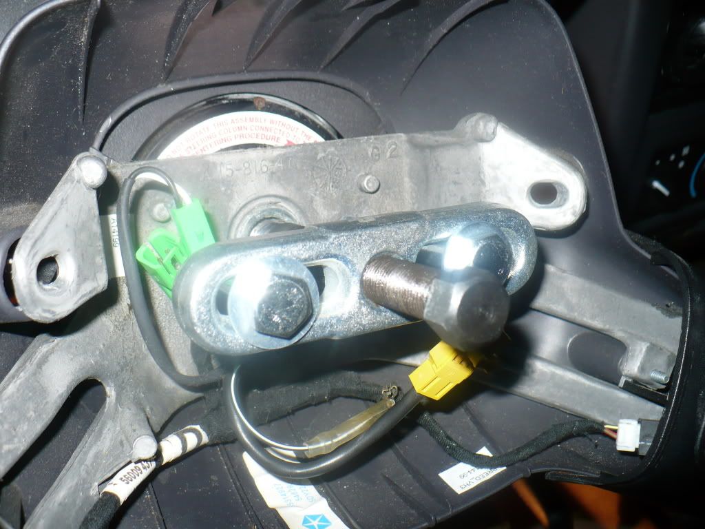

first i disconnected the battery cause i dont want an airbag blowing up in my face
all the surrounding covers removed

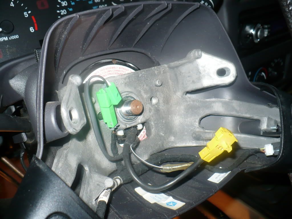

then take out the two screws on the backside of the steering wheel this allows the airbag to be tilted forwards. from there you can use a flat head and pull the airbag and green cruise control connections out. remove the plastic cover on the last wire and unplug it(this is the horn connection.
you can then use your steering wheel puller (13 bucks at advanced auto parts)
steering wheel removed

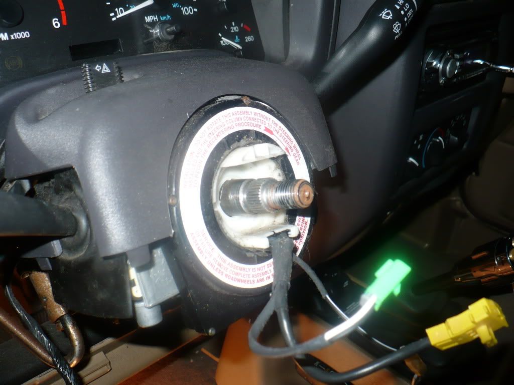

unplug the connections on the rear of the clockspring. then there are 2 clips holding the clockspring on one is on top and is slightly covered but still accessible and the other one is in plain view on the bottom. once those are removed the clockspring slided right off
from therefeed the connections through the steering wheel, plug the rear connections into the clockspring again and plug the airbag back in and the horn and cruise control back in bolt everything up and your done. alot easier than i thought it would be

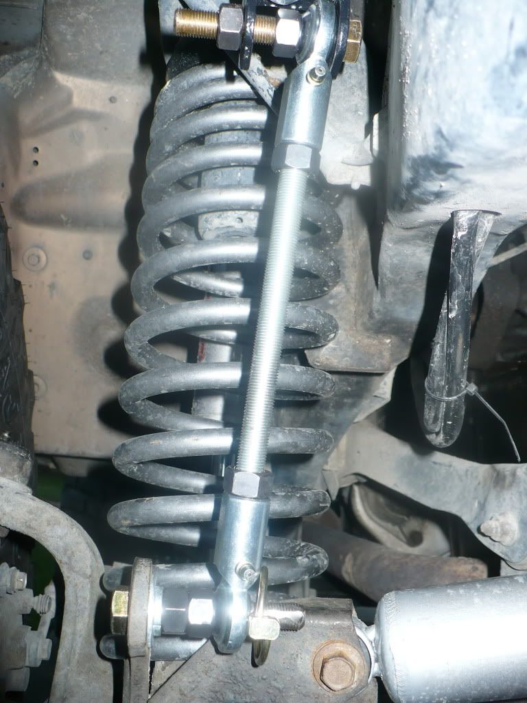

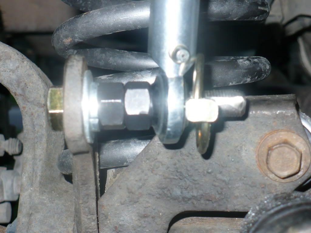

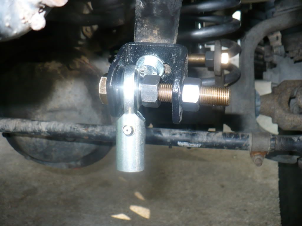

finished the quick disconnects

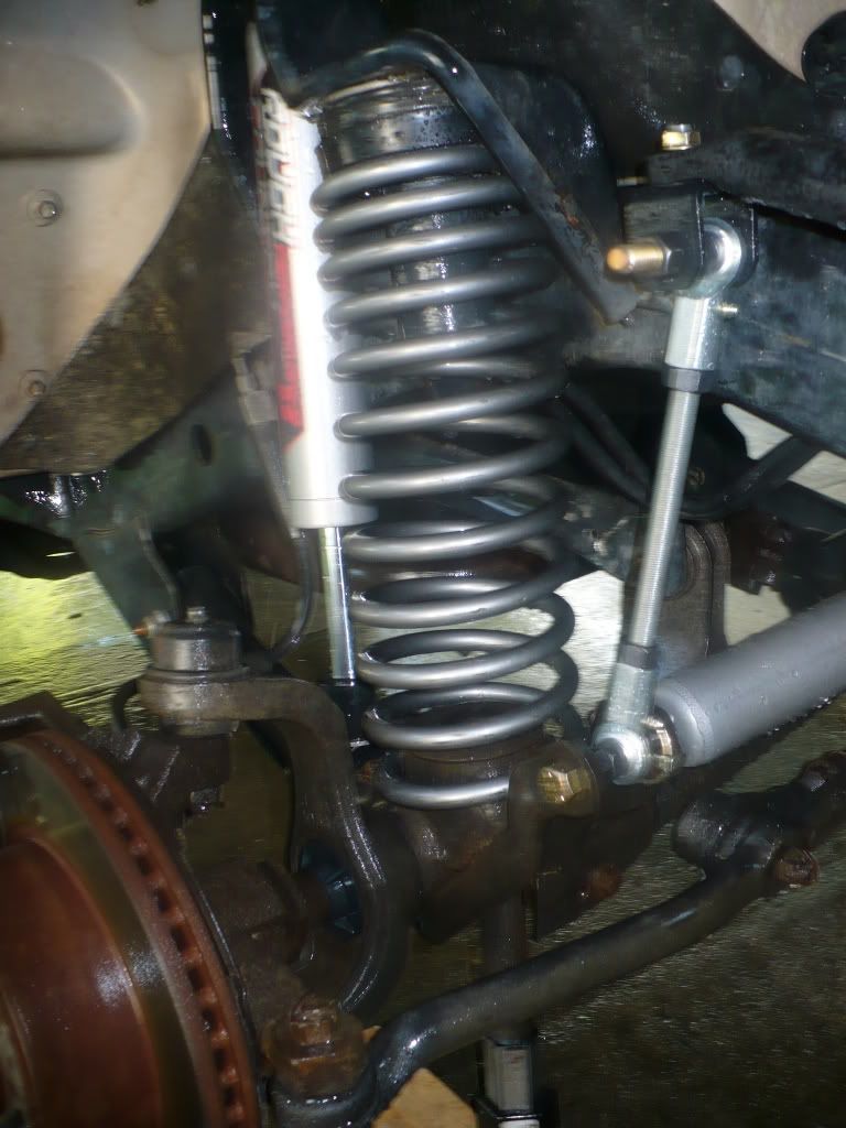

finished making this in about and hour and a half defineatly worth doing. im glad i didnt pay alot for jks ones or something.
here is the original idea, thank you scotch740 for the idea it was a great design and saved me some money
and here is how they turned out
the top went in very easy the rough country upper sway bar brackets work greatfor this
the lower links are just a bolt with a hole drilled in it for the lynch pin i tried to smooth the end out with a grinder but im not too skilled with using a grinder yet so they arentthat great
so nice quality discos for only 60 bucks are awesome. ive had no problems one side rattled a little so i just put a washer on the inside of it to make it fit snug.

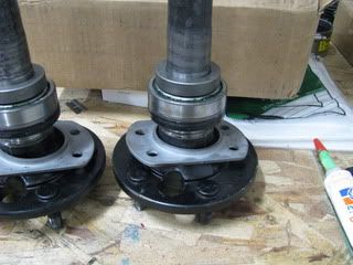

Got the Dana 44 this morning! it has 3.73s and a limited slip and drum brakes. in very good condition with the shorter drive shaft, brake line, and parking brake lines. paid $175 for it.

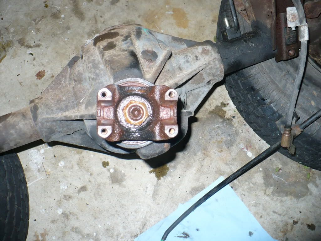

for now im just going to brake it down and clean it up and paint it. i removed the brake lines, the sway bar, and the drive shaft.

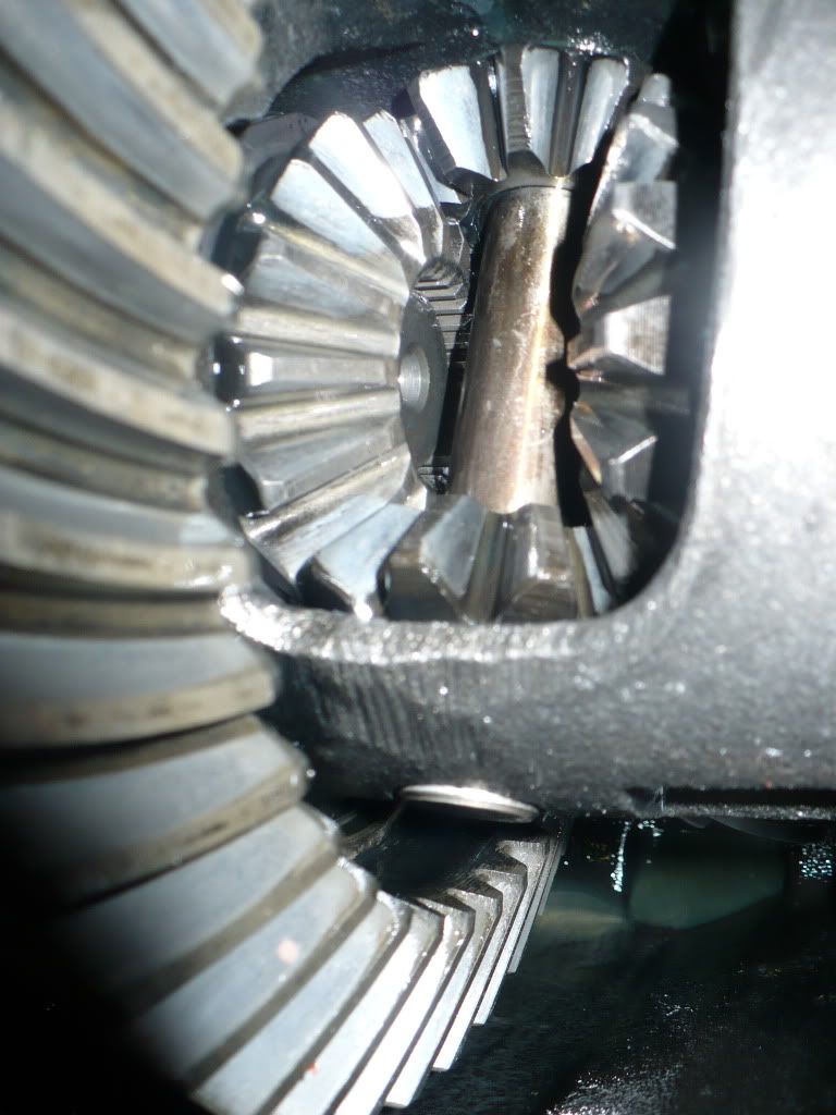

i opened the diff up to take a look and all the fluid was clean and had no debris in it at all the ring gear and carrier look very good.
and is the limited slip supposed to look alot like and open carrier? i dont know alot about limited slips so some insight would be helpful
not quiet sure what the future plans are for this axle, ideally i would like 4.88s and a OX or arb in it but that would require way more money than i have. unless i can find someone whos willing to teach me how to regear or someone who will regear for dirty cheap it it might end up staying at 3.73 and just not running in 4wd till i learn how to regear when i go to college.
i will have pictures later tonight just need to find my camera.
and advice or help is welcome

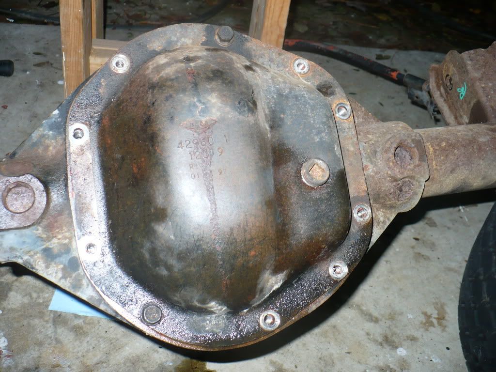

pics of the 44
The outside of the ring gear read 07 0399 DANA D 18515 P8L606 41 11 256
and the outside diff tag reads
52111032AA LS
3 73 606015-4
any help interpeting the tags will be helpful im pretty sure i have all the info i need i would just like to be sure the previous owner didnt regear or something

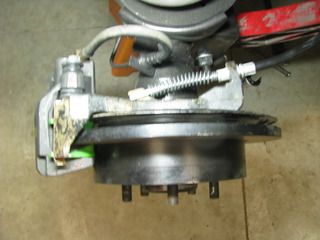

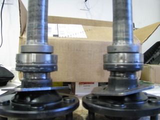

pulled the axle shafts and brakes off im going to do a disc brake conversion because i honestly dont understand them drum brakes yet. has anyone done the conversion and have a good write up?

Stu off road has a write up. You will need the retainer plates that have the flang on them when you do disc brakes.
You will need this type.
You have the flat ones now.
The basics you need are;
new backing plates
new calipers
rotors
parking brake pads and hardware
parking brake cables (hard to find)
are different parking brake cables needed i have the cables from the 44 and my 35 will niether of those work?
