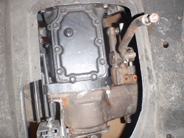

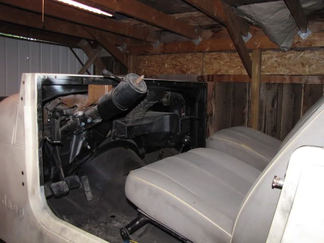

No transmission cover and a scabby hole for the shifter to poke through. I tore it apart before i thought to give it a try to see what it's like to shift. It sits pretty close to the drivers seat, I hope I just have to get an offset handle rather then trying to move anything else around.

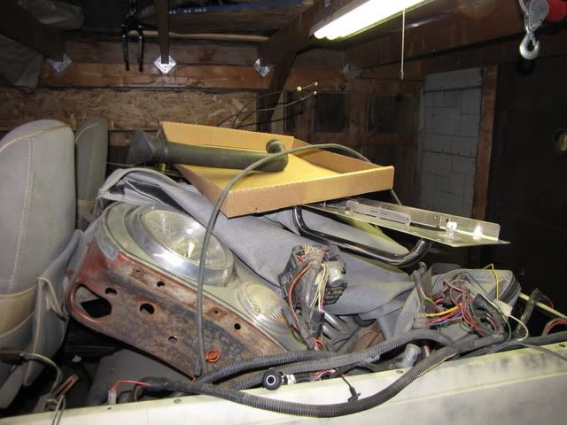

There was a rats nest of wiring through out the entire JEEP it took a while for me to straighten things up just to take them out.

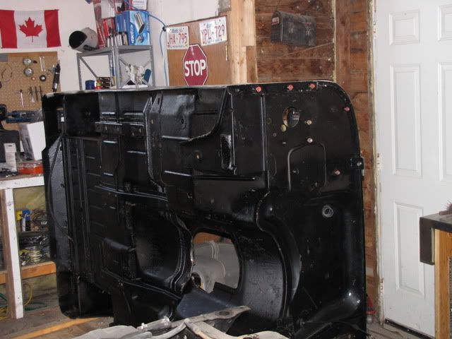

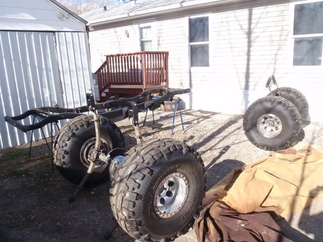

separated tub and frame
tub off

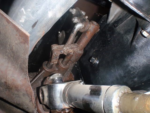

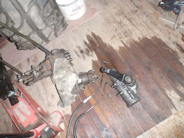

leaky power steering and T-case

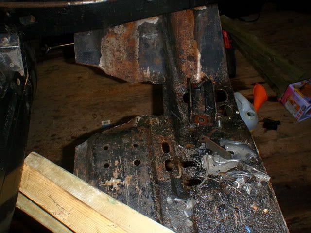

The skid plate with a huge piece missing right down the centre line of where the mount is bolted, there was very little support through it.

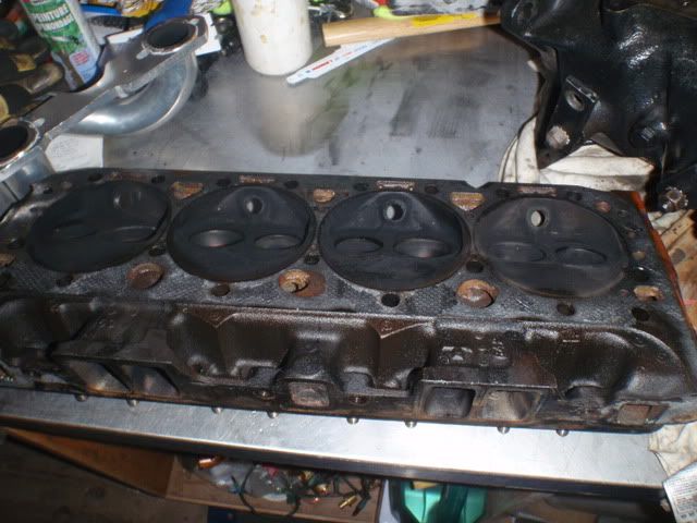

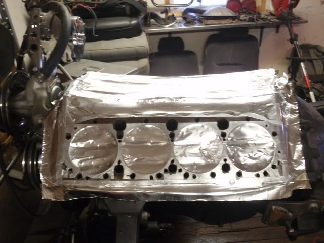

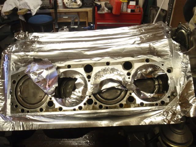

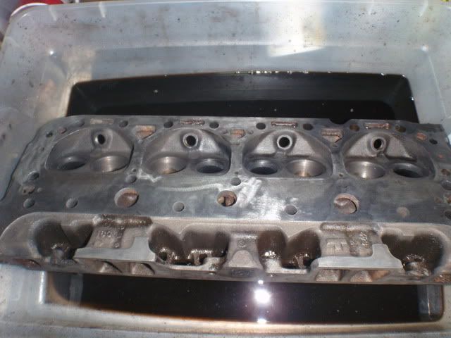

I had to redo the seals on the heads so while they were apart I gave them a good cleaning.
Dirty
CLEAN

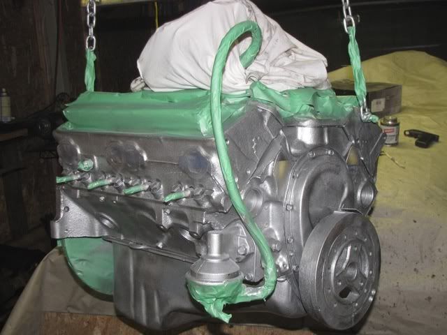

There was a really thick film of grime and sludge below the intake when I took the top end apart. So i'm scrubbing the entire engine inside and out, without taking too much apart. I used HVAC Tin tape to seal off all the holes that I didn't want water to get into and used my garden hose to get out a "POOP" load of sediment, and other stuff that was inside the water jackets and passages.

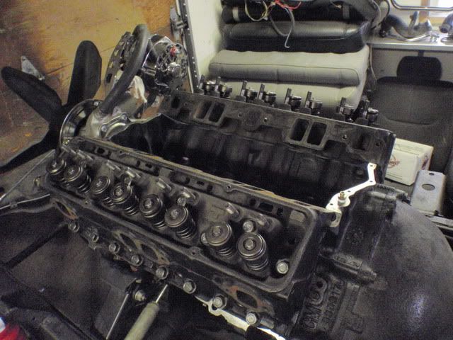

And after I was done and dried off I gave the crank a quarter turn and blew the tape and also my ears apart LOL.

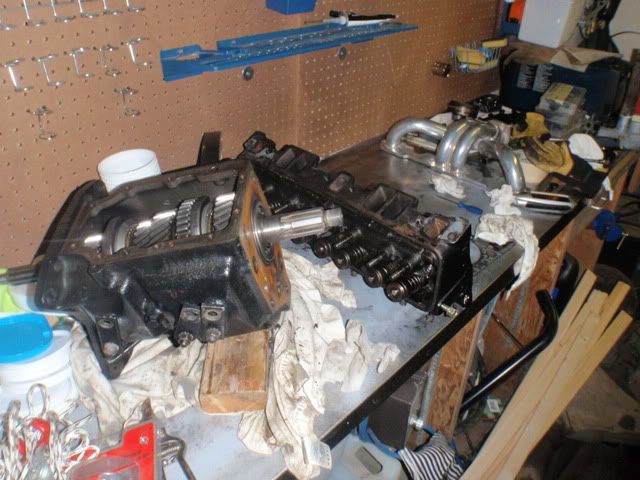

Valves, seals, and heads all back on.

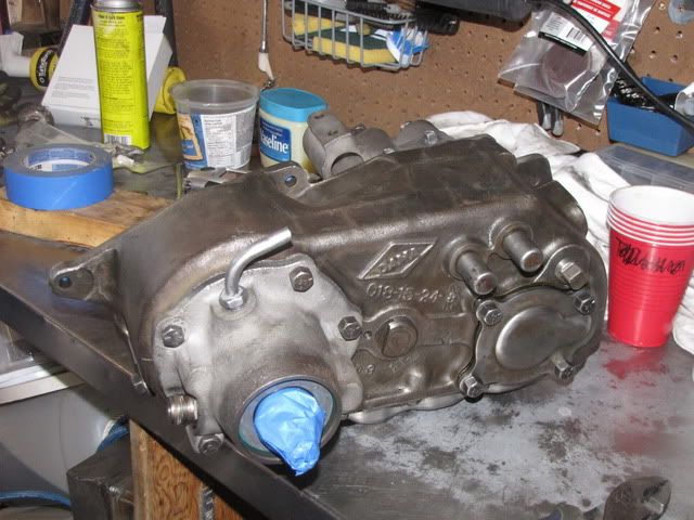

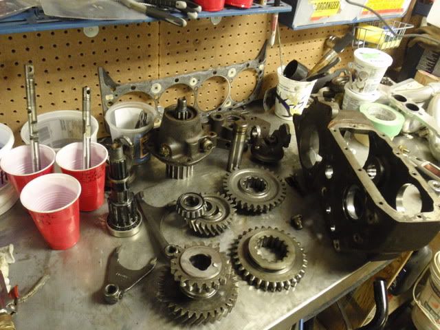

T-Case all apart. new seals going in.
Sealed up and ready for paint.

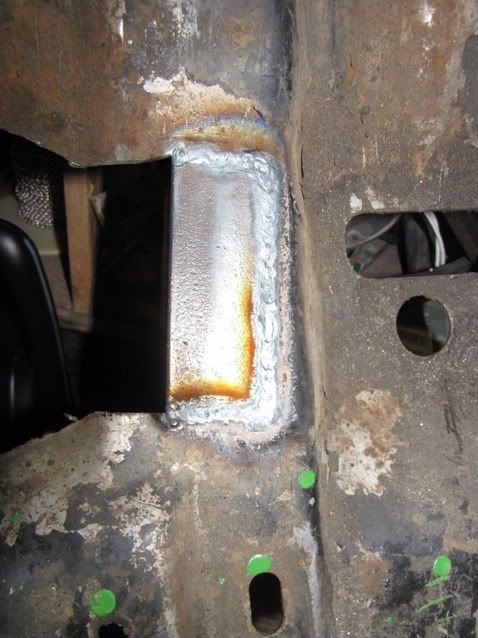

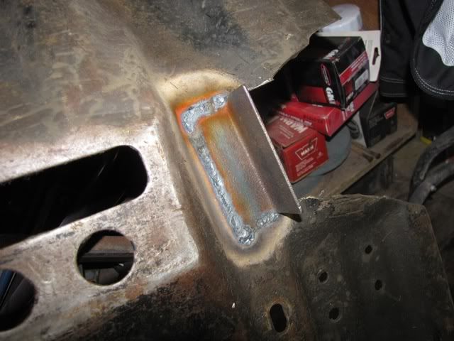

This is the temporary patch job I did on the skid plate that came with DEH COCKAROACH, but I swapped it with the other JEEP I have for now until I build my own later.

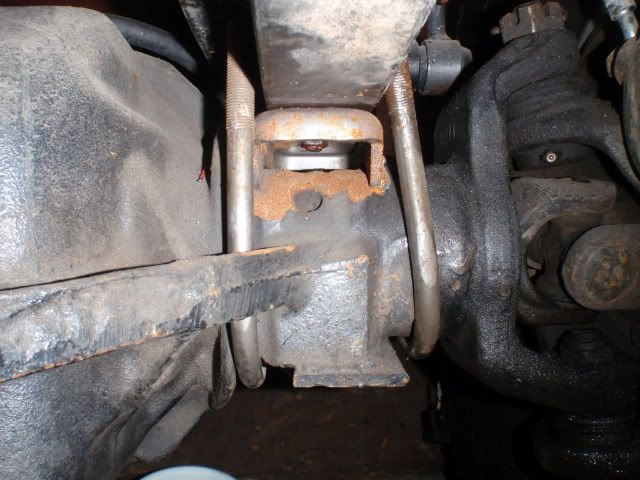

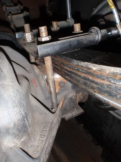

I noticed this a while ago but just got around to taking pictures of it. I have to get the pinion angle changed on the front D44 but the spring perch on the passenger side sits right on the housing and the outside U-Bolt doesn't sit very square. Is that ok sitting like that or should I grind more out of the diff to square it up, or would that take away too much strength? And there is also a hole drilled through one of the ribs on the diff, would that effect the strength that much as well? When I get the pinion angle changed I may have to oval out the hole in order to have the U-Bolt fit through again.

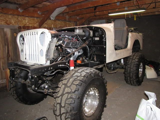

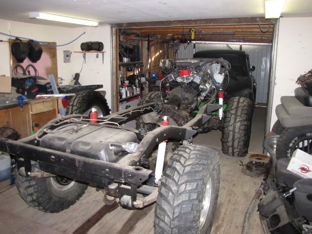

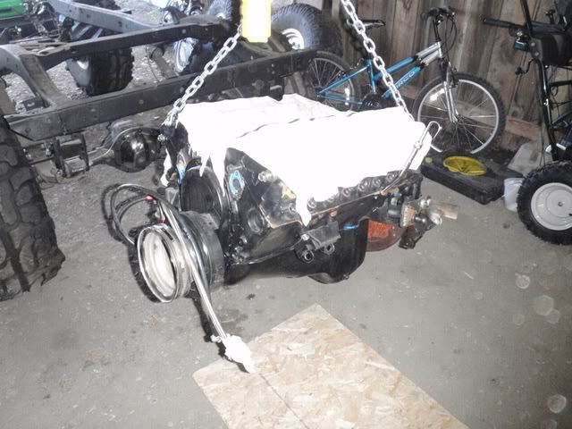

Engine out
Everything separated
Frame ready for cleaning and POR 15 on the inside.

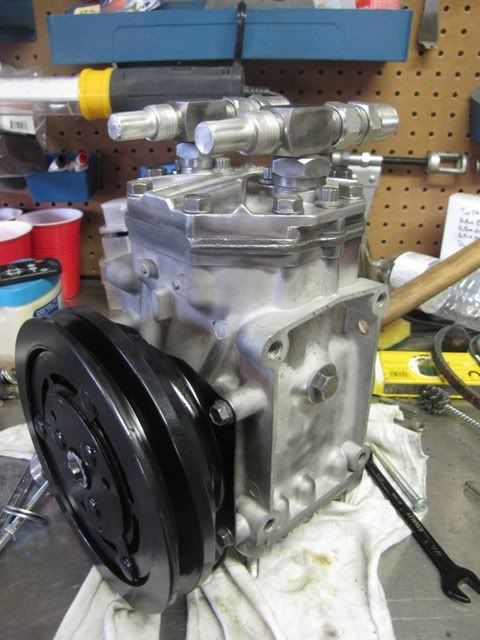

My new YORK, all cleaned up and resealed.

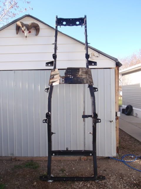

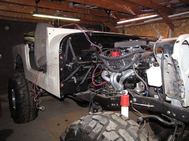

Frame painted.
Base coat on engine.
