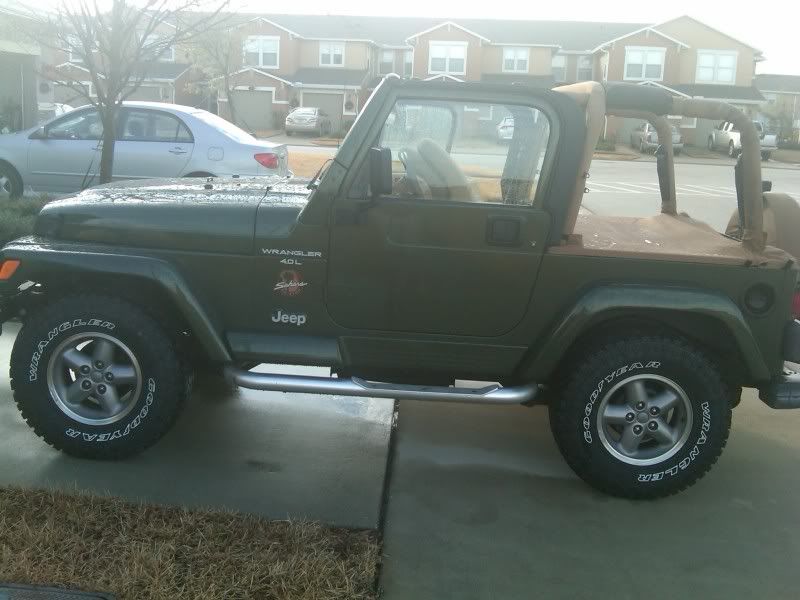

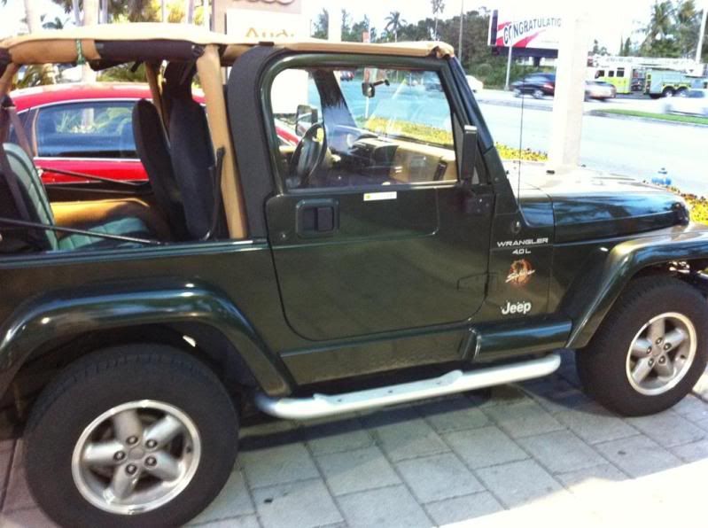

When I was younger, all I wanted was a Jeep. I was spoiled rotten with a brand new Explorer but hated it bc it wasnít a Jeep. For years I wanted a 96-98 moss green and spice Sahara. Finally got to the point where I could have a second vehicle so I went hunting for that specific Jeep. After about 6 months, came across a 98 with only 47k miles. Had to have it and ended up getting a solid deal on it at $7k. The Jeep had sat under a beach house for 13 years with nothing but a Safari top, so it needed a little cleaning.
Here it is as I bought it.
First thing that had to change was the tires. 31Ē Goodyear Duratracs.

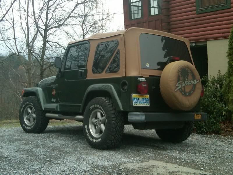

Next up was a new softop bc the one that was on it was the original top and it had been folded down on the Jeep for 13 years and had basically rotted. The Safari top on it was in bad shape too so I bought a bikini/duster combo, too. This pic is more recent than when it was done, but you can see in it I had the steps painted to match the wheels. Mistake #1 bc now I don't even want the steps.

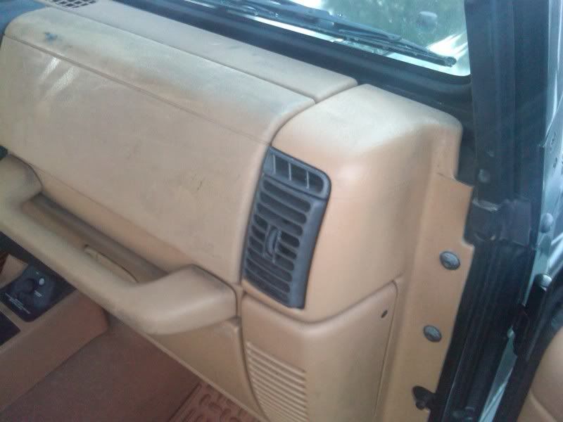

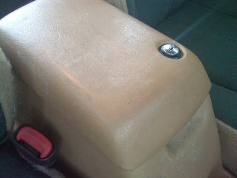

The front dash panel had a few spots that came painted from Jeep, not impregnated with the color. The paint on these sections, mainly the airbag, had basically melted a little over the years and become tacky and felt like someone had poured syrup on it. Here it is when I got it.
Just looked terrible. Had a local shop strip the dash, door panels, and center console down and redye back to factory spice. Came out even better than I had hoped. Wish I had better pics, but this will give you an idea.
