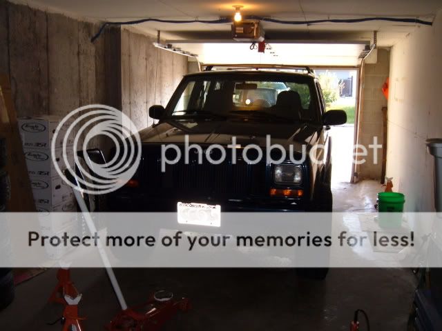

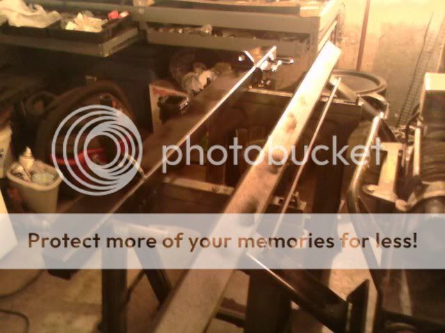

Still no baby yet, but I have gotten plenty of work done in the mean time. After getting a good coat of primer on the bumper and 4 coats of flat black I was able to have someone stop by and help me install it.
Sorry for the crappy cell phone picture. It went on in about 10 minutes. I was very thankful for that since I had spent many hours trying to get that stupid trailer hitch off.

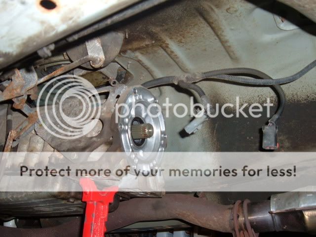

Instead of building out the NP242 with an H&T or TW SYE kit, I decided to do pull the old swicharoo on my two XJ's. The Dark Blue project will get the NP231 from my 99 Sport and vice versa.
Took me a total of 1.5 hours to pull this while working on my garage floor. I have some better wrenches now and I've figured out some of the tricks so I hope removing the 231 and putting this in will go much faster. I have already PB Blasted all the bolts on the cross member. It has also been off in the past year as well, same with the Trans mount.

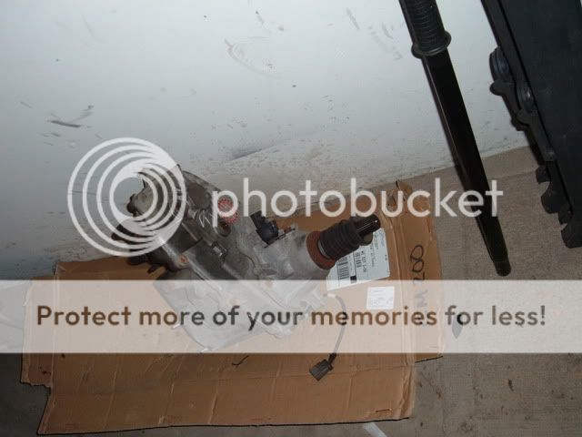

I've been a little bit busy lately. My wife gave birth to our first child on 10/1/10. Little baby girl. My Jeep time has taken a serious back seat for all of the right reasons.
I still have had time to finish one project and start another. My wife really loves the NP242 transfer case for winter driving. So I gave it to her and took her NP231 to swap into my trail rig.
She had the baby so it has just been sitting on the floor for awhile now. Hopefully it will be installed soon. Otherwise I have everything I need.

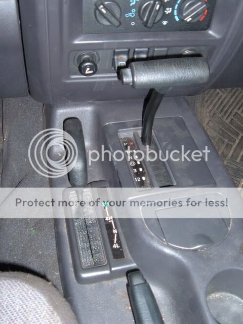

The nice thing about the 2000 and 2001 XJ T-Cases is they have wiring jumpers unlike the XJ of previous years where it is all hard wired. To get the NP242 dash lights to work in the 99 I am going to have to hot wire it. Otherwise it works just fine.
There is a 2000 XJ with a 231 at the bone yard by here so I am going to go try to snag that jumper harness. That way I can use the other one to hot wire the 99 dash lights.
I just got the interior put back together a few minutes ago, with the new shifter plate and selector.

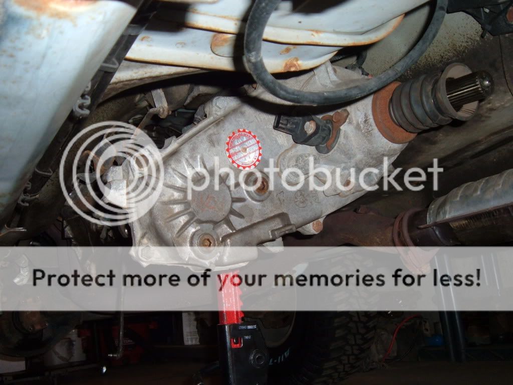

I was able to get some time this morning while the baby was sleeping to install the 231 case. My wife came down to work the floor jack while I lined up the input shaft and studs. I got everything bolted back together.
Same situation as before. A few vibrations.
I used a few washers on the cross member but the studs aren't long enough. I have some longer studs but am nervous about trying to remove the studs from the uni-frame. Need to buy another drop cross member (I used it in mounting the 242 to the 99), or purchase a SYE for this XJ. We shall see...

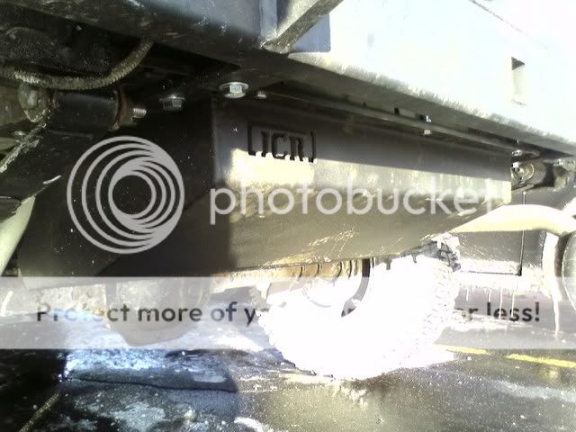

Well, I have made some progress on the build, just haven't wheeled much. With the new baby and all I have been having a hard time scrapping together enough time to get some work done.
Took it out once to do some light forest wheeling and shoot off some rounds with friends. Disconnected and quickly learned that I need to either add bump-stops or loose some fender. Tore one flare off doing that.
Shot the rock sliders and gas tank skid with some bed liner and was able to get those bolted on over the course of a couple nights.
