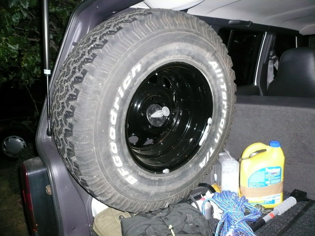

Anyone out there have any ideas on what to do with, or where to put the 31 inch spare tire? I couldn't afford a swingout, and putting it on the roof won't clear the garage.
Right now it is just laying down in the back. It won't fit in the stock spot.

It will fit in the stock location. I took off the metal bracket the spare used to sit on. I then took the stock plastic "wingnut" thing to Home De-pot and found a longer eye-bolt that matched the wing nut thread pattern. I used a d-ring to hold the new eye bolt to the stock location. Check it...

Interesting. I will have to try that. I was having trouble getting the gate to close with the tire standing up. Might have to remove the speaker from the back to get it to go up high enough to fit. I will report back. Thanks for the tip.

It looks really close in that picture, but after I messed with it a bit, I ended up with about 2" away from the speaker grill. Granted, my spare is not a brand new tire, but it isn't bald either.

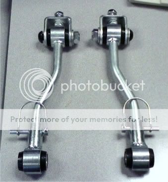

Are those Rusty's Sway Bar disconnects? If they are, I hate them so much I took them off. Clunked like no one's business. Too much slop where the pin goes through. Even tried to drill a smaller hole to take out some of the slop but they still clunked.
Oh, and they started to rust really quickly...
I will keep that in mind. They are a quick fix so I can take a road trip with it. We all make mistakes. I have made tons of them with my TJ.
