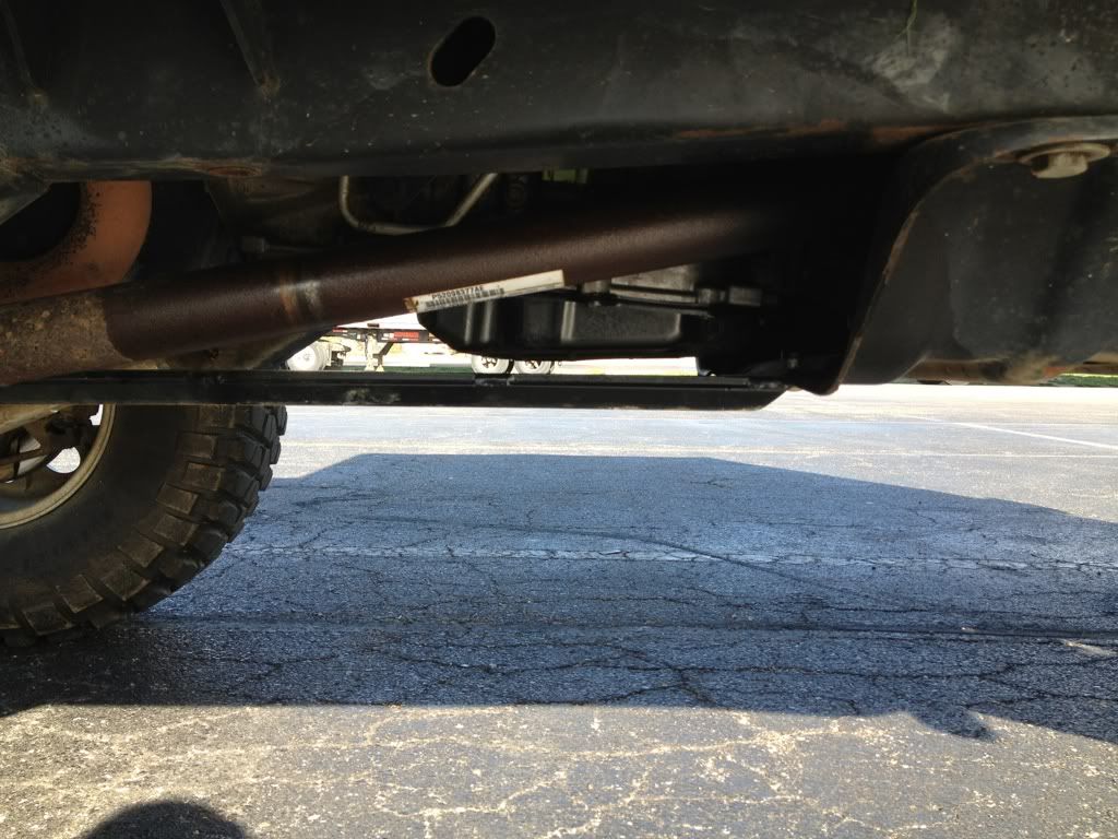

I can tell you this--there's no way I could move my drivetrain any lower than it already is. It would sit at the exact same height or maybe 1/4" higher with a well-designed crossmember. As it sits now, the bolt heads for the transmission mount bracket that thread into the transmission are recessed into notches on my t-case skid tranny mount bracket surface. If I switched to a xmember type setup, I don't think I'd be able to maintain enough clearance between the xmember and skid to avoid contact without raising it up a bit. Hope that gives you a little insight into how low you can get things to the skid with the LoPro. Stock for stock, I gained ~4.5" at the belly but only raised the t-case/transmission ~3".

Well sitting here waiting on the guy buying my old axle, I looked over the TC mount & making any effort to do more than the LoPro is wasted time. I only have about an inch between tranny pan & engine skid. At this point I wonder if I will even need to shim the LoPro.

Ah yes, the 42rle. That will define how low you can go down toward the skid....and thus, how high you can tuck.
