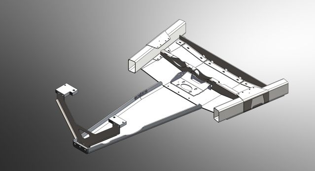

Originally Posted by Sundowner View Post
I thought it did have a support/brace in that position because that was part of how the engine skid attached; as Imped said, I thought it was fully braced...but that may only be the standard Under Armor and not the modular version.
Edit: Just looked at the photos again on Savvy's site and there are only two braces, so I stand corrected.
The way the full under armor engine skid attaches does help support the front of the skid. But the modular attaches like any normal engine skid.
Full under armor
Modular

post #992 of 1319 Old 11-05-2013, 06:42 AM
Imped
Imped's Avatar
Location: Indianapolis
Posts: 20,402
It's bent though..... that helps with support at the front. I ran the front edge head on into a boulder the other day at the badlands. Nothing more than a scuff.

post #993 of 1319 Old 11-05-2013, 06:55 AM
MO2500
Location: Denver
Posts: 7,191
This, the fact that the skid drops in the center and slopes up toward the mounting points on the frame adds a ton of support from bowing upwards. You can think of it as pressing on the point of a triangle vs pressing on the middle of a flat plate, the point of a triangle is much more rigid. Obviously the Savvy skid isn't angled as severely as a triangle but the concept of forces applied to the structure as a whole still applies. The bolts would have to shear at the frame before you get the skid to bow upward unlike a flat piece of plate with a minor amount of stretching.

post #994 of 1319 Old 11-05-2013, 07:07 AM Thread Starter
Danno6102
Join Date: Jun 2011
Posts: 1,572
I understand bending adds some rigidity, but that's not much of a bend, maybe 5, & still has some 13" of unsupported flat, dead center. Granted their crossmember does go full width, so that helps out a lot.

post #995 of 1319 Old 11-05-2013, 07:25 AM
Sundowner
Posts: 6,408

post #996 of 1319 Old 11-05-2013, 08:13 AM
Imped
Imped's Avatar
Posts: 20,402
Well, I'll certainly do my best to expose weaknesses in the skid but I just don't think it'll be an issue.

post #997 of 1319 Old 11-05-2013, 08:16 AM Thread Starter
Danno6102
Join Date: Jun 2011
Posts: 1,572
If you're still down for Saturday, we can certainly do our best to expose any weakness in the one on my rig.

post #998 of 1319 Old 11-05-2013, 08:55 AM
dayriesw
dayriesw's Avatar
1987 MJ Comanche
Location: Louisiana
Posts: 6,140
I believe MO2500 has the best understanding on skids as to people who have posted about this so far with the UCF skid being the best example. Danno, the angle you mounted to front of the skid will add a lot of reinforcement but is opposition-ally mounted to how the angle's strength works in the real world. It will work great for what you want, it just isnt the best way to use the angle's strength. Also, the flat spot on the skid is not the problem, it is the lack of x/y support and with it being flat, oviously there is no z axis support. Look at the ucf skid. The 3/4" drop down around the perimeter gives it the x and y support which will pretty much stop it from fully flexing out shape but the depth is where is matters most. The depth gives it the rigidity. And the cross member that they add (small C channel) is mounted with the open side facing downward which puts the "webs" of the C vertical tension which adds more strength (not a bunch when taking about the whole overall skid) and serves as a mounting point. If you give the skid properties that will allow it not to move, then it doesnt matter about the flat spots (as long as they are thick enough to not be penitrated).

post #1000 of 1319 Old 11-05-2013, 09:30 AM Thread Starter
Danno6102
Join Date: Jun 2011
Posts: 1,572
You skid will work great, but if you wanted flat and bulletproof something with a full square of angle just inside of the frame rails would be a ton more strong than lined with angles on the front, back and going across like in the second picture of post 980. In that skid, there is not enough front to back rigidity (or along the y axis).
Like sunny's sig says, if it is worth doing, it's worth over doing.
Just so we're on talking about MY skid, the one in post 980 is Mike's skid. My angle is mounted like this 'L', & to me, is exactly how the strength axis should be with a force pushing up from below. I do understand what your saying about the additional x/y reinforcement. I'm going to look into what can easily be done with relocating the cat to open up some space to do something more. As far as Y axis rigidity, I'll add an angle & weld it into both the rear bend & front angle. That will box everything in once I figure something out at the cat.

post #1001 of 1319 Old 11-05-2013, 09:37 AM
dayriesw
dayriesw's Avatar
1987 MJ Comanche
Location: Louisiana
Posts: 6,140

post #1003 of 1319 Old 11-05-2013, 09:51 AM Thread Starter
Danno6102
Join Date: Jun 2011
Posts: 1,572
I understand who's skids are who's.
Ok, was just making sure. So how are you saying my angle should be mounted to best use the angles strength?

post #1004 of 1319 Old 11-05-2013, 10:43 AM
JJeeper09
Location: Richmond
Posts: 2,190
L
JJeeper09 is offline
post #1005 of 1319 Old 11-05-2013, 10:46 AM Thread Starter
Danno6102
Join Date: Jun 2011
Posts: 1,572
Originally Posted by JJeeper09 View Post
L
& that's the way it's mounted.
