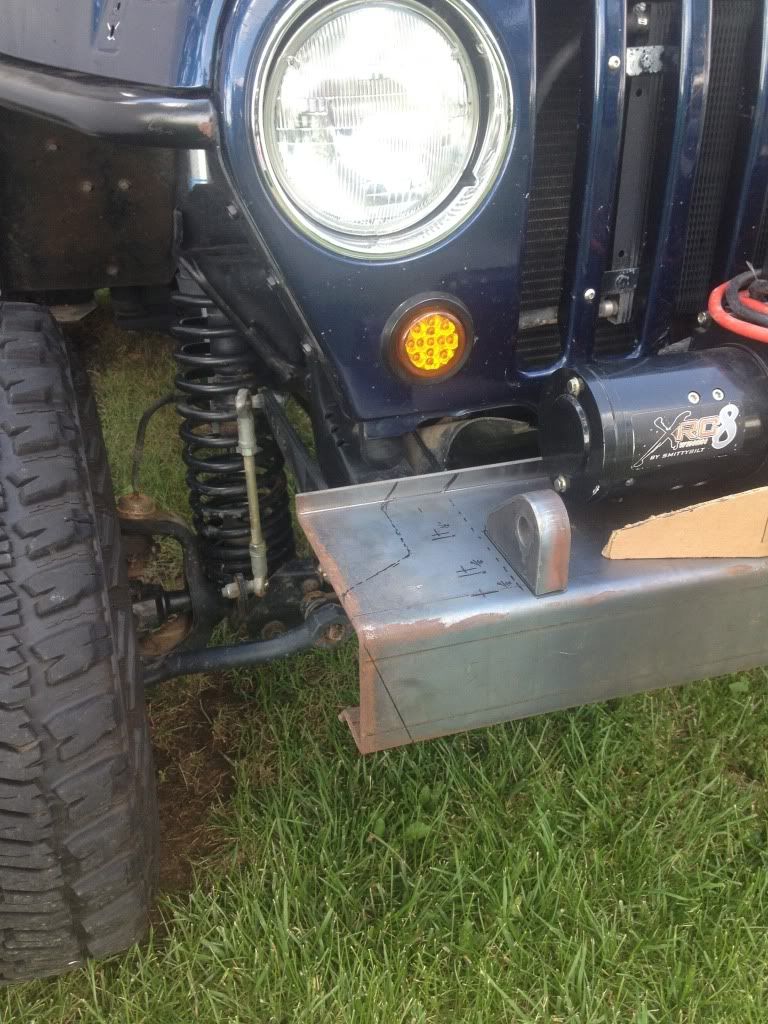

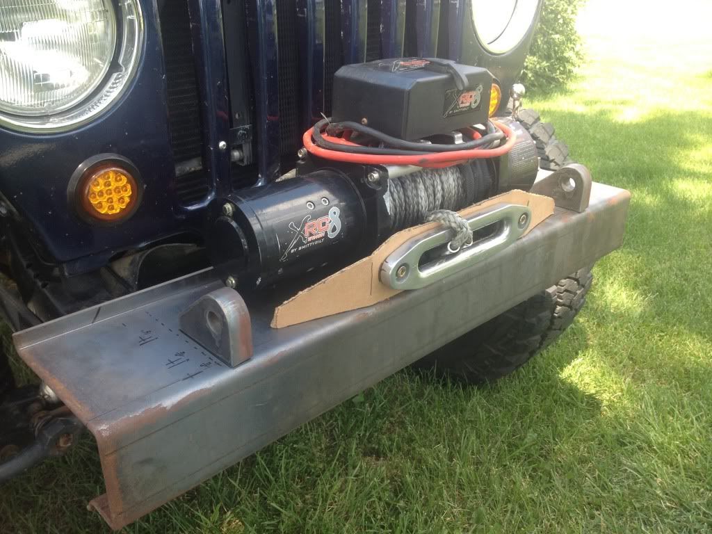

An update on the bumper. I've got the main bumper wrap piece bent & it fits over the frame rails great. I need to do minimal notching to get it on around the steering gear & my gear skid. All holes are marked. Waiting on them to burn me some new D ring mounts & fairlead plate so I can mock those up & then it's time to drill & burn everything in. Going to add a bull bar similar to the one Jay put on the Mallcrawler to protect the winch.

Here are some teaser shots. Still working on the end profile, but will be something like this. the D-ring mounts will be recessed through the bumper & burned in on both sides. The fairlead plate will "T" into the small bull bar winch guard on the sides to help give the plate more rigidity.

Diggin' the bumper!

I'd stick with that fairlead mount

Lol! It was a hell of a lot easier, quicker & cheaper to fab up & I bet if I use the good duct tape she'd hold.
