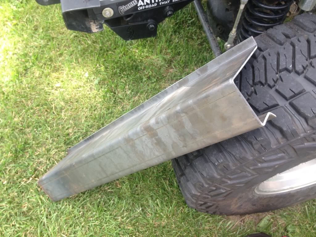

The beginnings of something beautiful... I hope.

Nice drip edge but it is a little beefy, right?
Lol! It's windy in Indiana want to make sure it stays put.
