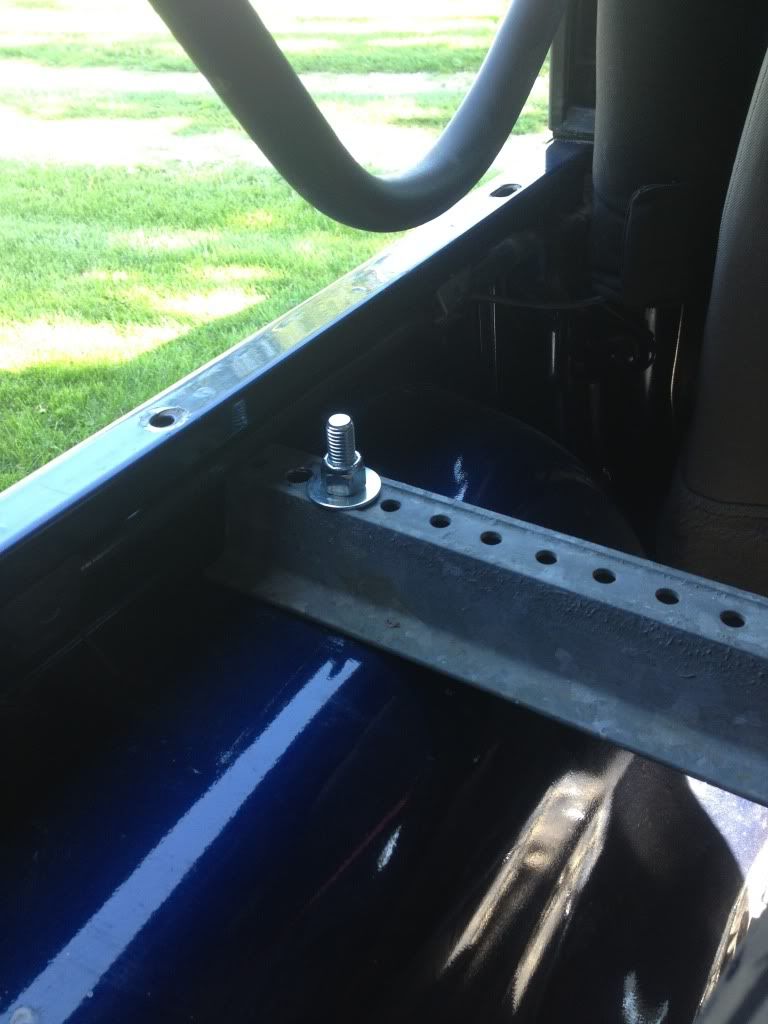

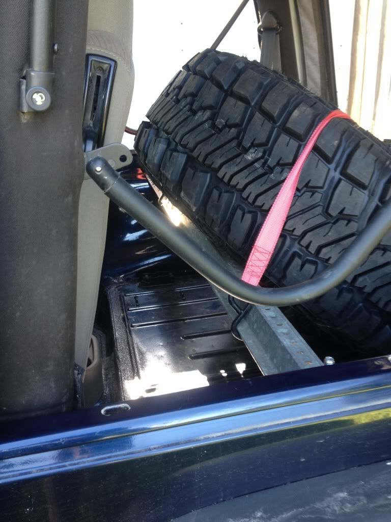

After I got home last night I put together what I am calling my "INDOT tire bar". I used a piece of a speed limit sign pole that fell down in front of my house a few years back. There is a hole in the top of each rear fender that is plugged with a grommet. I cut the sign pole to length. It has holes in inch increments which worked out perfectly. I drilled the necessary ones on each end out to 1/2" & bolted the pole to the top of the fender well & flopped the tire against it & strapped her down. I now have plenty of flat storage area for coolers, tool bag, etc. that is relatively easily accessible. If I have time I'm going to try to bolt down some small D rings for straps to hold everything down secure.

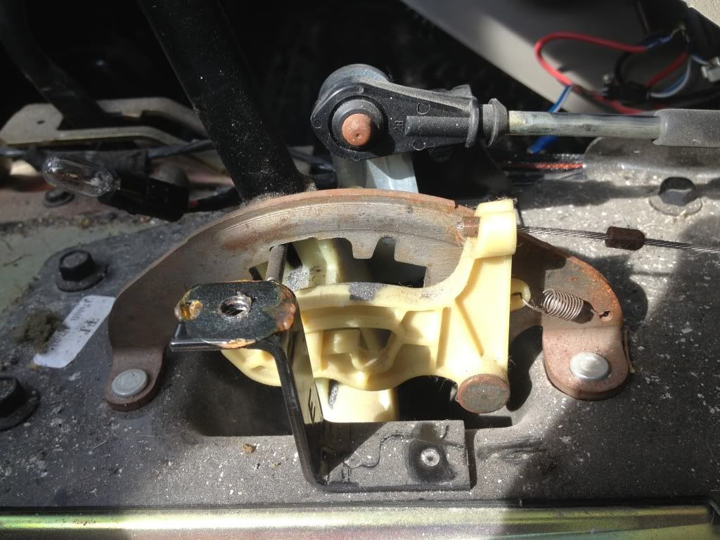

I ground down the shelf from N to R on my gear selector. This allows me a quick slap shift into R without having to depress the thumb lock on the handle.

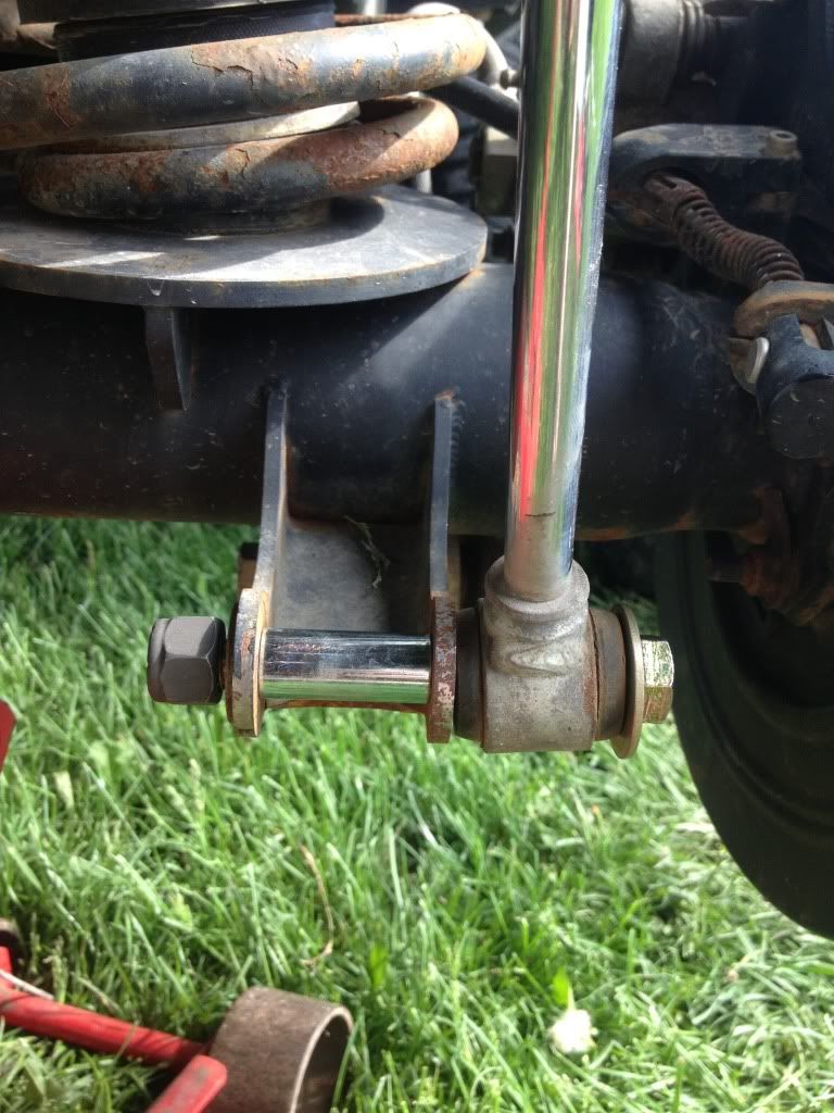

Quick temporary fix for my shock body interference with the frame on full flex. Moved the shock to the outside of the mount & used a longer grade 8 bolt with a crush sleeve stuck in between the old mount. Should hold me over nice until I can get some new mounts welded on.
