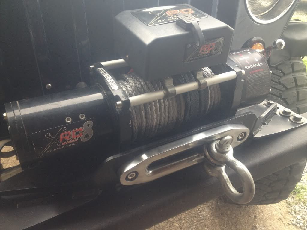

Got the new synthetic line & hawse fair lead on today. Had to cut the permanently fixed hook off so I could use my D ring.
Wobble woes: got the new joint halves installed in the melted side. Made one upper slightly longer to put them in a slight bind. Checked the joints in the track bar, they're fine. Holes seemed slightly oversized, but no signs of any movement at all. I torqued the track bar & lower arm bolts down with a 2' cheater bar, so everything is ridiculously tight. Checked ball joints & unit bearings. Ball joints seemed fine. Had a little play in the driver front unit bearing. Will order two new timkens & get them replaced.
End result: front end was much tighter. Mainly from the new joint halves & the binding, but the wobble is still present. Minor, but still noticeable. Replacement of the unit bearings & an alignment check are next.

What type of synthetic line and where did you buy it?
boilerup1998 is offline
post #790 of 1319 Old 05-04-2013, 04:11 PM
gspup
Location: Demfer
Posts: 2,707
I did the same thing on my synthetic line...I wonder why the hook is standard. Either way...synthetic line is awesome, solid purchase.
Looks like smitty...cheapest I could find when shopping around. Its held up great for me.

Yep, it's a smitty. Looked at the higher priced lines, but couldn't justify them in my mind. Like most things I buy, I got it on amazon. $200 for the line, $25 for the hawse fair lead & free two day shipping.
100' of 3/8"? Any worry about the winch plate rubbing the line as it exits the back fairlead during "in" pulling? Seems like that could be a sharp, square edge right there.
The hole in the winch plate is bigger than the hole in the fairlead, so there really isn't any interference. Only place I could see any is when the line is all the way to one side of the drum & that would be minimal with very little pressure.
