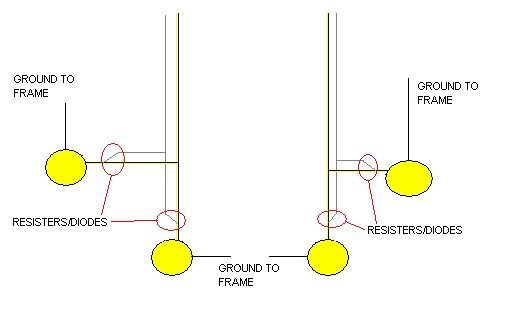

So I understand how to do the 2 wire to 3 wire conversion for the front markers/turn signals I am putting in the grill. That seems farily simple. My real question pertains to how I need to wire the 2 wire LED lights I'm getting from Genright for my side markers that I am mounting in the fender well. Do I just hook up the existing wires from the old side marker, to the new light & call it a day? Or do I have to run them a certain way or install resisters/diodes with these too?

Yes you will need resistors and diodes if you want them to function as turn signals. I initially installed them with the ground and constant wires so they act as marker lights only, but never got around to building my 2 to 3 circuit board.

Ok, so I basically do the exact same mod to the side markers & then ground it off to the frame?
Here's is a fancy MS Paint sketch to help. I like pictures. Is this what I need to do. Every LED gets grounded to the frame?

Yes you can route them that way, but you can also just run one resistor / diode per side and splice the wires for the fender and grill lights together so they run off the same resistor / diode.
