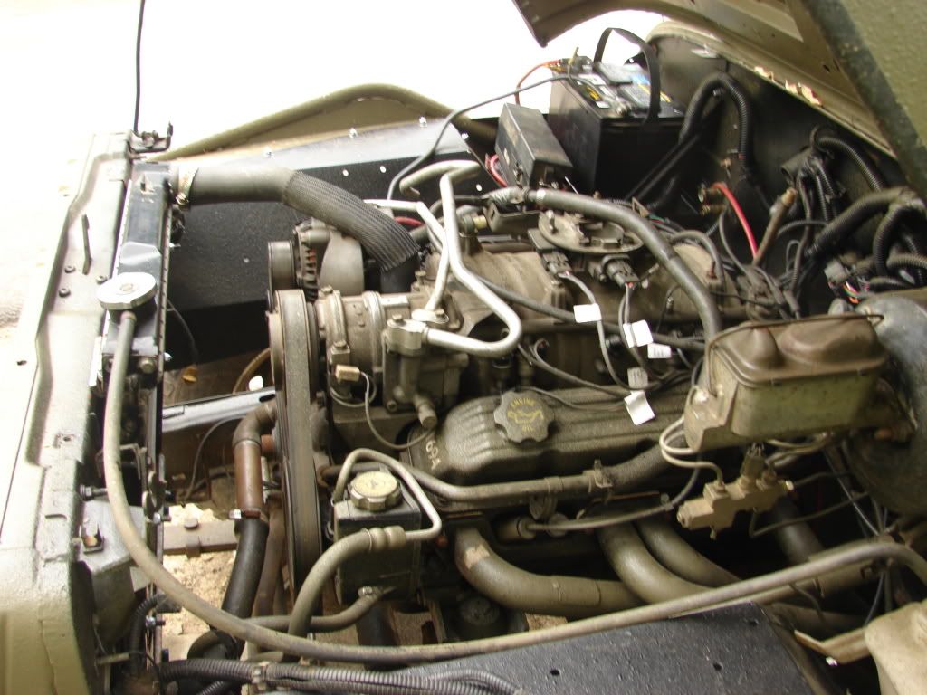

Judging from the gap at the firewall, the engine appears to be pretty far forward. Have you already made sure that there is adequate room left for the radiator and electric fan?
My YJ/CJ V8 Magnum Build: http://jeepforum.com/forum/f22/magnum-force-mopar-mans-build-1412306/
Copperhead89 is offline
post #44 of 187 Old 11-21-2013, 05:38 AM
mike_breaker_5
Location: emporium,
Posts: 3,010
my 5.2 is probably a little further forward . i can get to the upper bell housing bolts with a ratchet from under the hood.
the one thing i had to do was flip the stock rad mount backwards and modify it slightly. my radiator is now tucked against the grill.
i put in an electric fan and i have plenty of room b/n the fan and serpentine.
let me see if i can find a pic.

post #45 of 187 Old 11-21-2013, 05:46 AM
mike_breaker_5
Location: emporium,
Posts: 3,010
i think by doing this it saved me about 1.5"-2" of room. i really don't remember what the stock setup looks like, so i can't tell you for sure.the above pic doesn't have the fan installed yet, but it fit with gobs of room.
