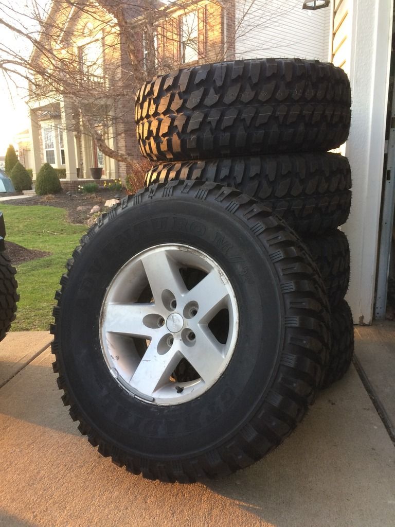

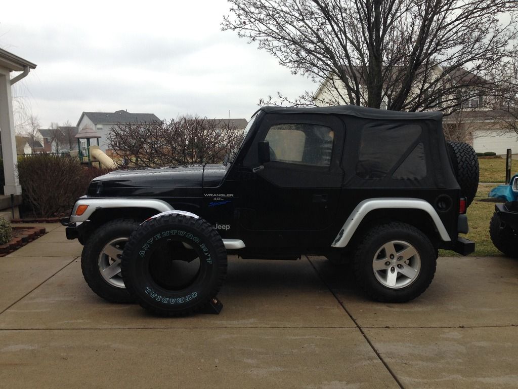

Tires and lift are at the house! Ill be going home from school this weekend to install everything. You can also see the Moabs I'll be using.
Pictures:

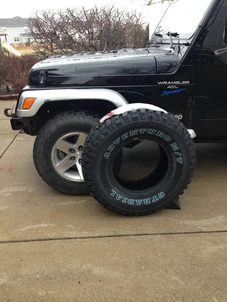

So there are the tires. I have a couple ideas that I wanted to get everyones opinion on. The first is painting the Moabs gunmetal color. I feel like the gunmetal with the black jeep will look good, what do you guys think?
My other idea is to trim my flares and repaint them black. I want to trim them because they are pretty tore up and have cracks.
This is how i was planning to do it:
Let me know what you guys think! I cant wait to get through this week and get home to install it all!

trimming the fenders like that will look good. My thought on painting wheels however, is to do it "right" otherwise it will wind up looking poorly done. Color is a matter of preference. My preference would be to leave them alone. However, if your set on black wheels, preparation of the original surface will be crucial to the final outcome and you being happy with what you have in the end.

Thanks for your input, I'm actually wanting to paint the wheels gunmetal grey, not black. I do however want to repaint the fenders black. I was thinking about gunmetal wheels because the wheels are pretty scratched up already and I want to be different. I thought it would look good, sort of similar to AEV wheels.

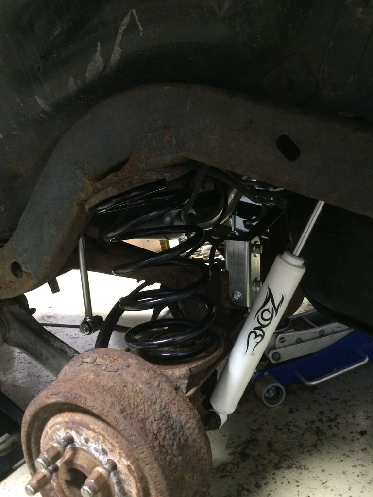

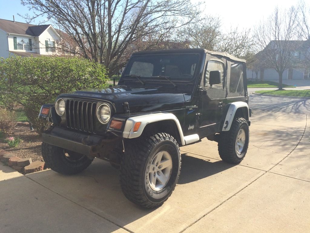

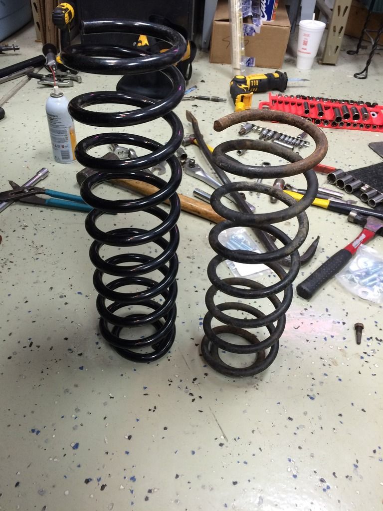

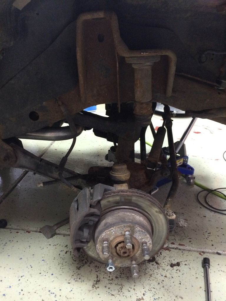

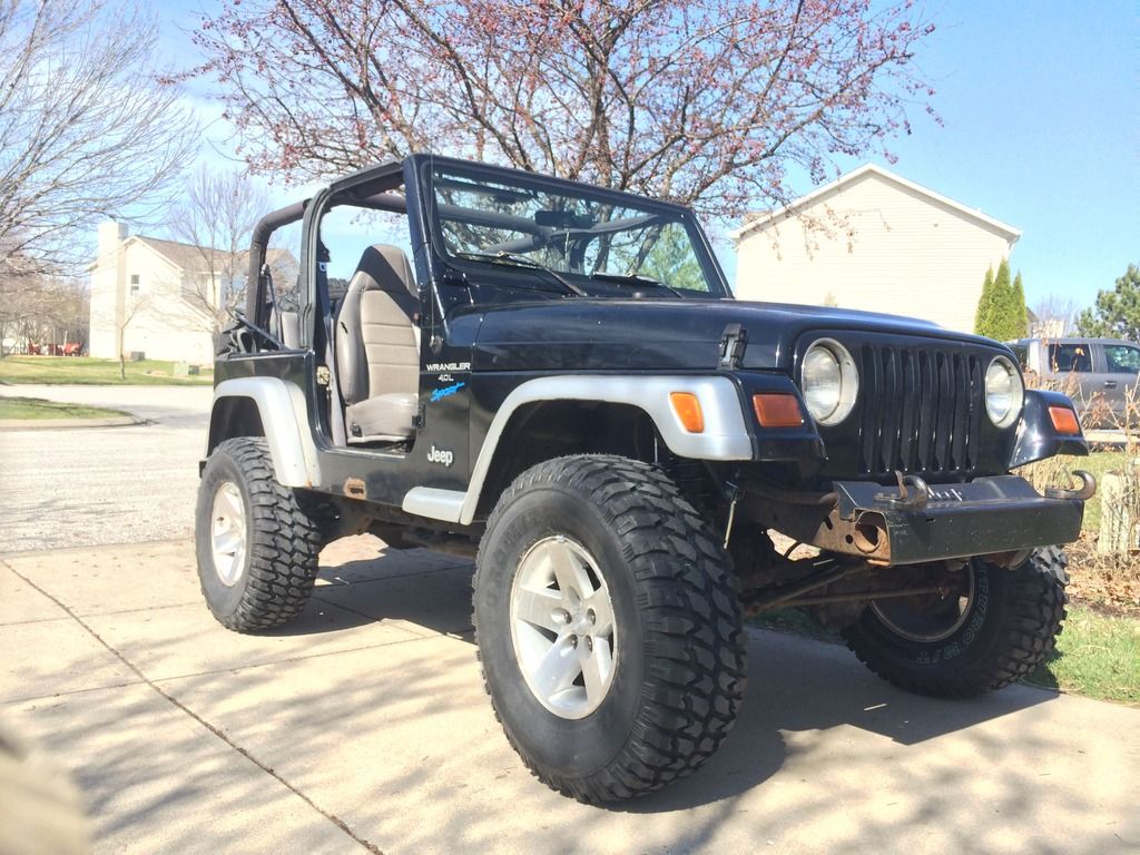

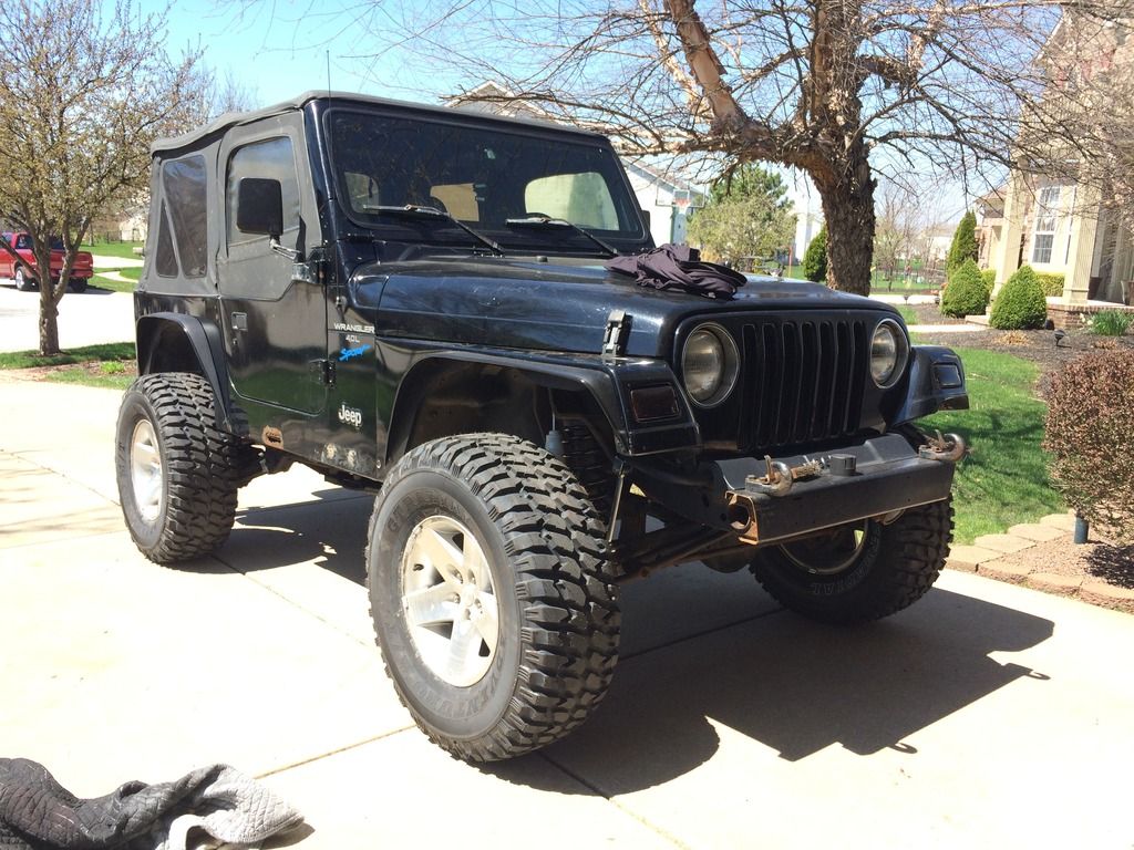

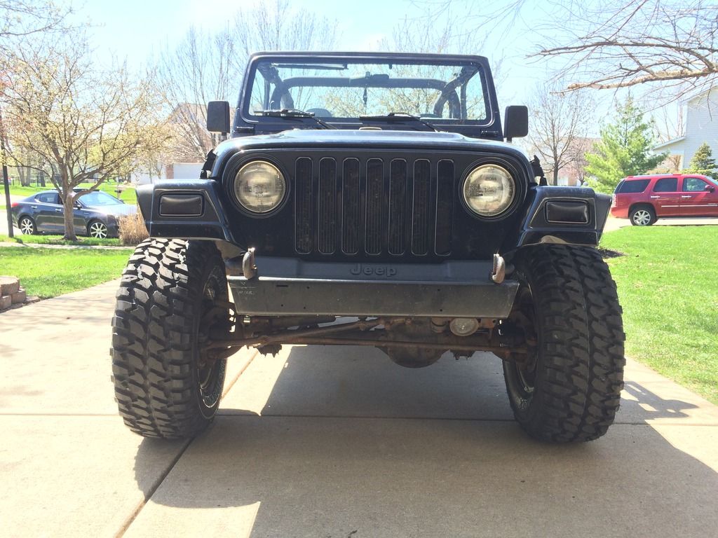

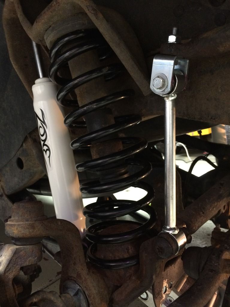

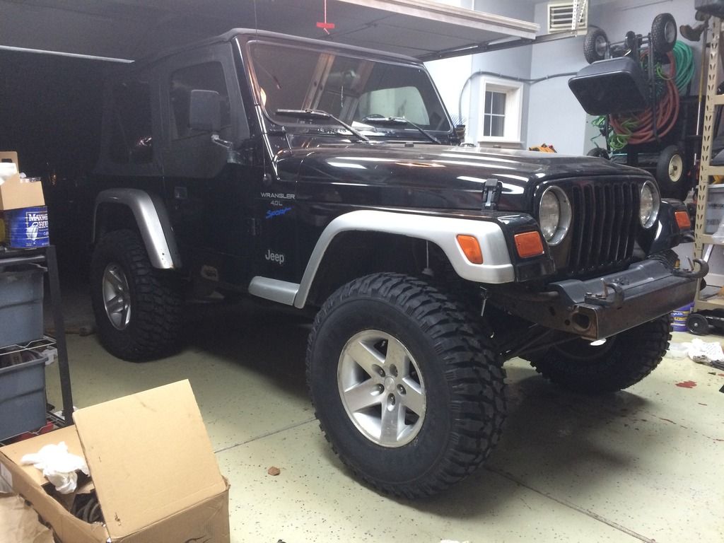

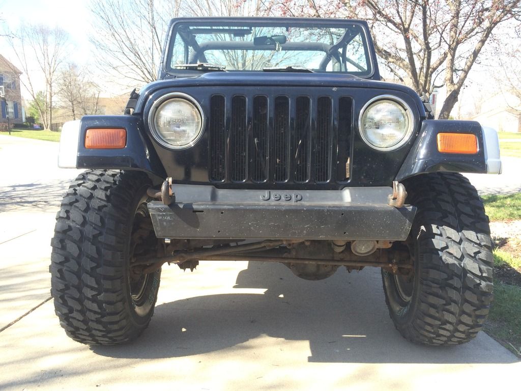

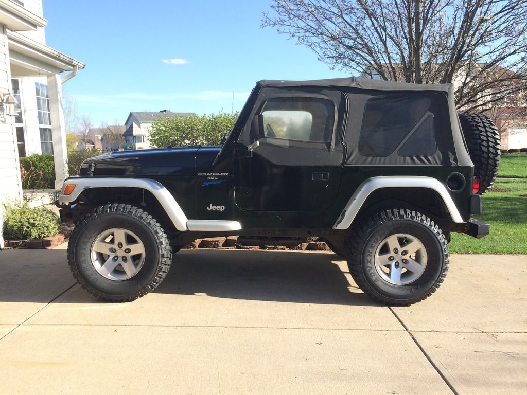

UPDATE: Got the lift and tires installed this weekend!! Super happy with the results overall. Had a few setbacks but finally got it all buttoned up. Had the front track bar bolt break and also had three of the 4 rear upper shock bolts snap despite being soaked in PB blaster multiple times the night before. Tried to take some pictures of the process.
305/70/16 on Moabs:

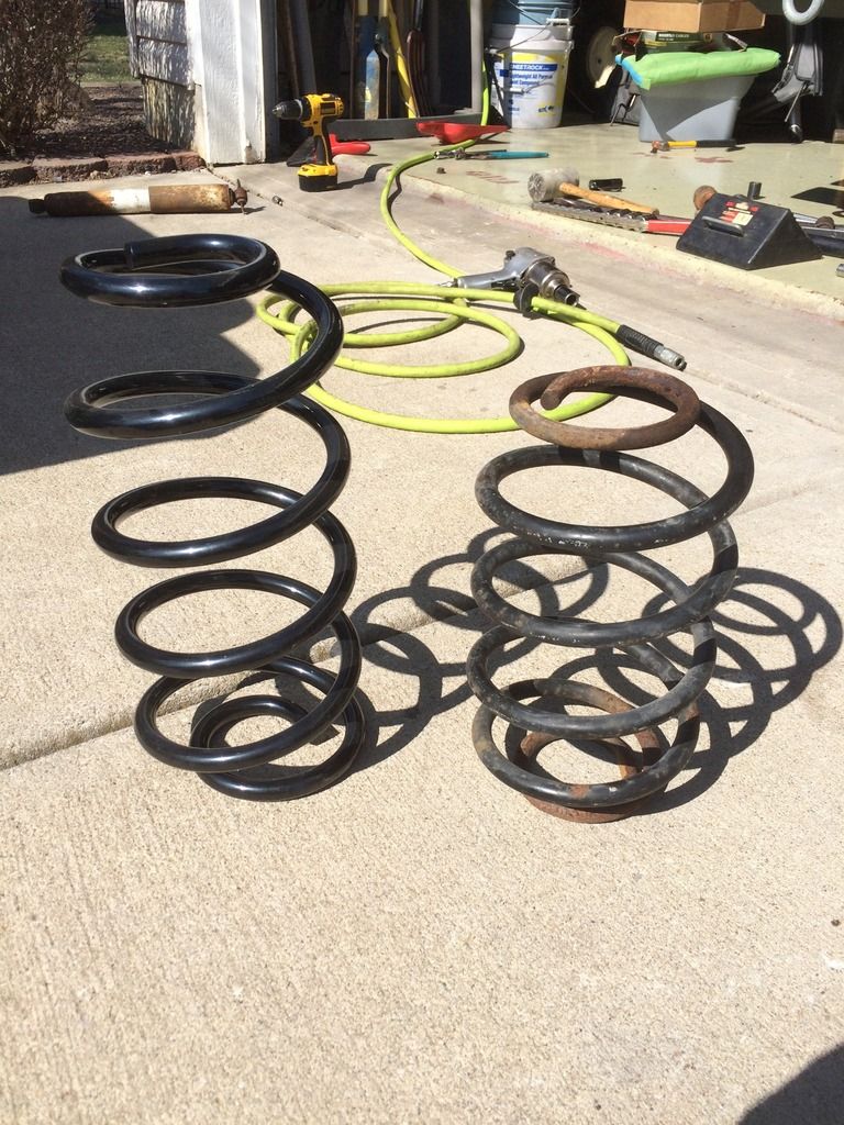

Comparison of new 3" Zone Springs compared to old:
Some various pictures I tried to take along the way:
Front:
Rear:
Finished around 6:45am Easter morning!

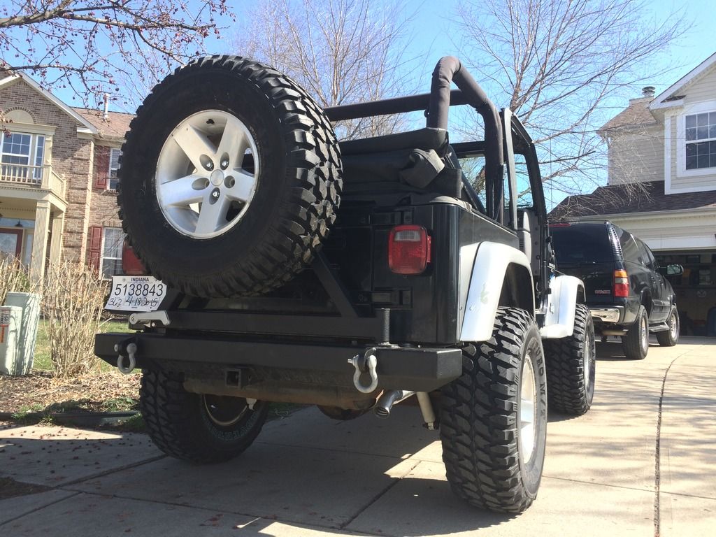

Also got a new rear bumper with tire carrier:
Also decided to chop the front bumper due to it being bent on one side:
Overall I think the jeep rides very well with the lift. Probably better than stock. Definitely needs an alignment. Im also going to have to get spacers for the wheels. At full turn, the tires hit the front lower lca, also the rear tires are maybe an inch from the upper spring perch. So no offroading until i get those ordered and in. After I get those, I'll get to work on fixing that stupid passenger side rust

Like I said in my last post, we broke three rear upper shock bolts. After breaking many good drill bits trying to drill them out, we decided to weld new bolts up to the old ones the secure the shock with nuts and washers. Being beginner welders one of the bolts broke off within about an hour of driving. So the plan is to reweld it up there and try to do a better job burning it in all around it. If anyone has any better recommendations, I'd love to hear them.

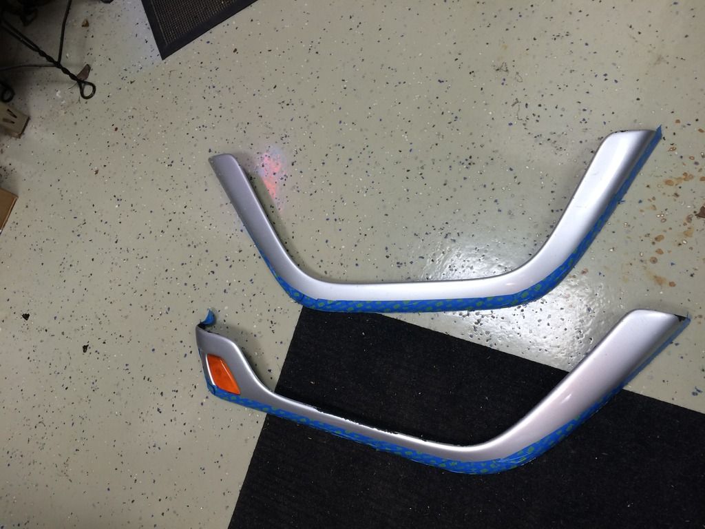

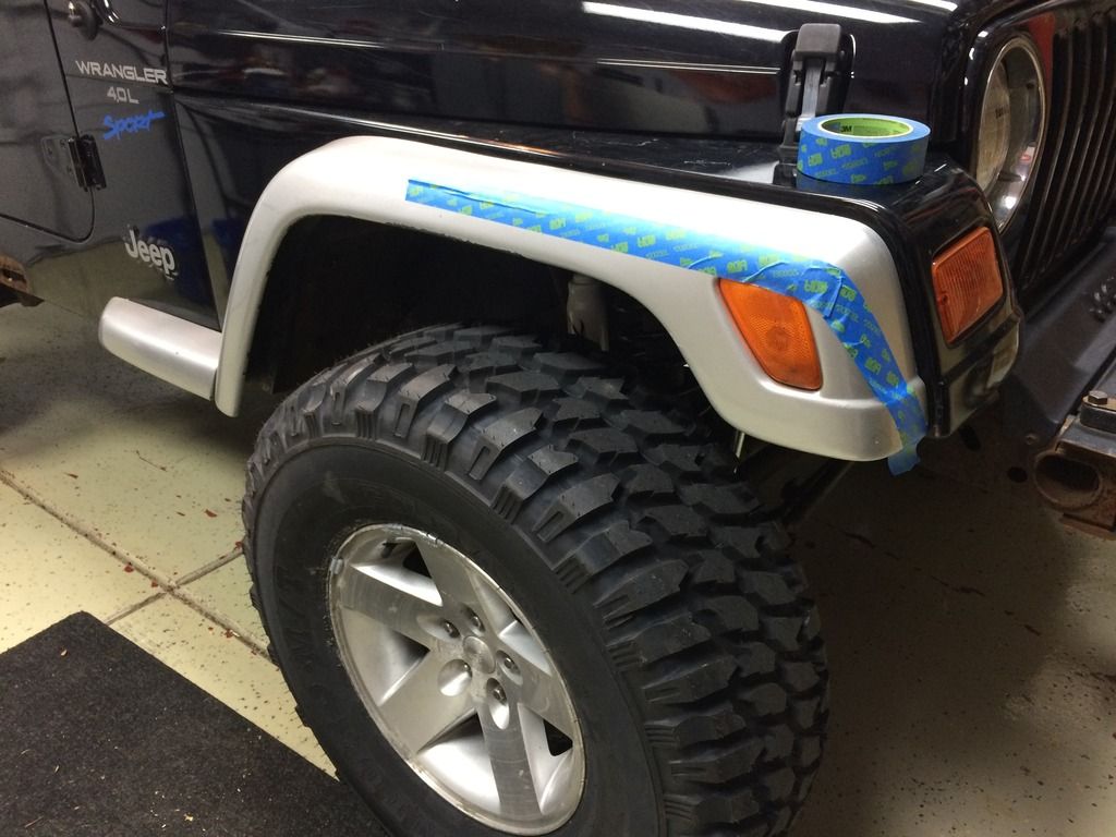

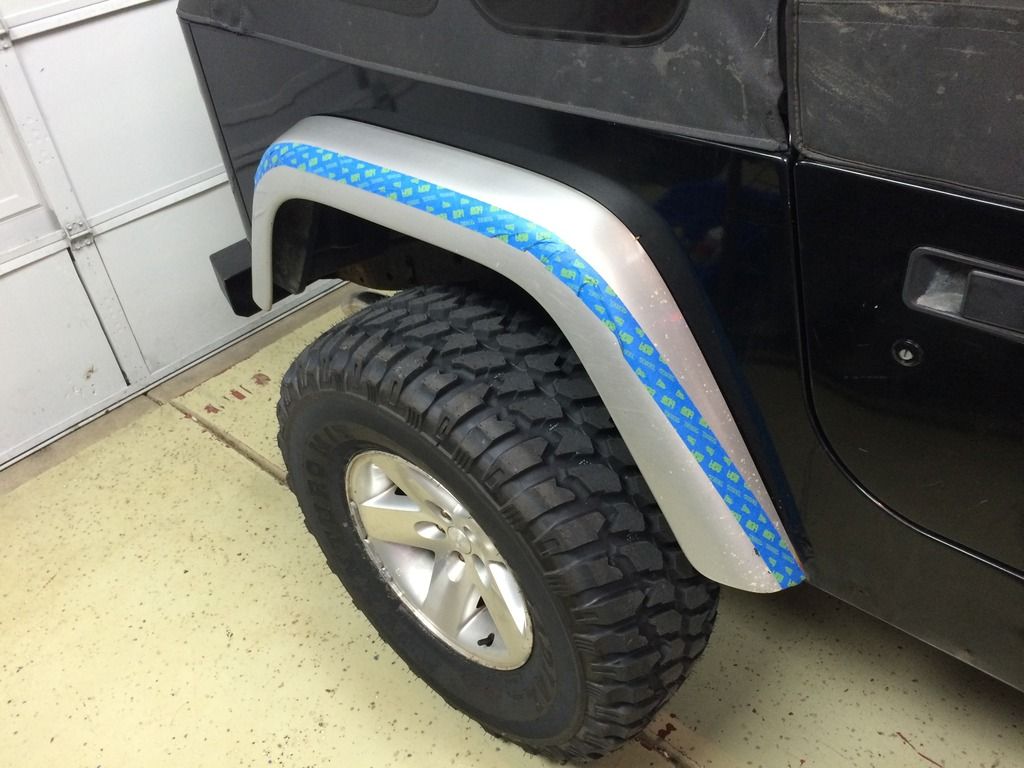

Did a little work on the Jeep this weekend.

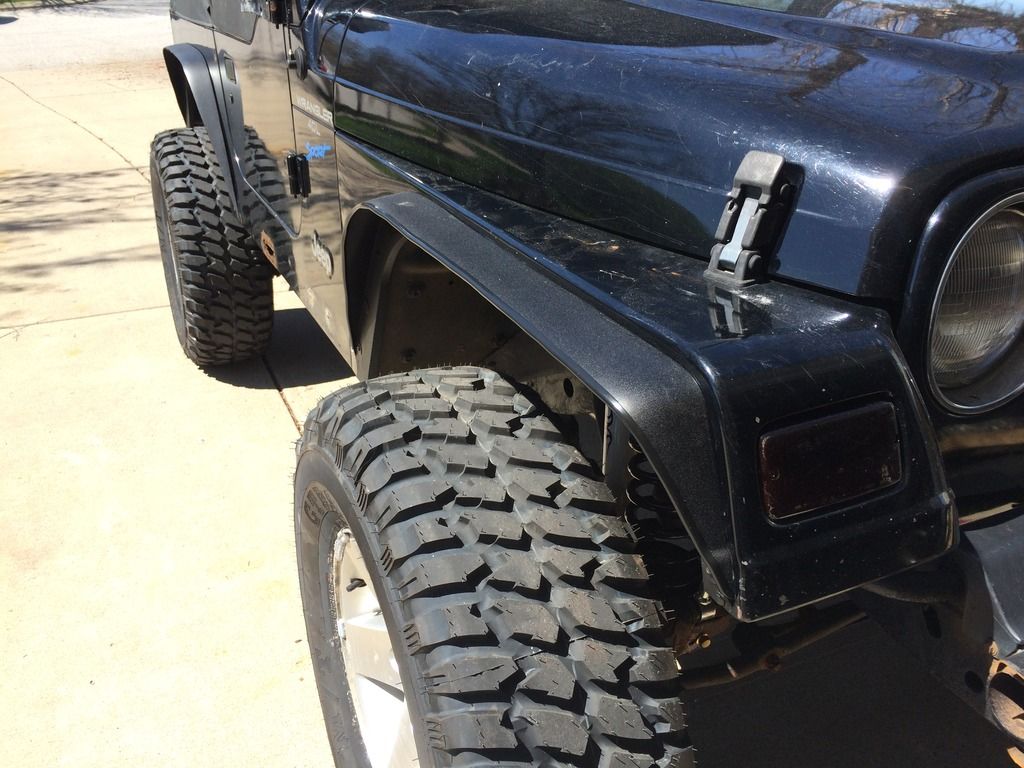

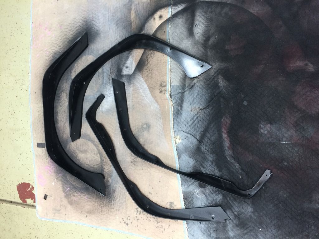

First thing I addressed were the fender flares. They were silver with paint flaking off all over and they were cracked. So I decided to trim them and then paint.
Some before pictures:
Then after:
After cutting and painting the flares I took some door edge molding and put it on the edges of the flares.
Also I decided to tint my front turn signals and also painted my headlight bezels black. Lastly, I added 1.25" spacers to help with the backspacing of the Moabs and the 305's.
