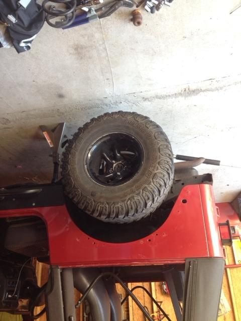

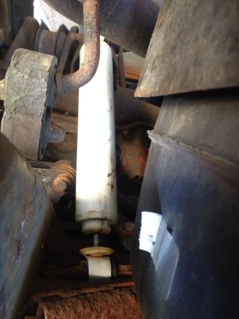

Got bored today so I went out and bought a 3 ton floor jack from HF. Couldn't beat it for $69. Finally checked clearances and where to set bumpstops at.. I ran out of time so I did the rear. Checked full bump and flex with the springs removed like Unlimited04 has in his posts. I had a 2" bumpstop from a while back from RC so that went in. With the jounce/springs removed I connected the shocks and jacked up to full bump. There were no interference at all (trackbar or gas tank).
Shocks are almost bottomed out when the bumptops hit, yet there's plenty of room left.
Flex on passenger side, driver side drooped.
I'm thinking I either need to get longer shocks or get my *** in gear and get everything I need to do for 35's. Tomorrow I hope to get my Savvy cable shifter installed, along with the front bumpstops.

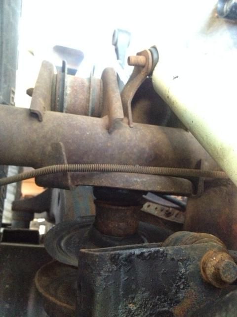

Well the bs continues.. Was off work today and it's rainy so I decided to do a few things to the jeep, being switch both track bar bolts to hex heads, set up front bumpstops and replace bolts in my TB bracket. So I ran to lowes picked up a couple bolts and a T50 bit. Right when I started trying to loosen the front torx it stripped, though it was the right size. It looked like someone tried to mess with it before I did. So it's either cut it out somehow or get someone to weld on a nut. :thumbsdown:
Then headed to the back to swap the others out. The rear torx came out perfectly because I've dealt with it before and used anti-seize. When I went to remove the brackets top bolt I realized it was loose, and noticed the guy who put the bracket on didn't drill the hole out to 5/16".. So I either have to attempt to drill it out or just buy some more 1/4" bolts to replace the bent and smaller one that was in there.
