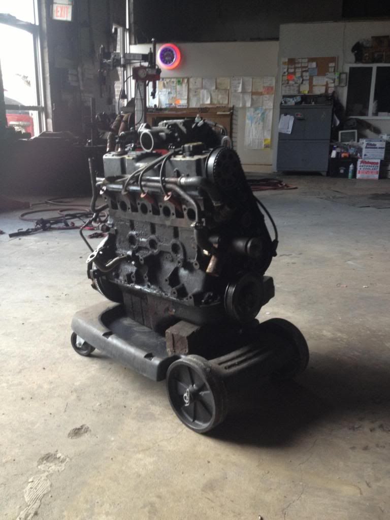

after searching for a week I have found and engine and I picked it up this weekend for $280 its a 2.3l turbocharged engine from a 1988 ford thunderbird turbocoupe. stock it makes 190hp and 240ftlbs.
I will be pulling it apart and rebuilding what needs to be rebuilt. 3 angle valve job, head gasket, timing belt, new rings, crank/rod bearings.
more pictures to come during the teardown.
