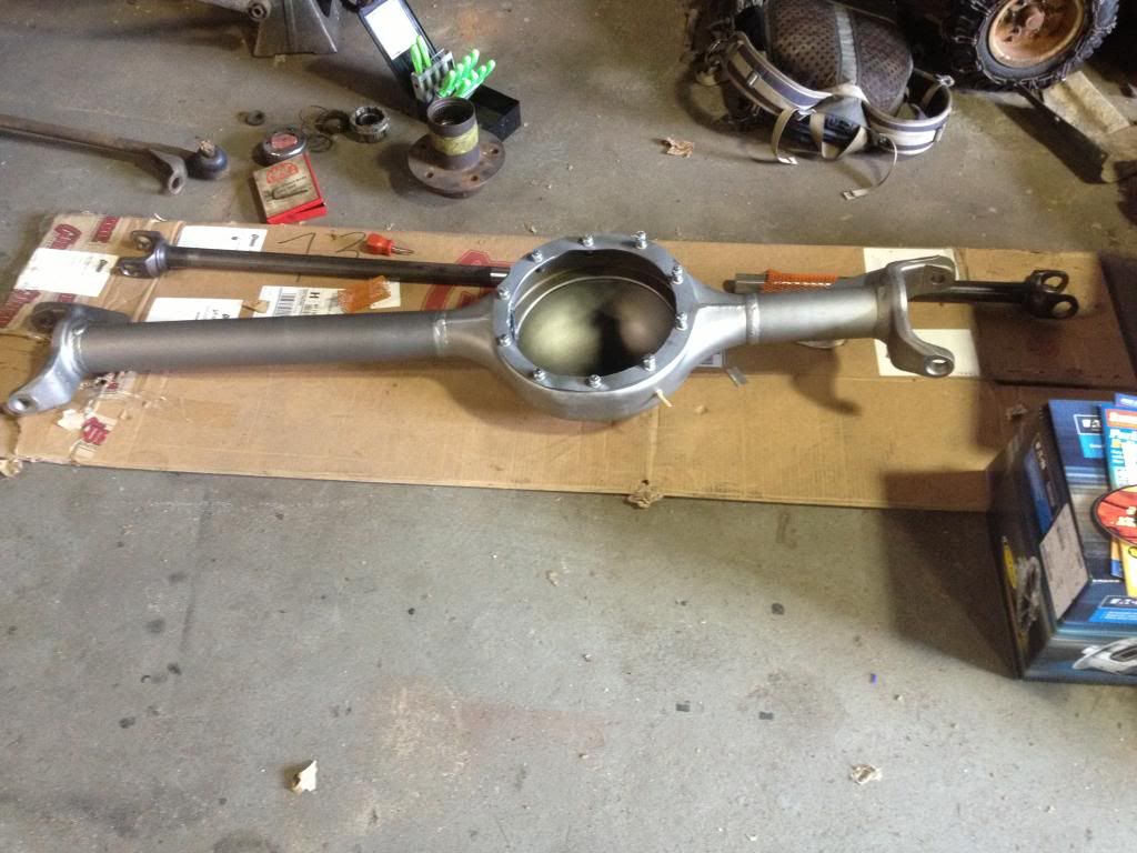

ive had a lot of parts sitting around waiting to be installed lol ive come to realize it takes a while to plan and build a jeep
currie 9" front housing custom built to a 65.25" wms
Detroit lockers and 4.86 gears

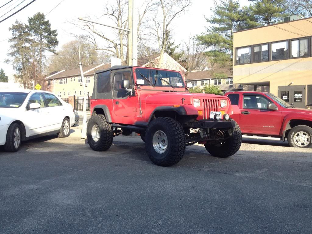

flex shot from a couple months ago. not much but good for sua 3.5" springs
last weekend wheeling i stuffed my 31s into the fenderwell. i was supprise that i could get the tire that far up!

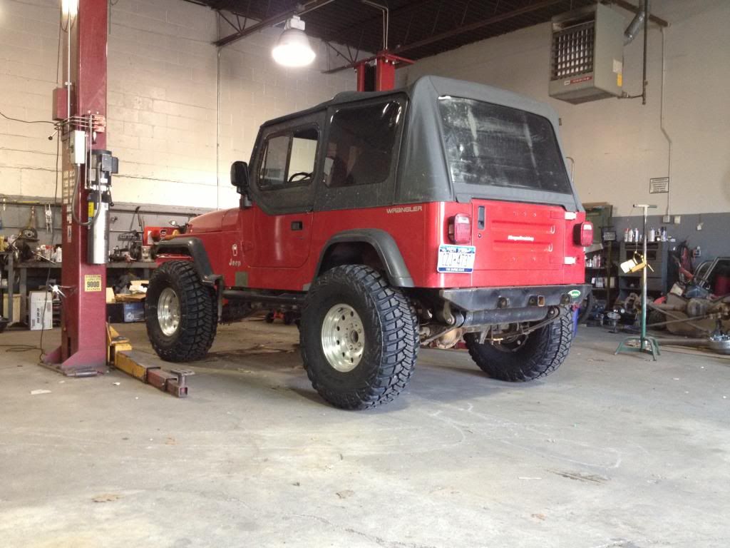

mounted my new tires up today jeep. im going to build the second third member tonight and Saturday the axles will get mocked up, mounts welded and mount everything up. all my brake parts came and will be setup after the axles are mounted
