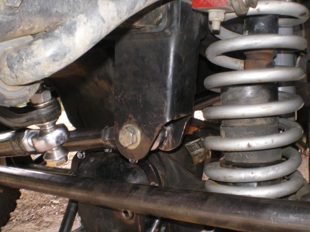

swapped in Currie 4" TJ coils today. the coil has about 4" more length unloaded, which will allow me to use the full stroke of my 12" shocks up front. If I can get about 1.5" more uptravel.
need to sort out some tire clearances and figure out how to keep my TB from hitting the dif cover.
the new coils are awesome. they are a bit softer than the RE's, and with the progressive rate they should ride a little nicer and soak up the bumps a little better.
RE 3.5" coil at ride height.
currie 4" at ride height
new ride height
