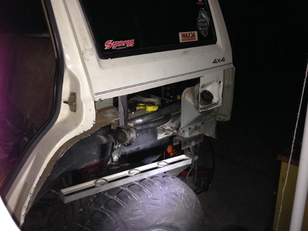

since then, I brought the jeep home, pulled the front dif and rebuilt the ARB.
and then I decided to hack it up a bit.
crap! we cut past the spot welds
start framing in tube.
we changed a bit from what you see in the pictures, the inner tube is more outboard than that, and the braces will change a bit.
the most difficult part of this is dealing with the fuel filler.
relocated the fuel door recess up... need to lengthen the hoses... damn that **** is expensive!
the rest of the unibody will be plated and the shock (12" fox) will run off the top of the Ubolt plate
now I need another 20' stick of tube and a sheet of 16ga to finish it.
