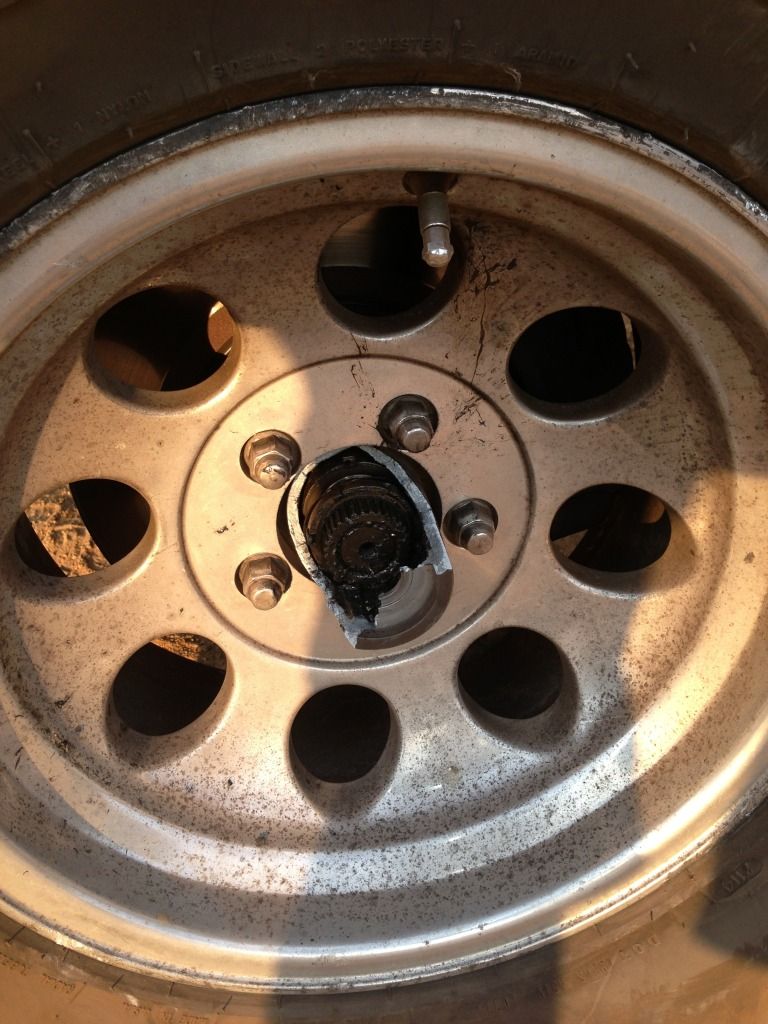

more recently, blew a hub on my first shakedown run. considering getting some CTM drive flanges

How did you do that, anyway?

too much skinny pedal.
