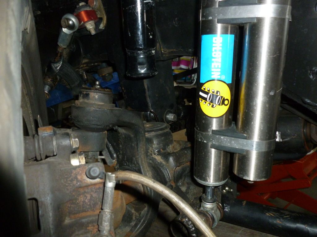

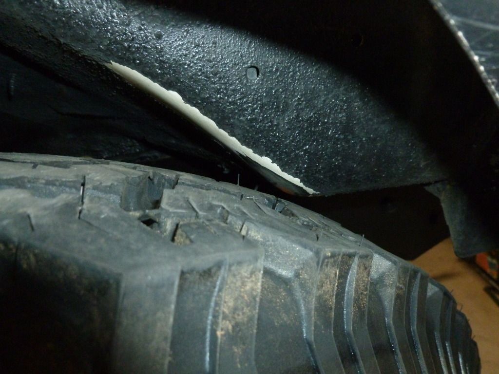

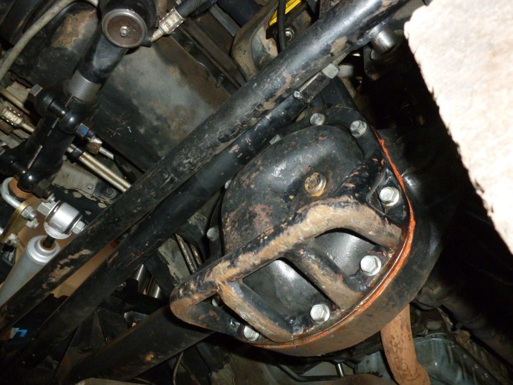

started working on dialing in the uptravel on the front suspension.
because I am running a straight panhard, I was having clearance issues with the dif cover. I started this project so that I could get a couple inches of uptravel back and put the ruffstuff cover that I won on.
I pulled the springs and shortened the LCAs to help clear the diff. right now, I have about 3/4" of shock shaft that I am not using. I could get that travel back but I need to clearance the inner fenders, which means a CAI of some kind and a Dry cell (optima style) battery.
driver fender clearance
driver shock at 'full bump'
passenger fender clearance
passenger shock at full bump
diff/panhard clearance at full bump. the panhard is 1-1/2" .250 wall DOM, I am going to build a new one out of 1.25" .120 wall chromolly to get a tiny bit of extra space.
a 4" piece of 1.25" UHMW will be added to the spring perch inside the prothane coil insert(not pictured) to act as a final bump stop. the prothanes I have are 5", I will space them up 1" with a hockey puck so that they have 2" of compression before the final bump is hit. the factory bump tower will have a 3"x3/8" bump pad (ruffstuffspecialties) added to it. I will have to shave them for the coils, but not sure about that yet.
oh and I need to drill drain holes in the factory bump towers. every time I pull the bumpstops they are full of water
You go about it all fancy and stuff! For my inner fender clearancing I just used this high tech tool called a sledge . My front bump stops are Daystar extendeds up top and 1 hockey puck a side on the bump pad. I like your idea better though!

I left about that much shaft showing on mine just to make sure I didn't kill the shocks on hard hits. Something to consider.
Why not go with a bent trackbar to clear the diff better?
Ditch that LS in the 8.8, it's a known weak point in those, especially on 35's. Throw a Detroit or an ARB in there and be a baller.

the reason I don't have a bent trackbar is that I'm running heims on both ends, so it needs to be straight.
