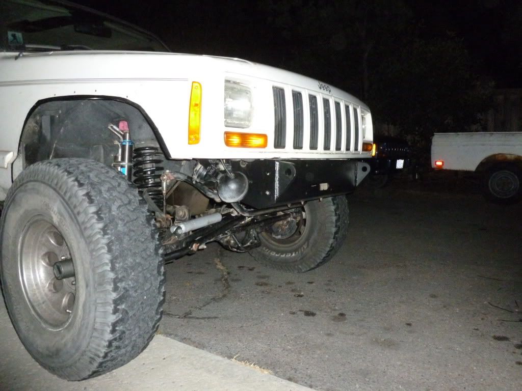

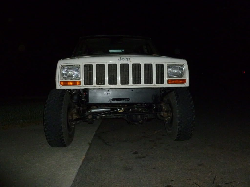

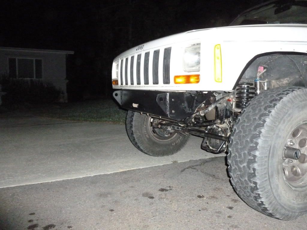

got my Actionfab front bumper mounted, along with a rebuilt OEM steering box ported and tapped for assist.
still need some kind of side protection for the headlights, relocate the vacuum canister and all the other crap behind the stock bumper, re-build the fender supports, etc etc etc.
next up is protane coil inserts for the front, prothane extended bumps in the rear, re-valve the front shocks, track bar brace.

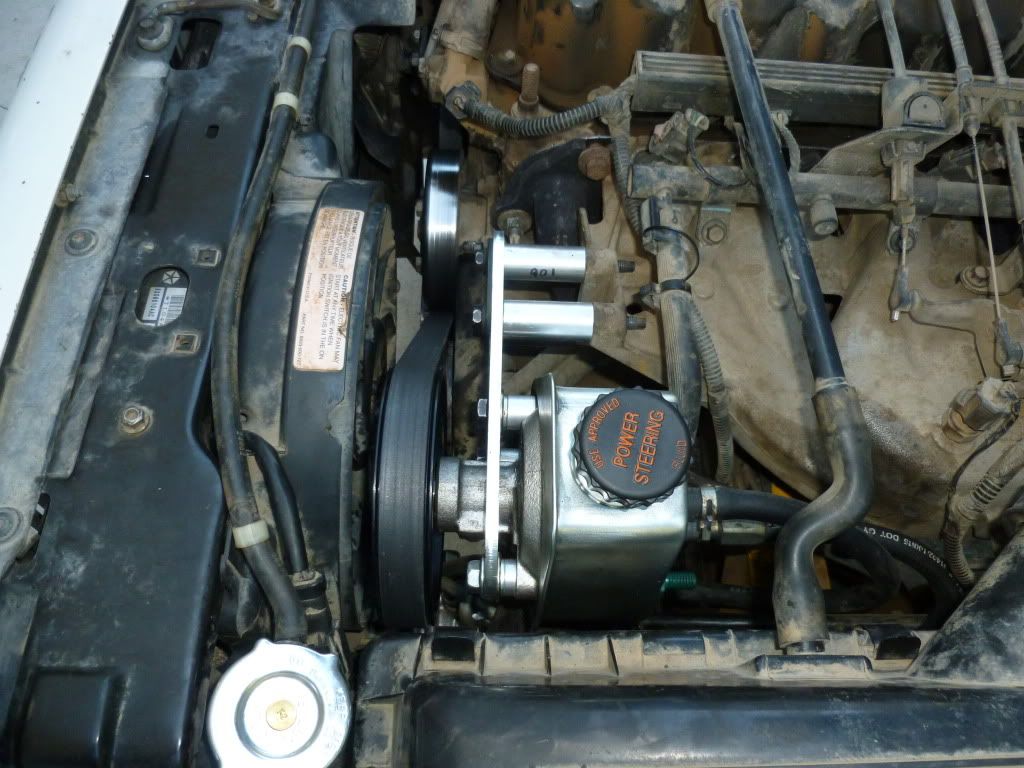

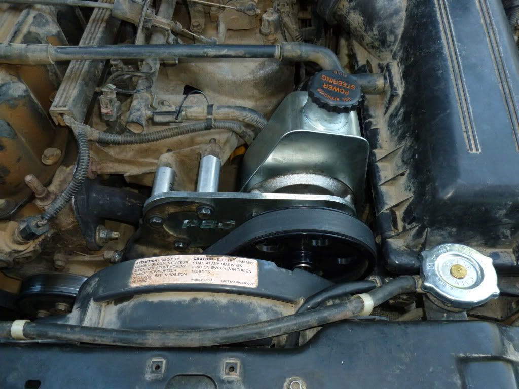

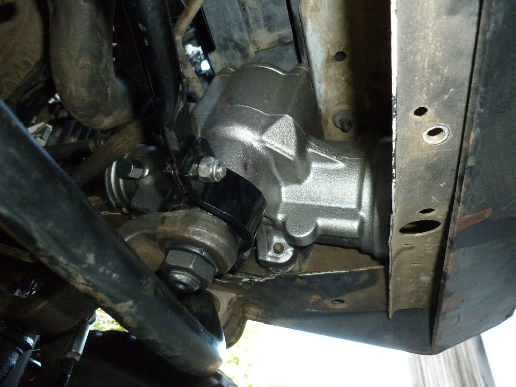

New PSC steering box, big bore, and P-Pump. had to make new lines as well.
pump with bracket kit
box

Looking good, I really like what you did with the crossmember. You end up running the Prothane's yet? I've heard good things, but it's always nice to get more input before I buy anything. Ever end up 3linking it like you had planned? ONE MORE THING, how do you like the p-pump kit? I've been thinking of getting it to help out the Durango box when I jump to 35's, but I haven't read anything on it yet.

I've been running the prothanes for about 2 months now. they are awesome, but I need to find a better way of anchoring them down, they get turned sideways once in a while. I am spacing them up with a hockey puck, so I am thinking of attaching them to that.
the power steering setup is the best thing I have done to the jeep. I can actually turn with ease while locked, even when I'm twisted up in the rocks.
I would not wait, the higher flow of the durango box is going to kill a stock pump pretty quick. the PSC p-pump and bracket kit is sweet, but you will need to make new a new High pressure and return line as well as get a longer serpentine belt. I also recommend putting a cooler on there.
