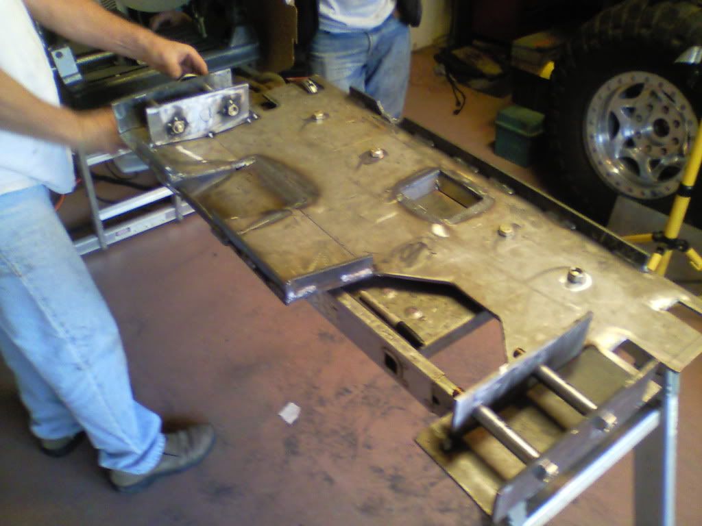

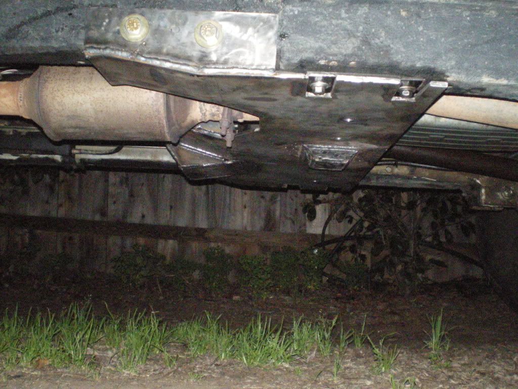

its been a long time coming.
finished the t-case skid today.
it has 2 9/16" bolts going through the unirails using anti-crush sleeves, and 4 9/16" bolts going into the crossmember.
still needs a bit of cleanup and a paintjob, maybe a few mor pieces on the side to protect it a little more.

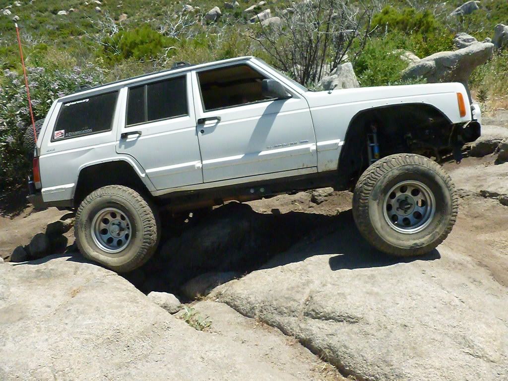

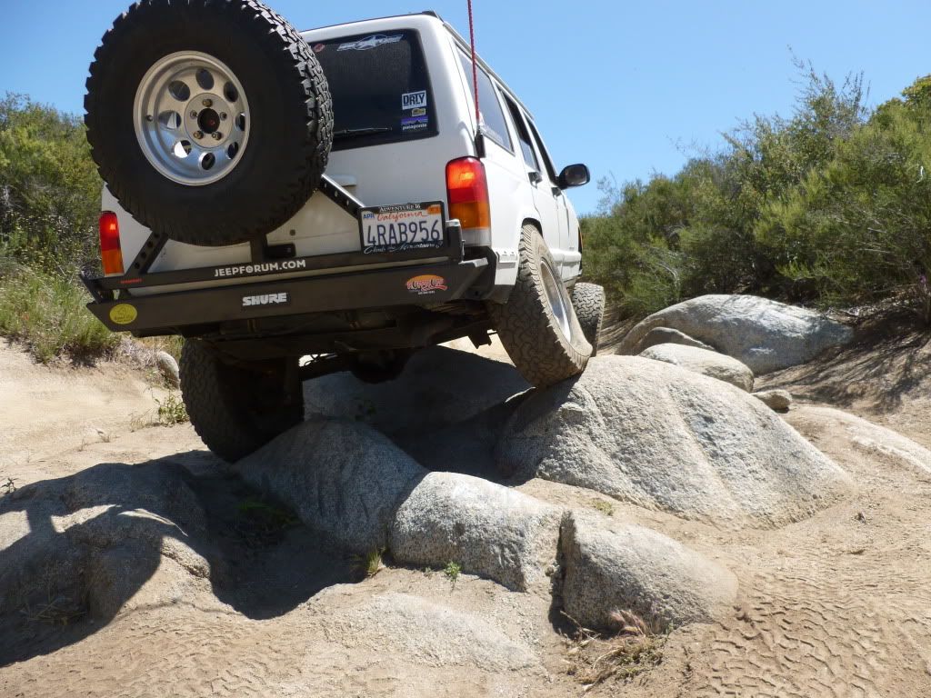

finally got back on the trail.
did some nice moderate wheeling in the desert. most of the run we did would not have been considered difficult if it weren't for the amount of exposure. mostly steep desert mountain trails, ruts, rocks, and lots of drops
more of a 'drivers' day as apparent by the number of JKs on 35"s and 37"s I spotted around corners...
exposed a few weaknesses in the build so far. need more fender clearance, need more travel out of the rear, and progressive bumpstops all around....

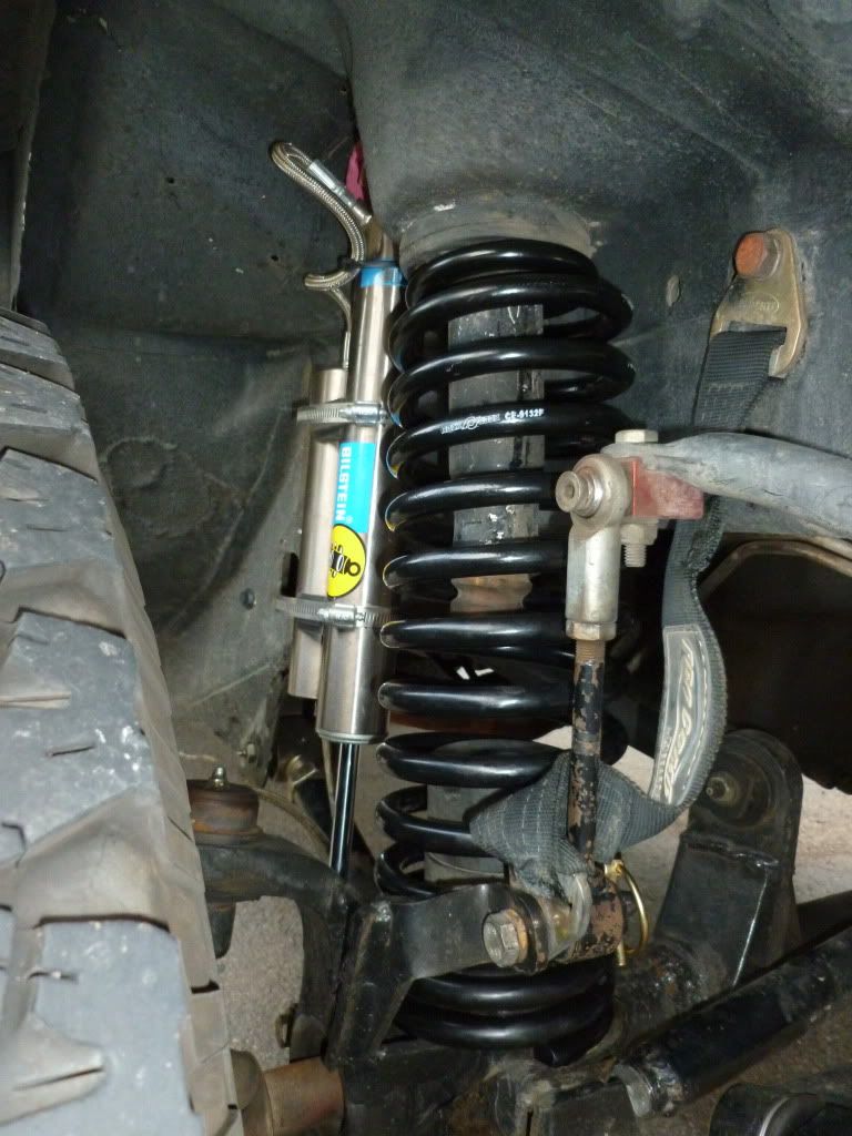

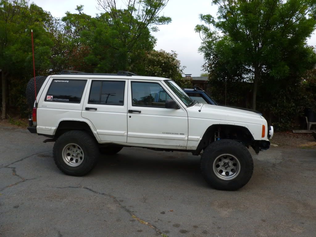

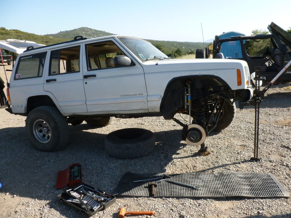

swapped in Currie 4" TJ coils today. the coil has about 4" more length unloaded, which will allow me to use the full stroke of my 12" shocks up front. If I can get about 1.5" more uptravel.
need to sort out some tire clearances and figure out how to keep my TB from hitting the dif cover.
the new coils are awesome. they are a bit softer than the RE's, and with the progressive rate they should ride a little nicer and soak up the bumps a little better.
RE 3.5" coil at ride height.
currie 4" at ride height
new ride height

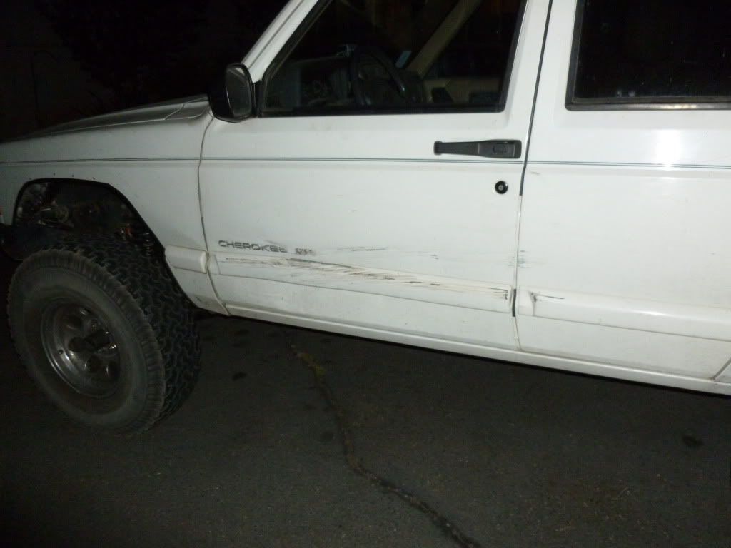

wheeled it. melted an ARB line. smacked the drivers door. blew a front Johnny Joint. had a blast
