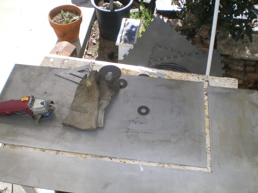

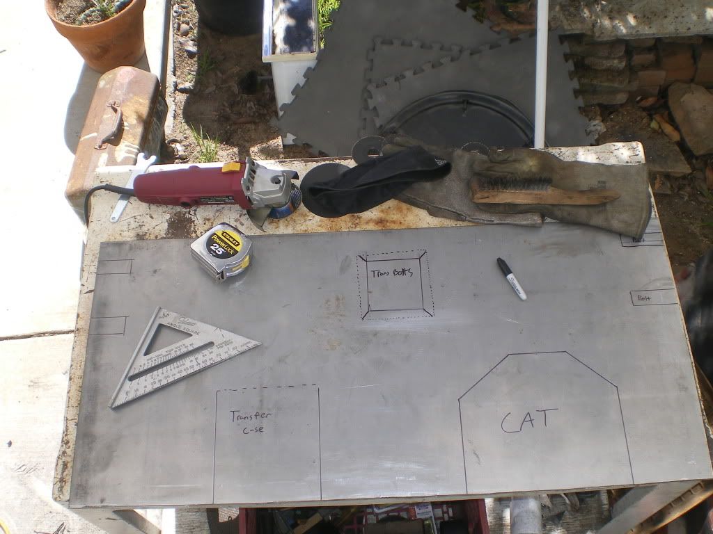

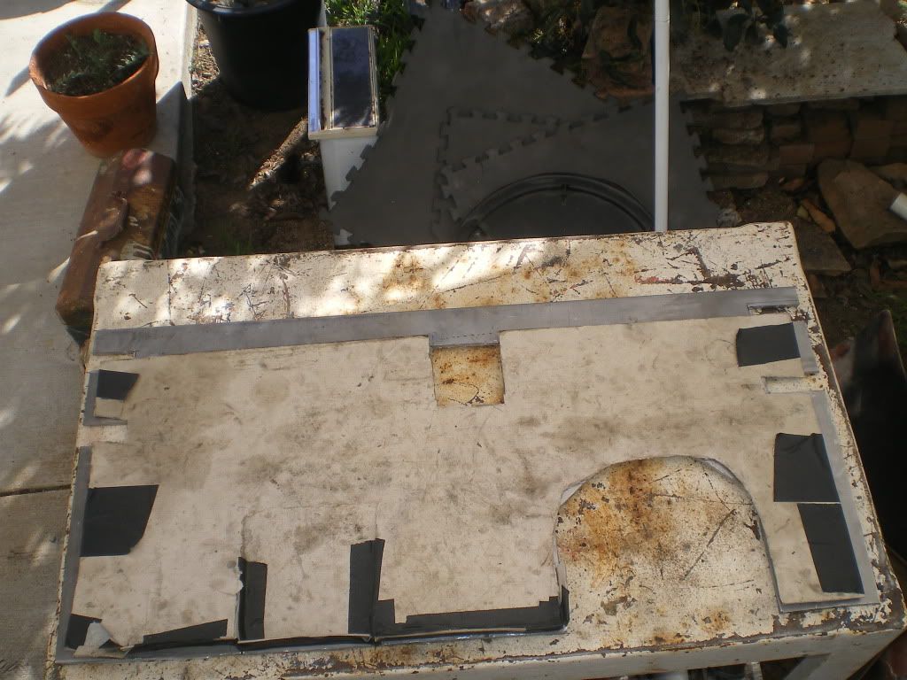

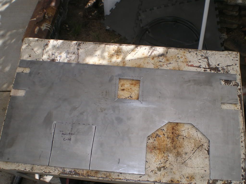

did a little work on the transfercase skid.
started with a 2'x4' piece of HR 1/4" and a cardboard template.
cut the piece I need 18"x38.5"
marked out where to cut reliefs and notches
cut said reliefs and notches.
a shot with the cardboard template I made.
now It needs to go to a shop to get 2 3* bends across the length of it, then the transfercase relief bent, then the tramsission bolt box relief will be bend. then it will get the gussets welded in, the tie-in points, and some holes drilled for drainage.
