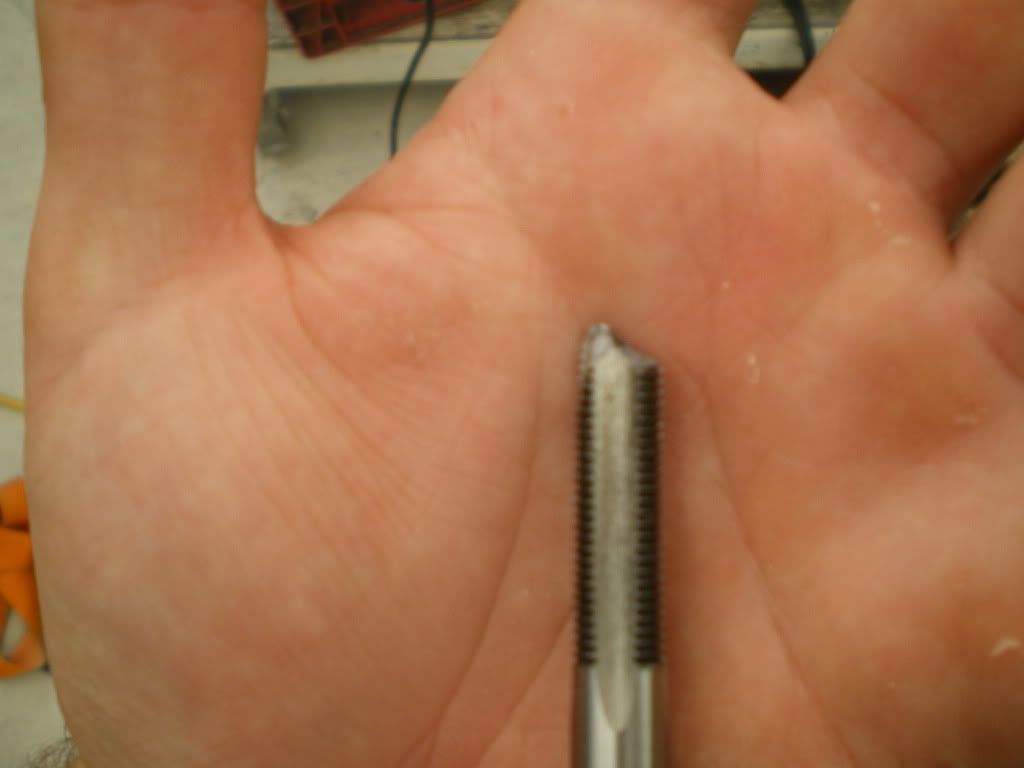

broke the tap that was sent with the kit, didn't even make one full revolution

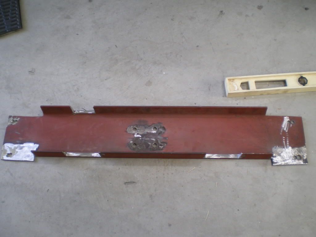

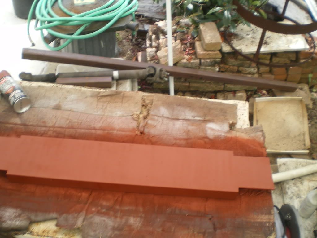

got my trans Xmember started...
all that needs to happen to it now is to have the holes drilled for the tranny mount and the tie-in brackets built.

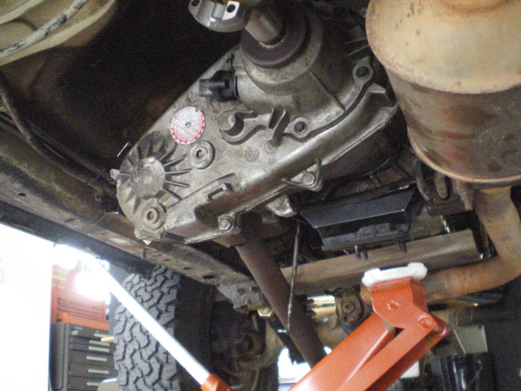

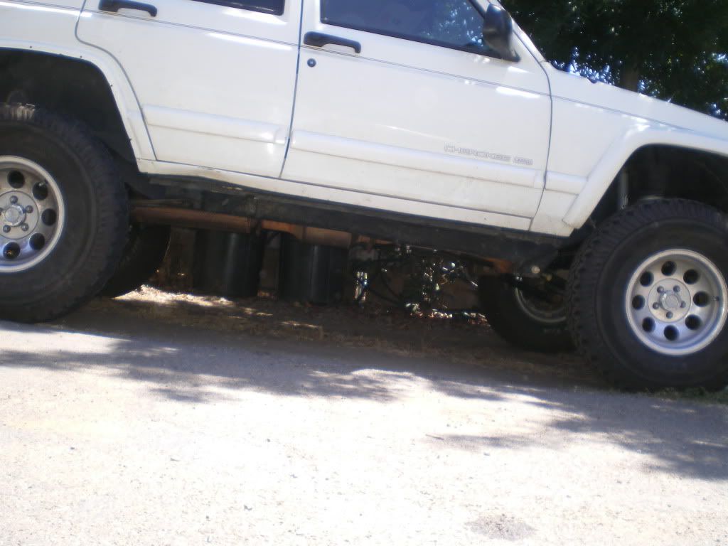

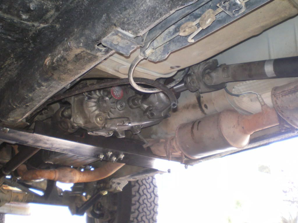

231 Transfercase hith H&T sye in
Flat crossmember (it was notched in a couple more places for exhaust hangars and front driveshaft. then all the extra holes were welded closed and then it was painted.
mounted
19" of ground clearance. with 4" lift and 33"s still need to re-build the rear driveshaft and get some shims for the rear end. my pinion angle is about 6* low..
after that is skid plate time.
I think I am going to end up loosing about 1" of clearance because I want the skid to drop down and protect the bolts and whatnot.

Update:

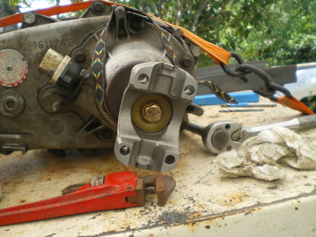

pulled the transfercase again, was getting a nasty clicking from inside, rebuilt case, only to find out that both of the driveshafts CV's went out at the same time, so when I ran the case without the rear shaft in, it still made the noise, and because of how the fixed yokes are, the noise sounded like it was coming from inside the case.
both shafts are at a shop being rebuilt, pics when I get them back
as far as unecessarily disassembling the case: oh well, all I am out is a little bit of ATF and some time, and now I know I can re-build one properly.

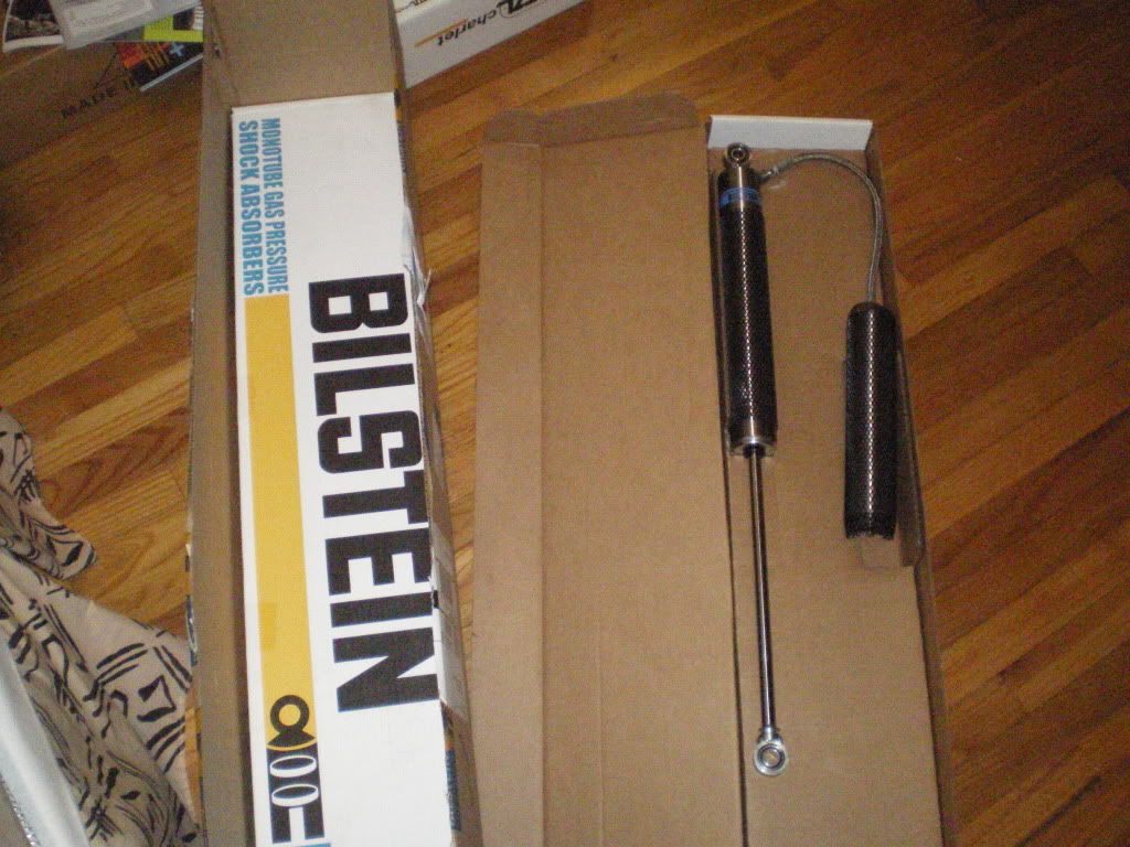

well... look what showed up at my house today
Bilstein 7100 Short Body Resivor, 12" Trave, 255/70 valving
I'm hoping to get them installed next week.
