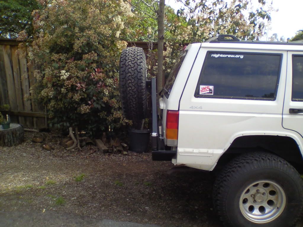

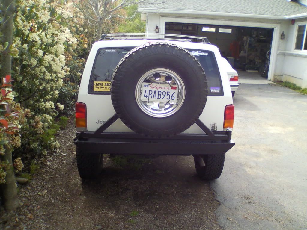

got he carrier bolted together yesterday. when i have some more free tim i will do the D-ring tabs and the hitch.
I'm also going to texture-coat it with some rustoleum hammered when its 100% done.
pics of the tie in brackets to come later

well, I went to the stealership and get the necessary T-case swap stuff ordered. my SYE has been ordered, and I need to finish up my new Xmember and skid plate for the attempt at going to a flat belly.
several guys on NAXJA have gone flat with a 231 t-case behind the AW4, so I'm hoping it works for me.
the tire carrier is in pieces, it will get welded back together soon, maybe tomorrow. I made a few modifications.

hahaha.... just a few minor issues, one of them being a license plate bracket.

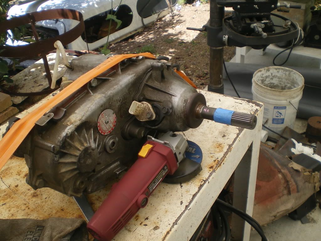

post #29 of 212 Old 07-02-2011, 01:10 PM Thread Starter
Climbit
Location: San Diego
Posts: 6,437
went from this
to this
I still have to drill and tap the hole in the output shaft, but I ran out of time.
its a dirtbound offroad SYE FWIW.
its a little bit long for my taste, but I think it will be fine. only time will tell I suppose.

im sure itll be fine. i wish i had went with an SYE with a yoke like that. makes having one spare driveshhaft that much easier. if you want some help with the t-case swap let me know.
