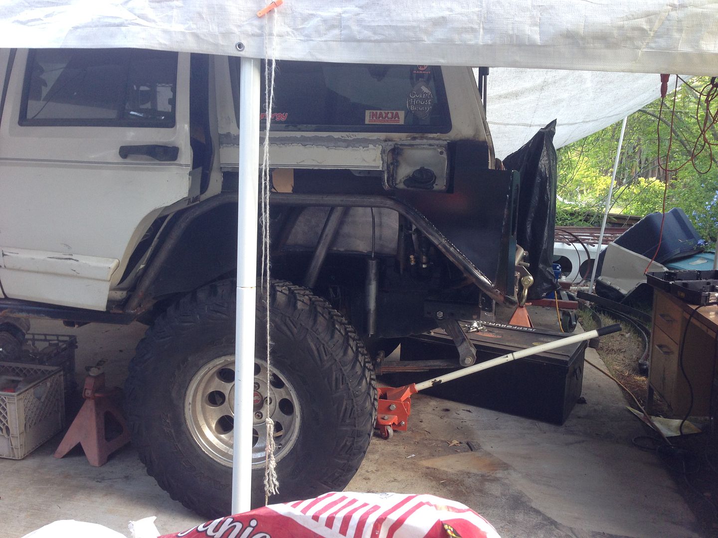

made good progress over the weekend.
I didn't take any photos. because I am dumb
rear bumper is done-ish.
rear quarters/taillights are welded in.
passenger tube work is 90% done.
shocks are rebuilt and ready to go
next up is front shocks rear stretch, driveshaft, shock mounts, and enclosing the cab.
and probably 10 other things I forgot.

updated: ordered a set of springs from National spring here in san diego. they are a couple weeks out and the jeep needs to be weighed before they are built. so I will be running on the RE's for now.
Shock towers are in
back on its own weight. once the new springs are in final ride height will be about 2" lower and the tire will be about 4" back from where it is now.

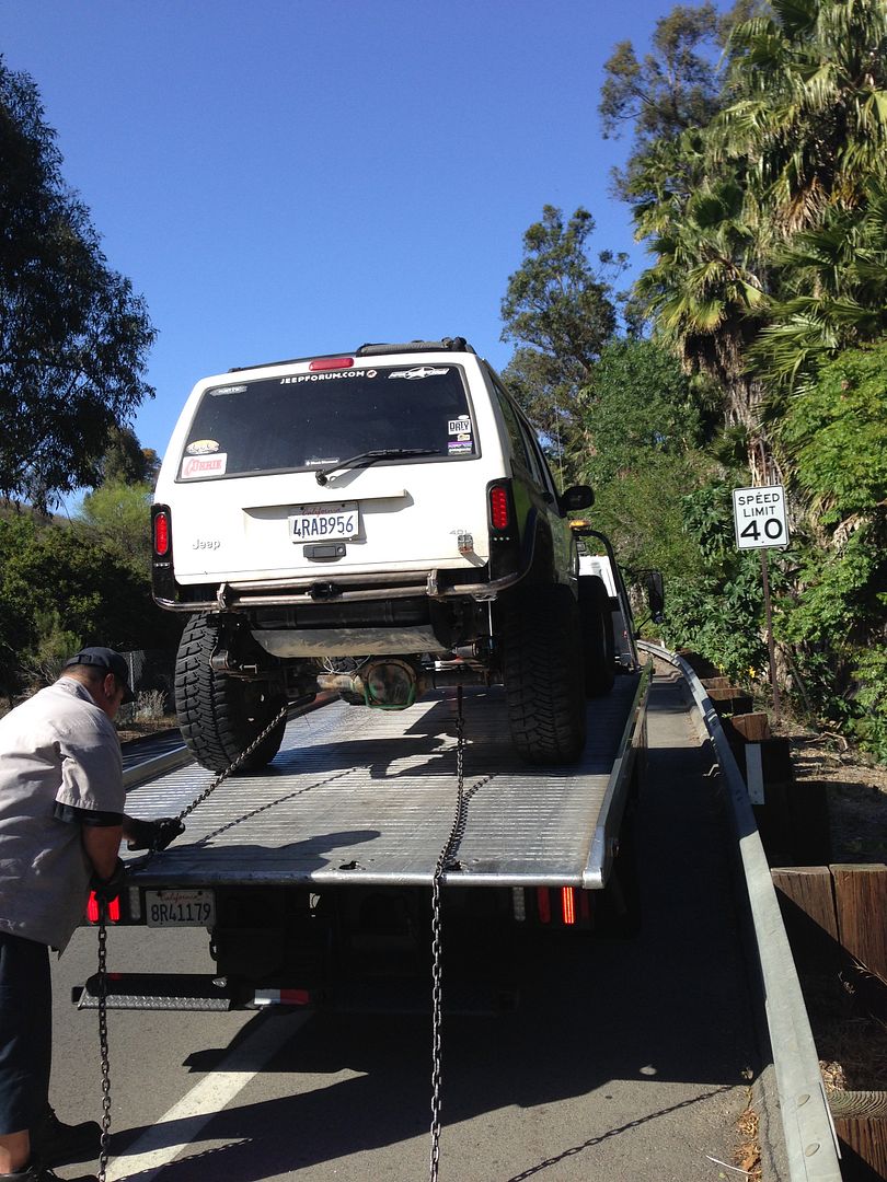

By chance did you remember about the main ground for the fuel pump that's inside the rear compartment of the vehicle?
If you happen to neglect to properly connect this ground, your jeep will get you just far enough to be stranded when it looses connection...
Joe Dillard is offline
post #193 of 212 Old 05-02-2014, 12:30 AM Thread Starter
Climbit
Location: San Diego
Posts: 6,432
I totally did remember it
after I got towed home
