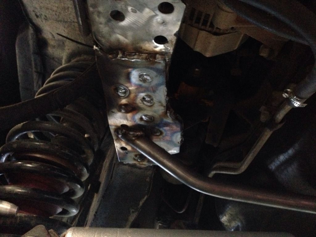

decided I was tired of my trackbar bracket loosening up, so I welded it. I also moved it forward about an inch and built a brace across the frame.
the uniframe was plated underneath the bracket with 3/16" and 10ga on the passenger side where the brace hits the uniframe. I had found a couple small cracks that were welded up in the process as well.
the brace will get cut off and have removeable joints welded in so that if I need to drop the oil pan I can, but that's pretty low on the priority level.

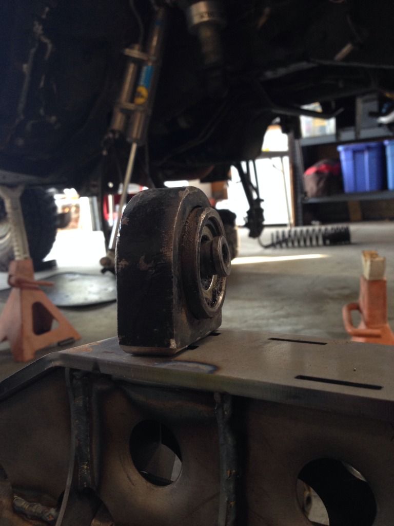

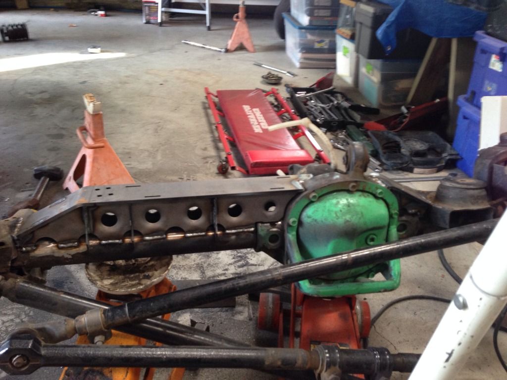

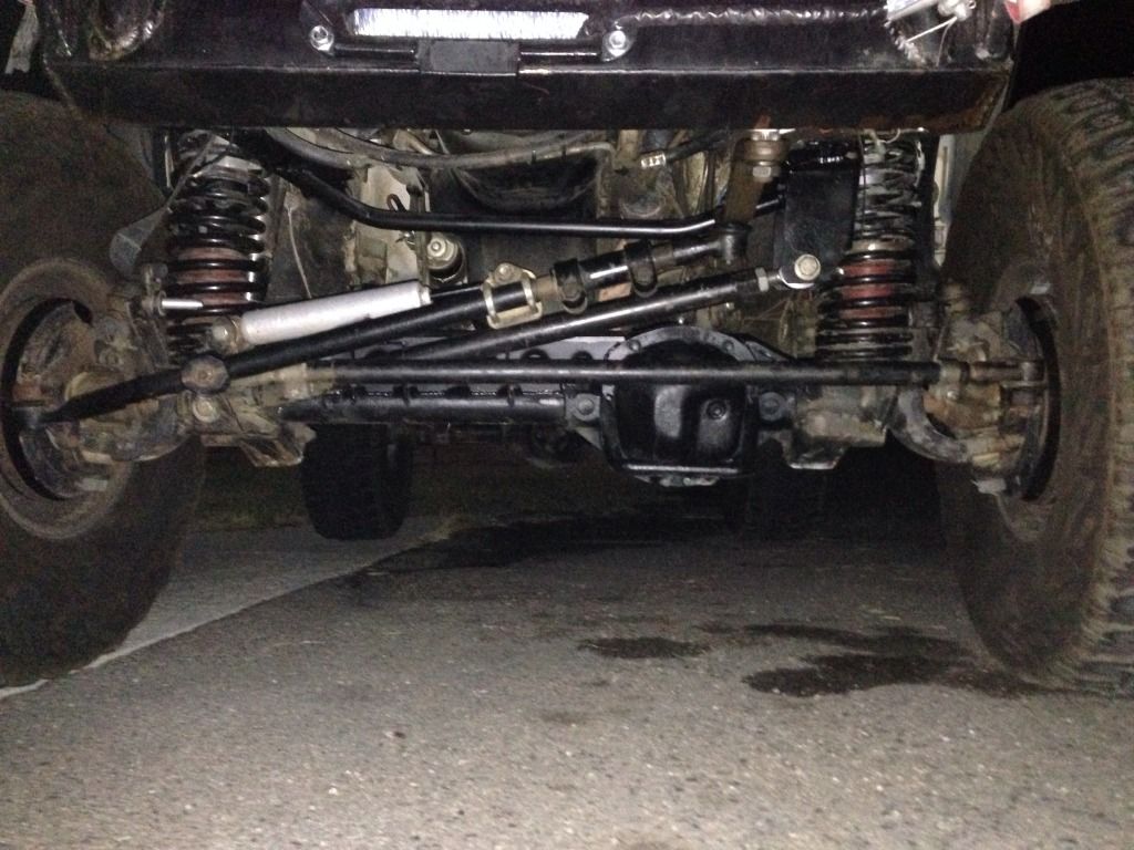

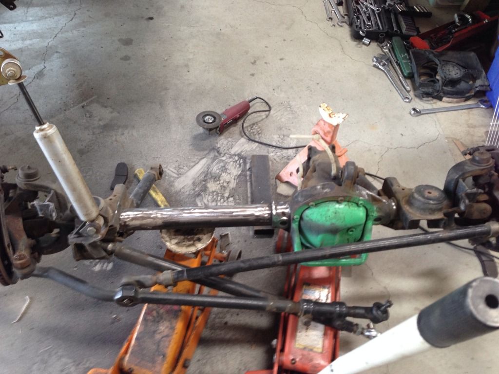

got the 30 out, put the artec truss on it.
I cut down the currie upper housing kit that I was running and welded it on the truss.
also installed a set of JKS ACOS to act as spacers and level out the jeep. I have them adjusted all the way up, so really they are just 1" spacers, to keep the front level with the rear after the shackle relocation boxes. but now I can level the jeep side-side and keep ride-height consistent once I add a cage or any other weight.
I did a lot of measuring with tires and checking clearances. I need to add 1" of bumpstop in the front for the short term. Long term I need to cut out the front inner fenders considerably to keep the tires out of them.

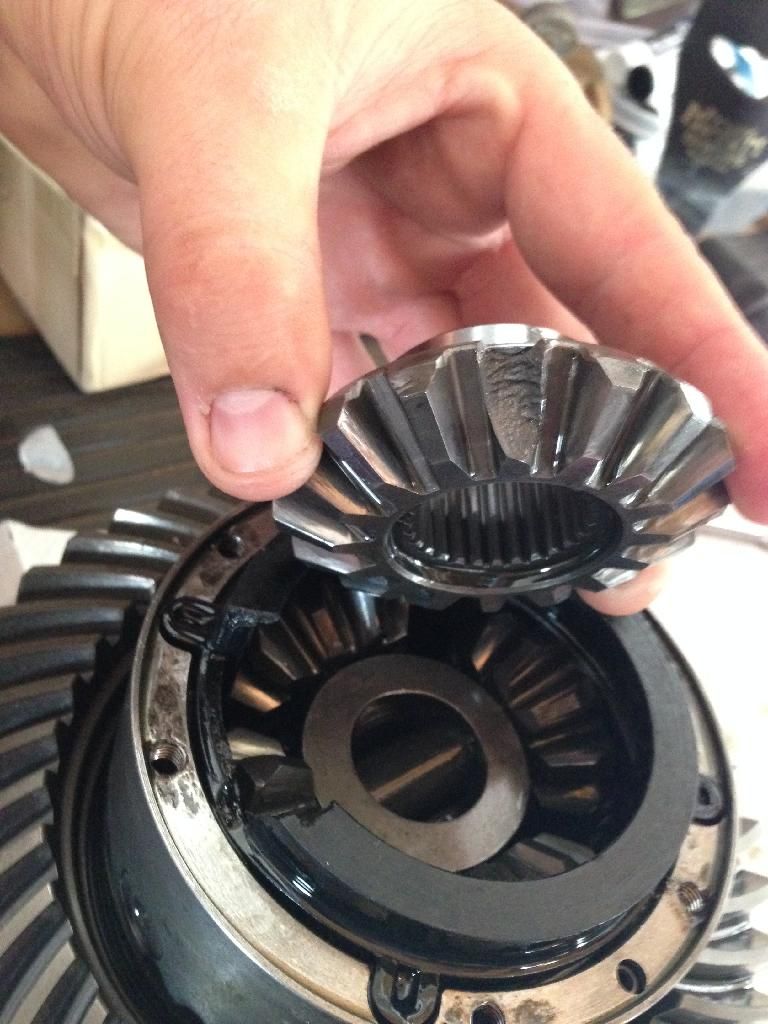

so... a lot has happened.
took the Jeep to the desert... wheeled the crap out of it... and broke it. took out the front locker on a climb.
http://www.youtube.com/watch?v=RSdvp...ature=youtu.be
http://www.youtube.com/watch?v=kozb1...ature=youtu.be

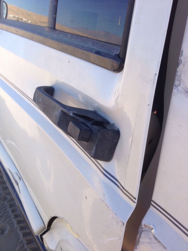

also managed to lean it into that rock and damage the door and C pillar. not too bad though.
Climbit is offline
post #163 of 212 Old 01-05-2014, 09:41 PM Thread Starter
Climbit
Location: San Diego
Posts: 6,452

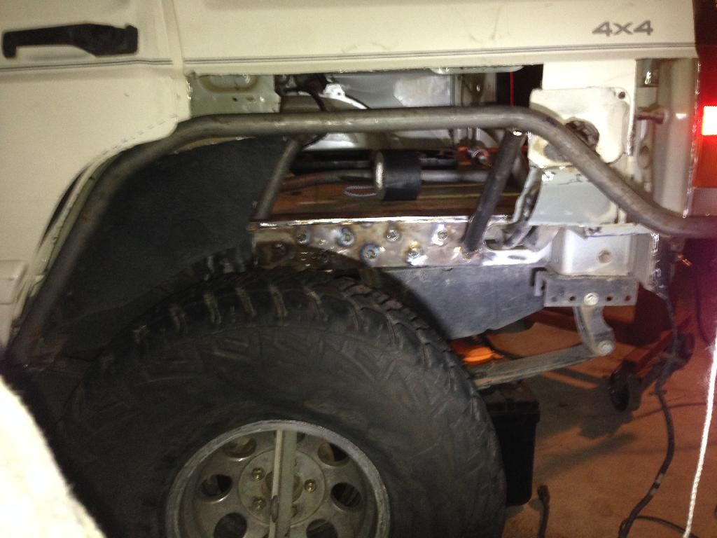

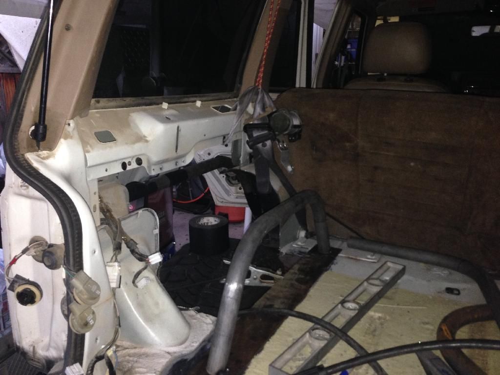

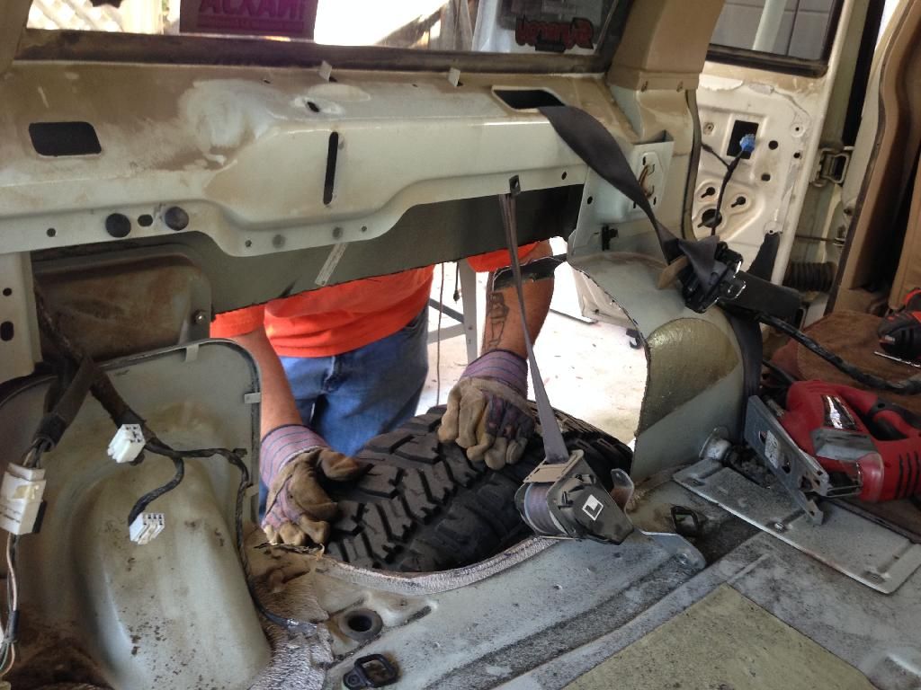

since then, I brought the jeep home, pulled the front dif and rebuilt the ARB.
and then I decided to hack it up a bit.

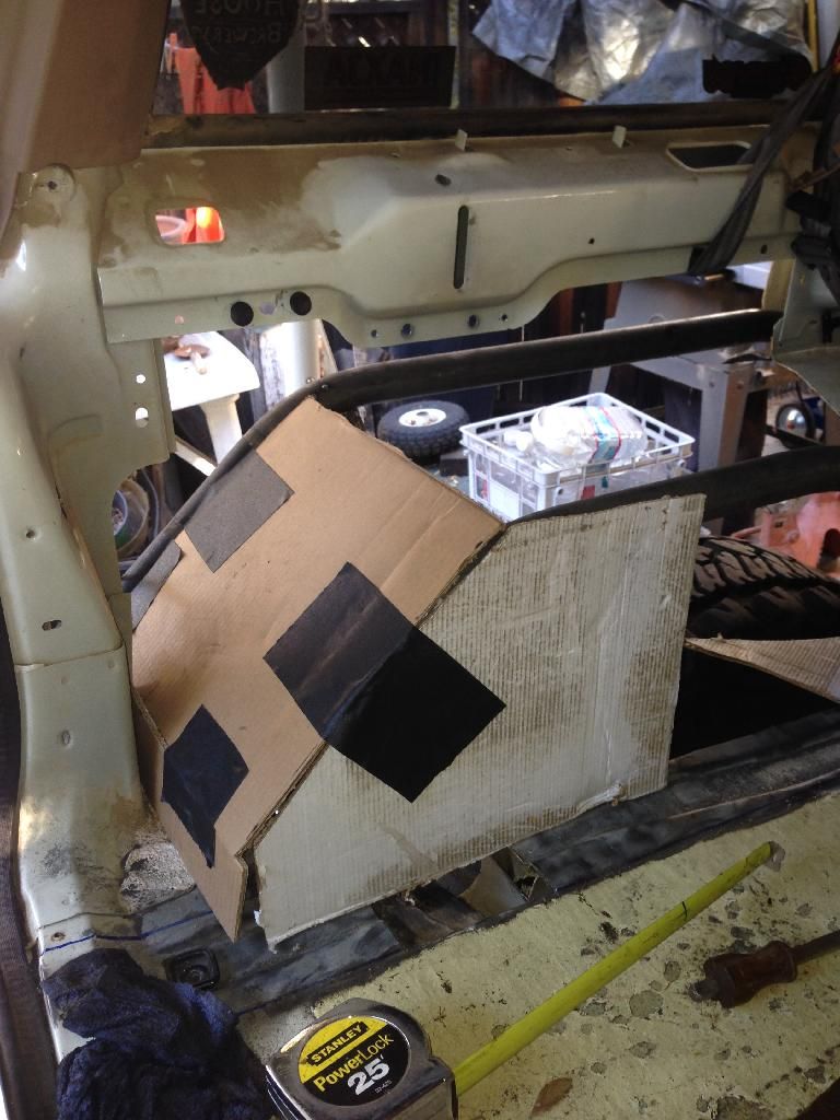

crap! we cut past the spot welds
start framing in tube.
we changed a bit from what you see in the pictures, the inner tube is more outboard than that, and the braces will change a bit.

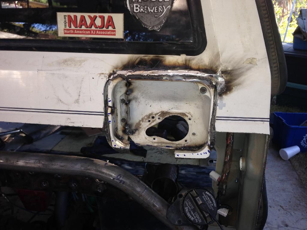

the most difficult part of this is dealing with the fuel filler.
relocated the fuel door recess up... need to lengthen the hoses... damn that **** is expensive!
the rest of the unibody will be plated and the shock (12" fox) will run off the top of the Ubolt plate
now I need another 20' stick of tube and a sheet of 16ga to finish it.
