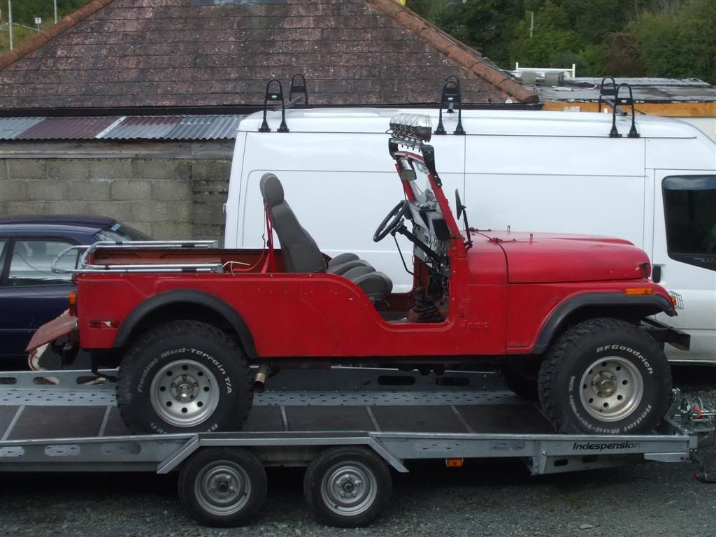

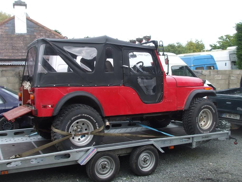

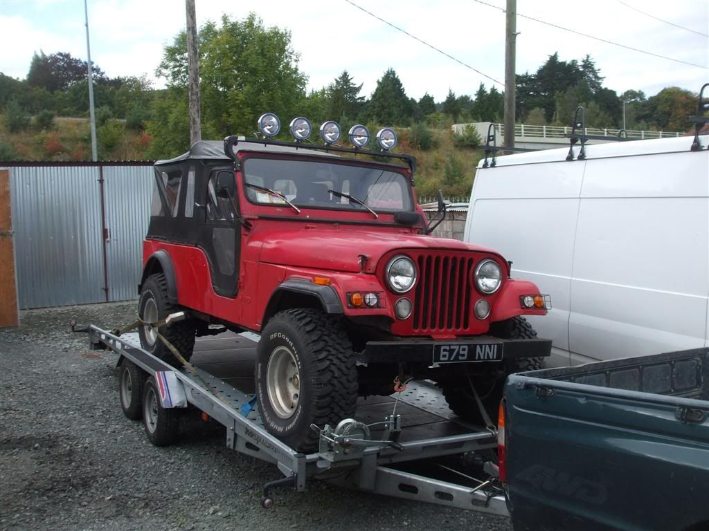

I brought a 1975 CJ6 last weekend for a winter project, I'm sure to have a few questions along the way, here is a few pics,

How did the little mazda do at moving that around? how did you stop???

i like they light bar

Thanks for the comments, the little (work horse) Mazda towed it fine, the trailer is braked also and is quite light, just leave big gaps between you and the next vehicle,

I'm glad someone likes the light bar - not sure if it will stay on the final
model

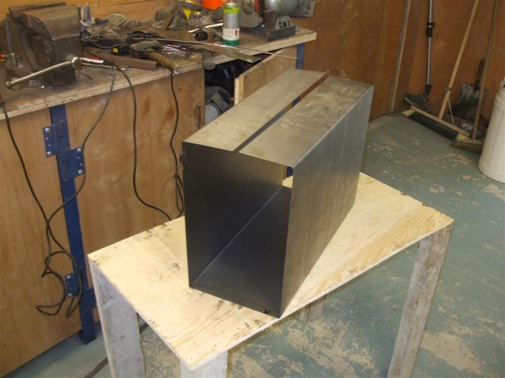

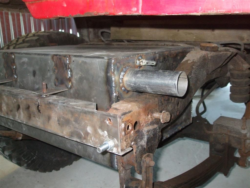

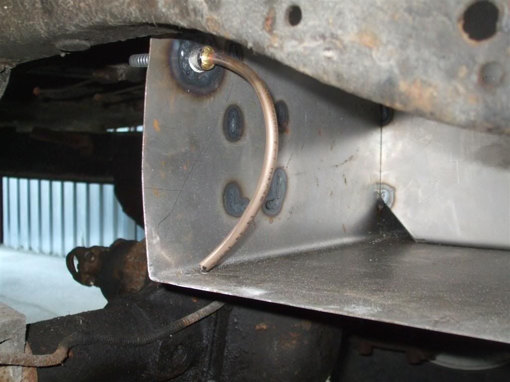

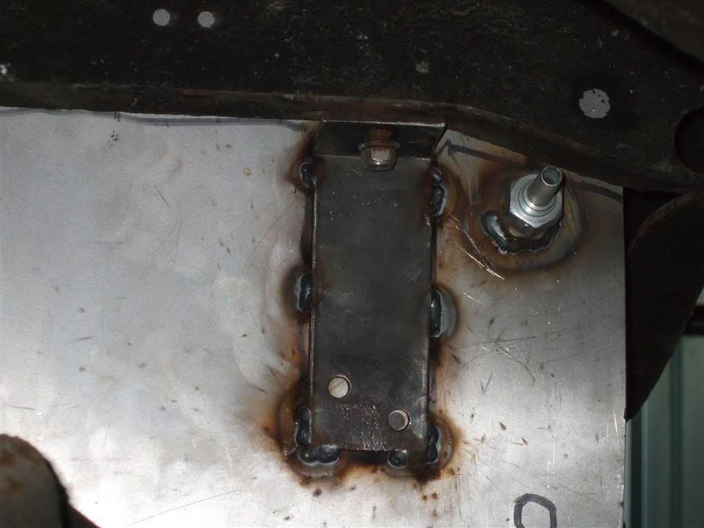

The fuel tank was knackered so I decided to make my own, first off I needed to bend up the tank so I built a sheet bender,
Then I fitted the tank and worked out the fuel inlet position, fuel vent and fuel outlet
Next i made the bracket to hold the tank in, someone had removed the original rear member so I made my own to replace
Now just waiting on the new sender unit and then I'll fix the final end in place.

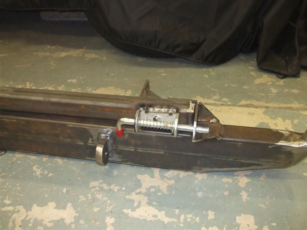

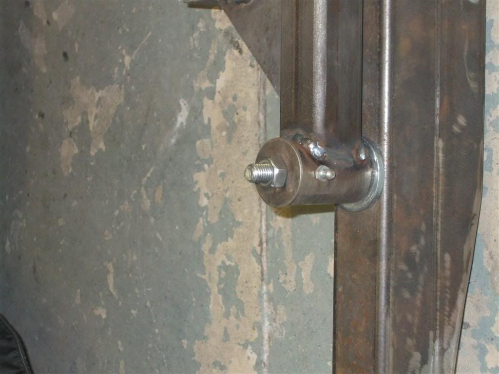

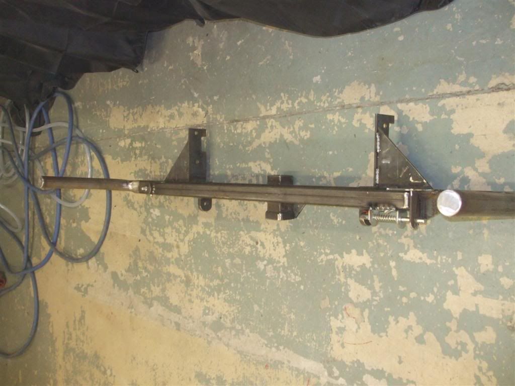

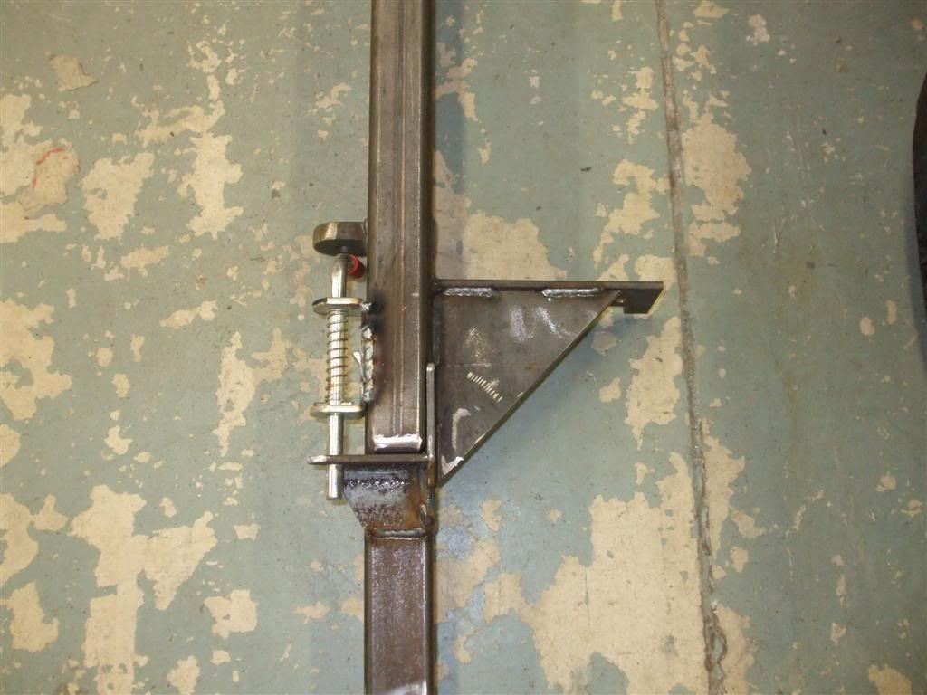

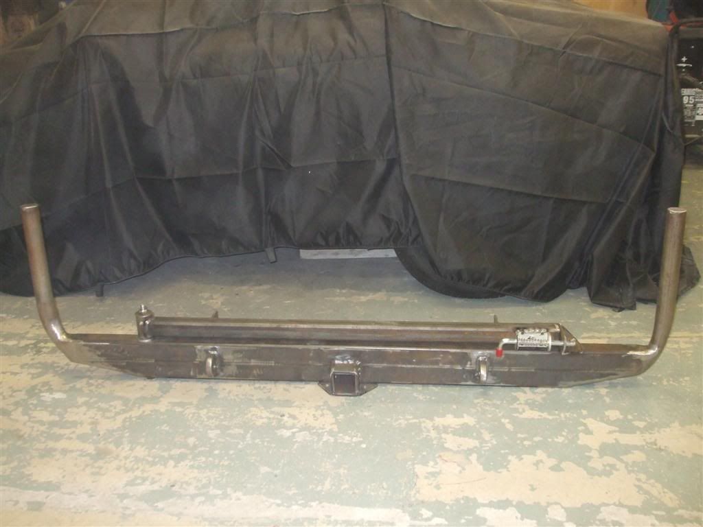

So I didn't like the rear bumper that was on the jeep, it was messed about with, had a horrible low tow hitch and had no tire carrier, so I decided to make one myself, I looked at heaps of designs and then added to this, here's a few photos so far,
IrishCJ6 is offline

The finished item

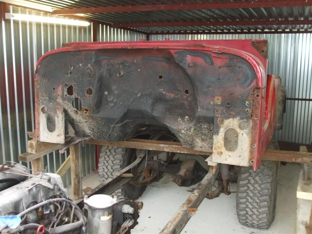

Have done quite a bit since my last post, here's a few pics,

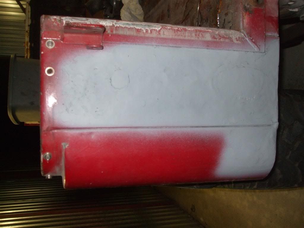

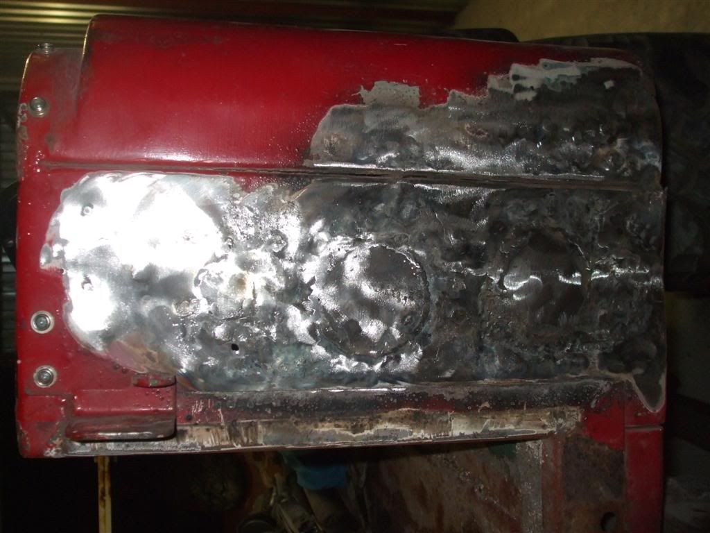

Removed rust from rear tailgate
Filled in all the holes on the rear where over the years people had tried various lights etc

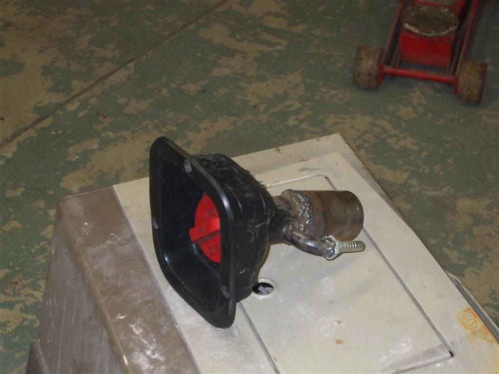

Then moved the fuel filler location to better suit my new tank and make accessibility easier,
I then removed the body off the chassis,
I then started to remove the underseal,
Then onto rust,
IrishCJ6 is offline

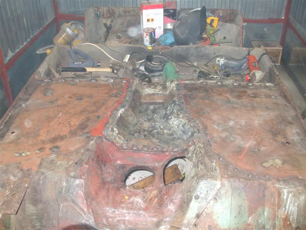

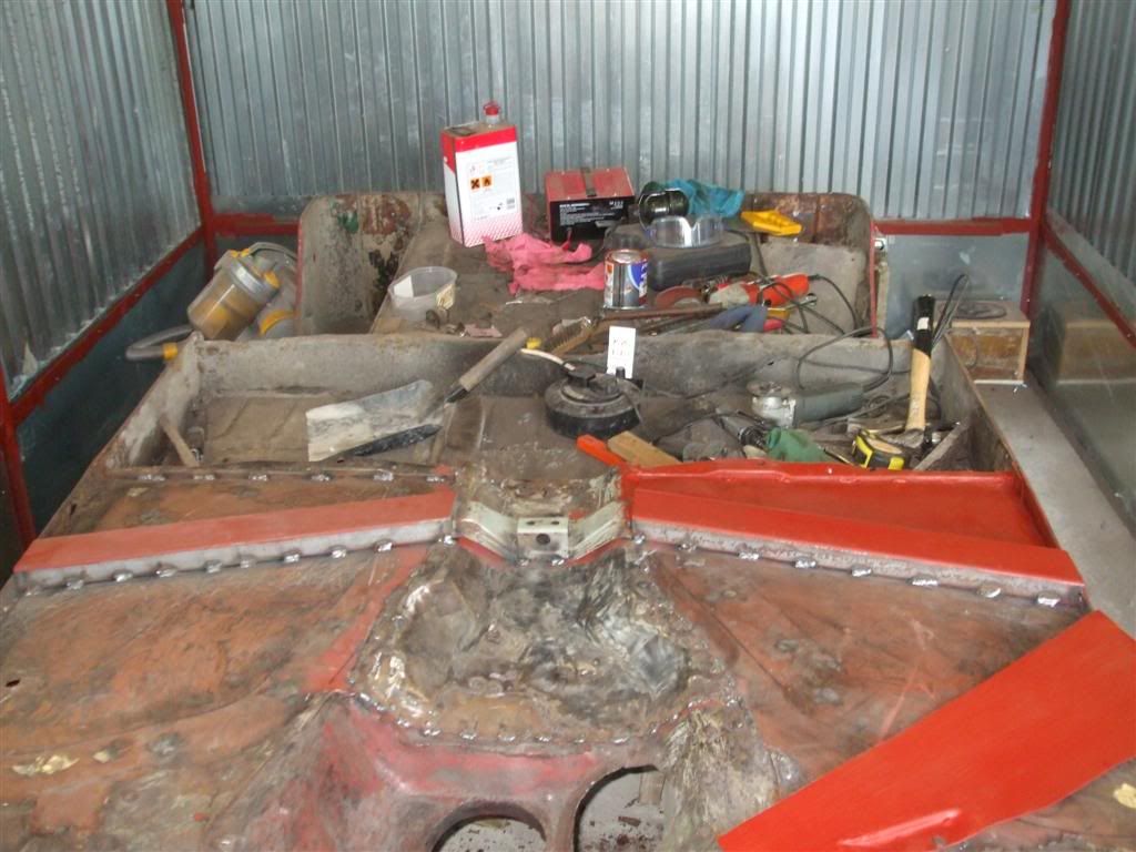

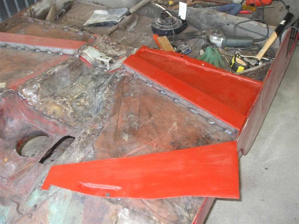

Today I started on the stiffners and finished off the tunnel wing panel,

So I've now finished off both sides, made the front section too but will weld them on later as I need to repair some of the front panels, think it looks good to me,

A few updates of progress,
Picture of completed stiffner replacement
repairs to front panels
