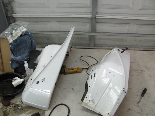

We got some more progress done tonight. We welded in the filler panel for the passenger side quarter overlay
After filler

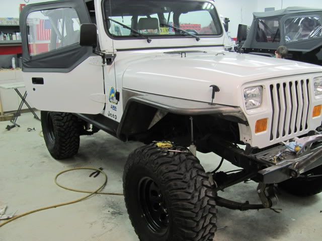

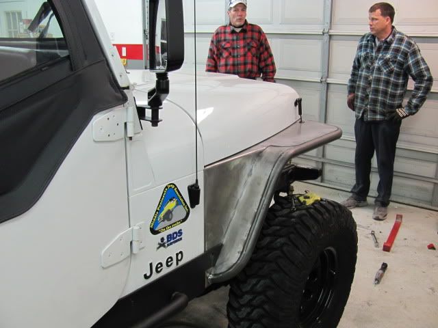

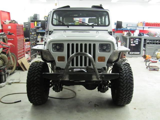

We got the passenger side fender off and trimmed the front of the rock slider to allow the fender to come up to the correct position . Still have to do the driver side

we also trimmed the quarter to the edge of the overlay and we are starting to have a pile of unused parts laying around.

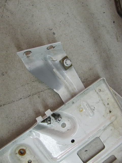

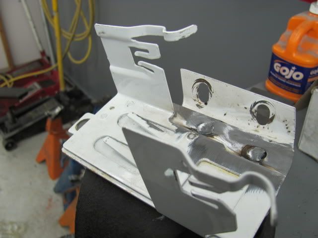

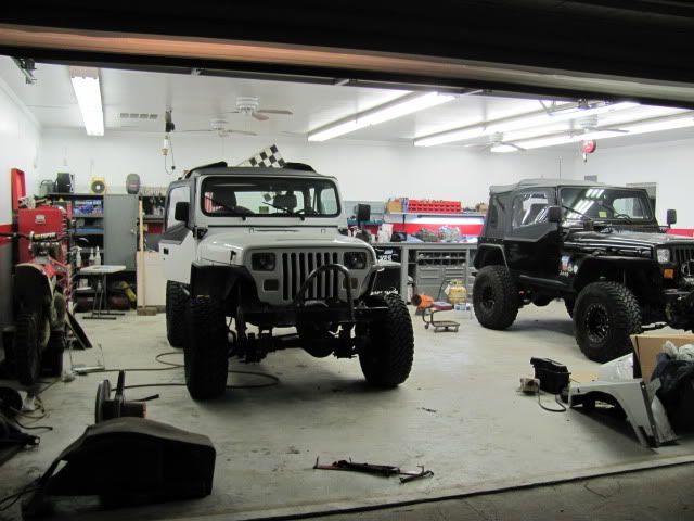

tonight we went ahead and mounted up everything how iti is going to be. This will be a big help after it is painted, all we will have to do is bolt everything down and clip in the wires.We started off by reworking the fuse box holder. We have come up with a good design in case anyone else runs the tnt fenders.

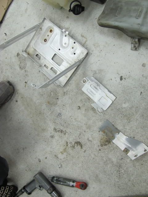

First get the battery tray and fuse block holder out of the jeep
next we marked the area to be cut off the fuse box holder
Once you cut that off, go back to the battery tray and drill the two spot welds out to get that bracket off thats in the first picture. you should end up with these three pieces
94YJ BDS 3.5, M.O.R.E shackles,1 inch daystar body lift, Ford 8.8 arb locker, 4.56 yukon gears, Dana 30 ARB locker, ARB compressor, HID headlights, LED tailights, TnT tube fenders and quarters, smittybilt rocksliders, raptor liner, ground pounder fab bumpers, 35" cooper stt tires on 15x8 cragar streetlocks,warn winch and more
gottkts is offline
post #21 of 50 Old 02-24-2011, 06:00 PM Thread Starter
gottkts
Location: hampton,va
Posts: 295

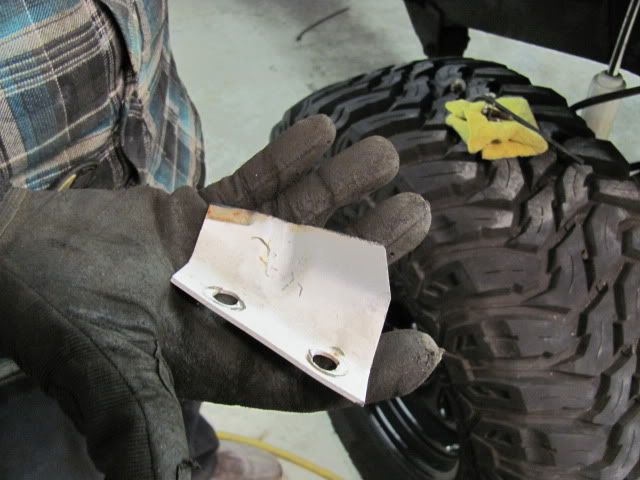

Now you can cut the battery track bracket down to about this size
then drill a couple of holes in the fuse bracket to plug weld through to the battery tray bracket
then you will have a completed bracket which bolts nicely to the side of the fender

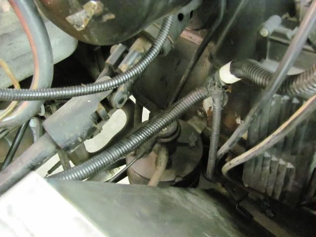

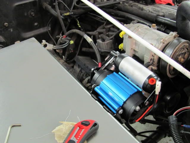

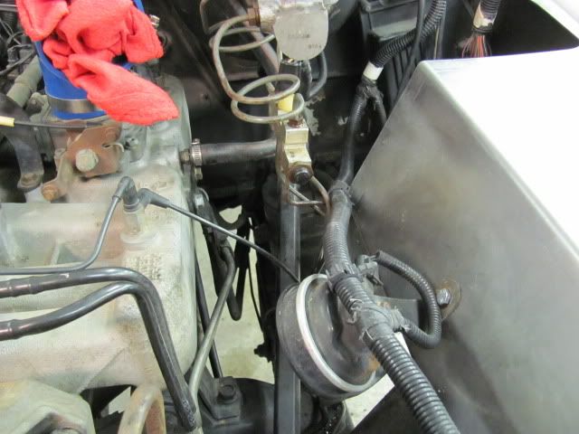

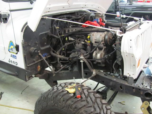

we also got the arb compressor and horn mounted as well as relocating the charcoal canister

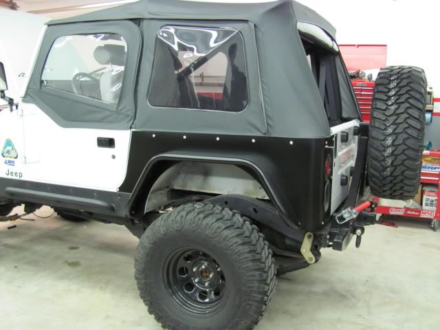

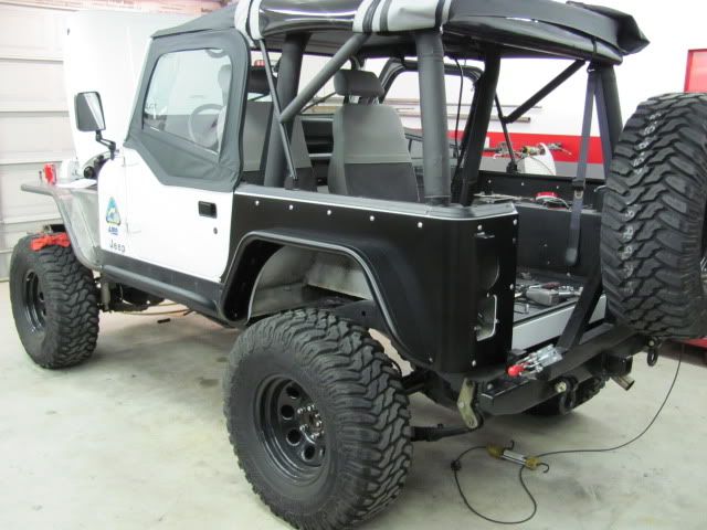

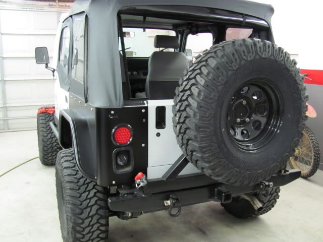

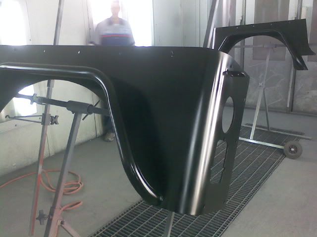

we are starting to make some progress now. We took the quarters to work today and got them painted and we also got the winch installed,Tomorrow plan is to prime and paint the fenders and do final assembly here are some updated pics
Pieces prepped for primer
after a coat of sealer
and the SEM hot rod black
And of course when you get home with some new goodies you cant wait to put them on
and a side shot with the top back on
