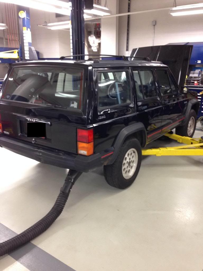

First drive home from Hicksville Long Island to Astoria Queens I started to have the all to common heat issues. Temp gauge touched red a few times, but i decided to get her home and take a look. She ended up having a leaky radiator cap and some of the dirtiest coolant my mechanic buddy and I had ever seen. Straight black. Luckily enough a buddy of mine works for Mercedes of Manhattan so I am lucky enough to be able to use his bay for work on the weekends and all of the crazy shop machines they have (their coolant change machine is great!). We pulled the old coolant like i said pitch black, and refilled with water and a flush, pulled that out, then went ahead with a 50/50 mix and a water pump seal conditioner. The "overheating" problem has stopped from what I have seen since completing this through various driving, from letting it sit for 20 minutes @ idle, too Manhattan during rush hour. Actually has a pretty tough time getting over 180 mark now that it is getting colder so I picked up a 195* thermostat in an effort to possibly help with mpg as well. I know these 4.0L's do enjoy the heat.
Went higher than this photo show's
(best invention ever for doing a flush)
We also ended up running basically the mercedes version of seafoam through the truck after I had swapped what looked like the original air filter with a MAD JDM PERFORMANCE YO specter panel filter.
