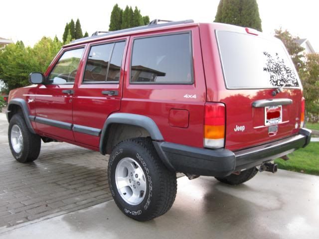

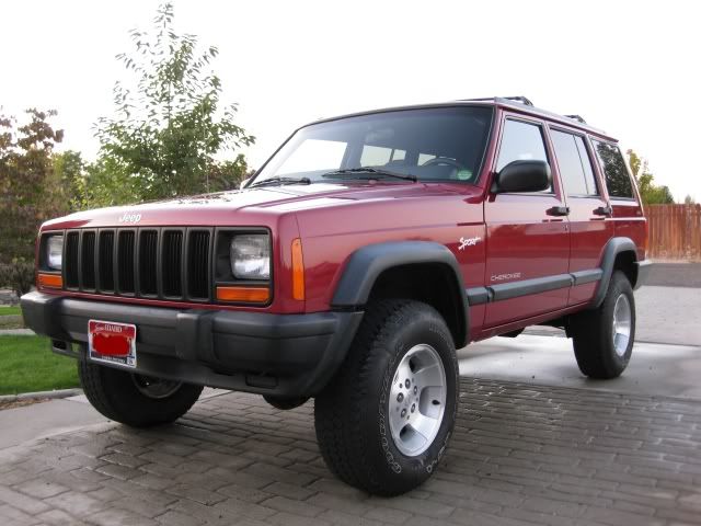

Got it cleaned today decided to take some more post-lift pictures, as the only ones I had were of the night I finished. I have been busy with school.
