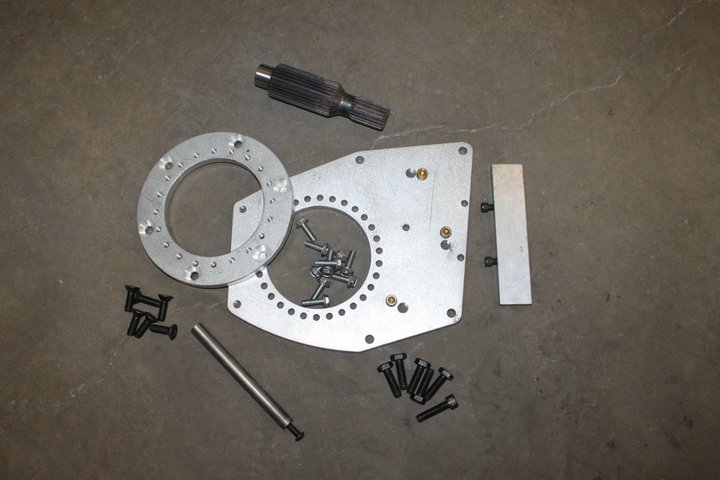

So some how I got this bug in my ear that after the stretch I want to build a doubler 231/300 setup since I'll have the extra room. I like the idea of being able to select how low the jeep will crawl without paying so much for an Atlas or Stak transfercase. Only issue I've seen is trying to find a kit still on the market.
Military Jeepers
S.W. New Mexico region
yellow_snocone is offline
post #614 of 925 Old 10-23-2013, 08:48 PM
G Beasley
Join Date: Nov 2001
Location: Eden
Posts: 5,712
http://www.pirate4x4.com/forum/motor...earbox-12.html
I think NWF is still making them .
G Beasley is offline
post #615 of 925 Old 10-23-2013, 09:12 PM Thread Starter
yellow_snocone
Location: Holloman AFB
Posts: 1,465

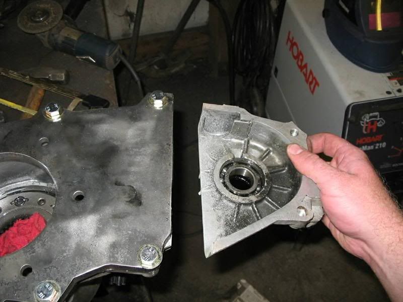

Looks like he makes the front doubler complete setup only. I've been looking at the a kit that only comes with the plate and output shaft. It requires you the cut your 231 in half and weld the new plate to it making it the doubler and just attach the 300 to it and your good.
kit
cut up
complete 231
231/300
This should run me roughly $700 depending on the cost of the 300. I may sell my 231 and use a used 231 to walk away with less paid into this mod
