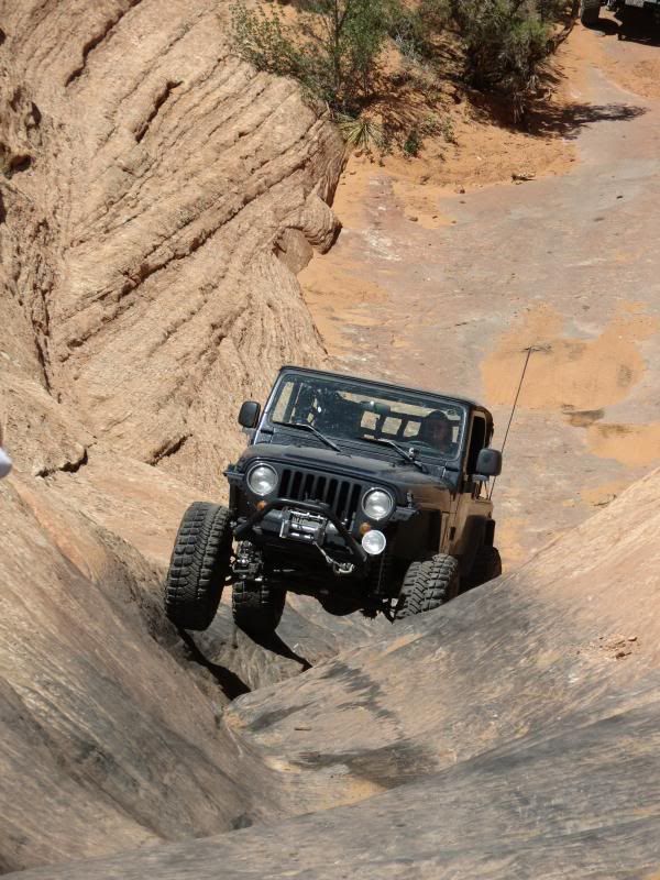

I'm too sexy for my Jeep is the theme music for this series of pictures . I had no idea my wife took these and I laughed like heck when I saw them , thanks for being a good sport and putting up with the picture hound !

Almost home I had a amazing time at moab with the jeep forum build crew. We need to do this again, it was a blast and I have a few trails I need to get knock off the list lol. I'll be sure to put the pictures I have when I get home tonight.

post #329 of 925 Old 06-08-2013, 01:24 AM Thread Starter
yellow_snocone
Location: Holloman AFB
Posts: 1,465
Some pictures from our trip
