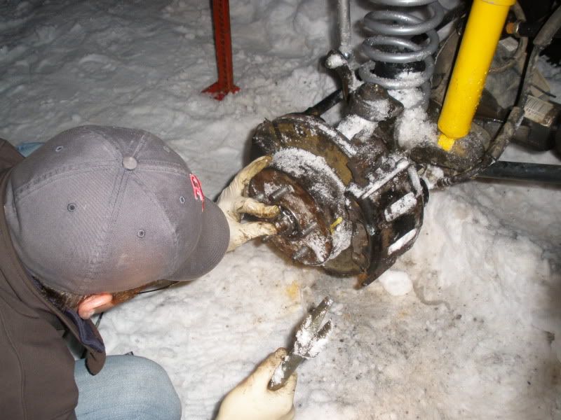

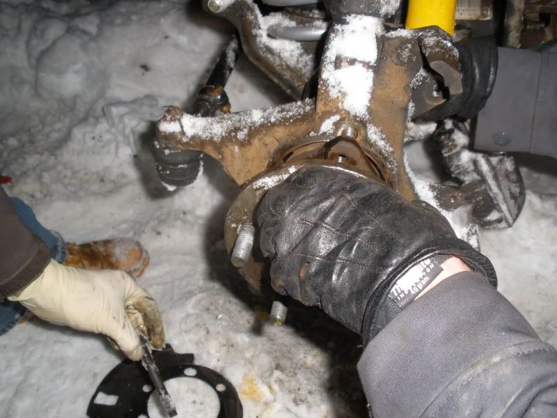

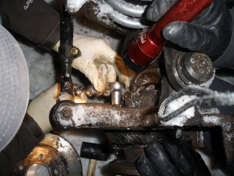

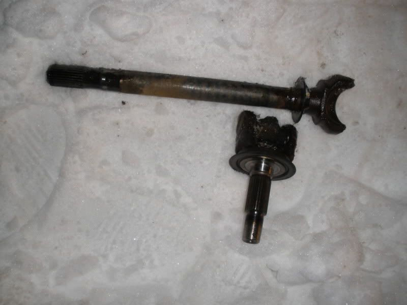

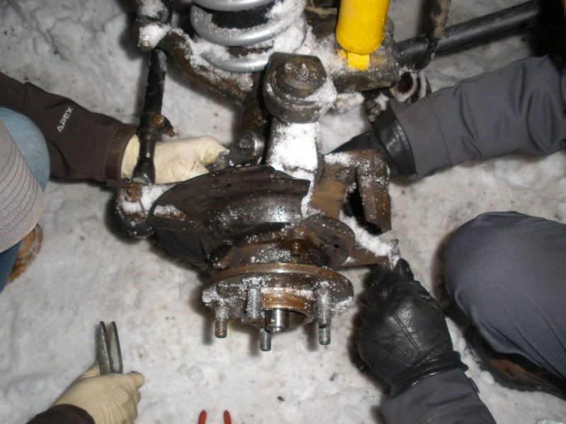

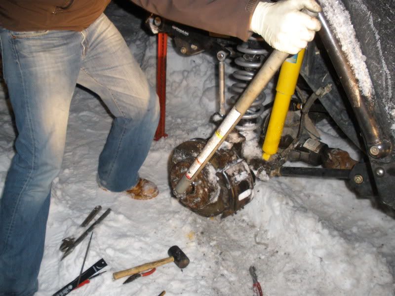

Thinking about this, it's actually a GREAT bit of practice to do this in your driveway sometime so that you're not doing it for the first time on the trail. Having swapped out my shafts for chromolys / helped out on a trail, it was pretty straightforward. You never know when / where you are going to get stuck, and even if you don't have a spare with you, you CAN still drive after breaking a shaft. You'll have to remove the inner (hence that it's good to practice somewhere nice and lit / comfortable)... but you can then use the outer assuming it's not mangled in such a way to have clearance problems. Oh, and make sure you have a 36MM socket!
Hi-Lifted up, ready to go...
Hammering a socket on to a filed down bolt... with a wrench That's me in the hat!
Socket's on!
Hi-Lift handle turns into a GREAT breaker - slid it over the socket wrench.
Pulling the hub - came off right easy...
Broken Shaft!
Almost done!
