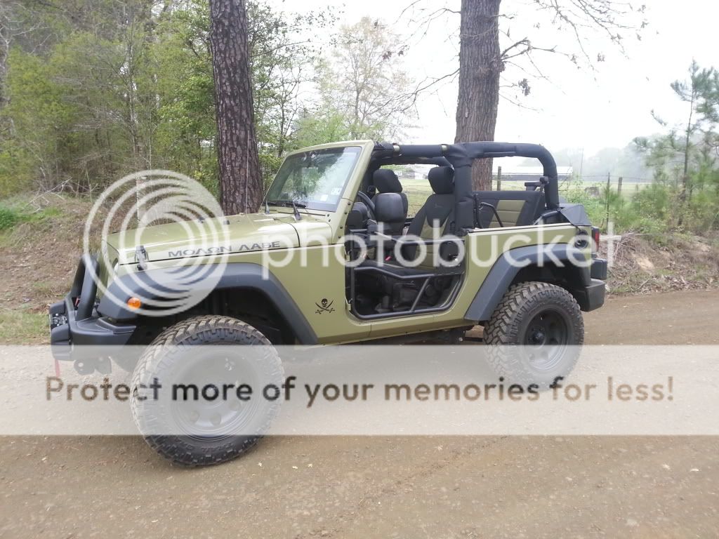

Removed the 2.5" Rough Country budget boost and installed a Rock Krawler 2.5" X-Factor lift. Gained 2.5 inches in the front and 1.75 inches in the rear over the BB. Installed a TeraFlex tailgate hinge and adjustable tire carrier, and mounted new spare 35 inch tire.

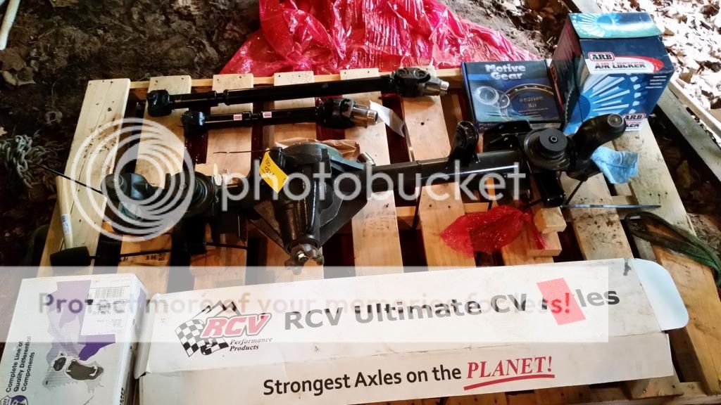

Finally got the front ProRock 44 installed. It is the unlimited version with more caster angle and 1/2" tubes. Has 4.56 gears, ARB locker, and RCV shafts. Re-geared the rear axle to 4.56 and installed a second ARB locker there. Changed both drive shafts out for Coast 1310 units.
