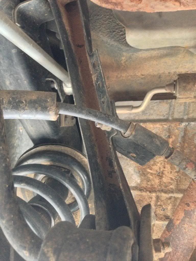

So my original reason behind getting a new driveshaft/SYE was I figured I was going to need it after I did my lift. But I don't have any vibe problems, is there any point in getting a new shaft/SYE for the time being? I could use new CAs cause the bushing on a few of them are just about shot. Just wondering if my money could be better spent elsewhere for now. Opinions?
Pinion angle look alirght?

If you are not getting bad vibs and eating up u-joints then don't worry about the SYE. All Jeeps are different how they react to a lift, your DS and pinion slopes look good. You have a auto so that probably helps alot. But, I can tell you that you will be able to tell the difference after doing a SYE/CV driveshaft.
I just zip tied the brake line to the upper CA's when I installed the Savvy CA's.

Is the brake cable being bolted to the rear upper CA a normal thing? How would I go about relocating it when I switch to the Savvy's? Do I just let it hang, or zip tie it somewhere?
Absolutely normal...from the factory in fact. Most people do, subsequently, zip-tie them in place onto their new arms, vice just letting them hang freely. Just make sure of 2 things when you secure them:
  • You have freedom to fully droop without pulling them away from the bracket (or ripping the bracket off)
  • Control the 'slack' such that the passenger side cable doesn't come into contact with your exhaust
Don't ask me how I know about the second recommendation...:
Good luck with the install this weekend
