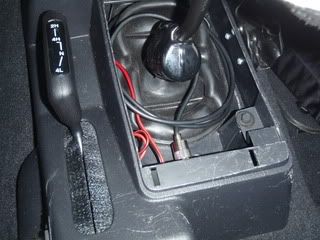

So first things first, and I'll work from there. We'll start with the CB. I got the Cobra 75WX ST CB because everything is in the hand mike. I like the clean look and no excess stuff. I got it all mounted but had to wait for the antenna. The junction box is hidden under the center console, so here are the pics.
The junction box is hidden under the center console.
All the wiring is hidden under the dash and routed with the other wiring. The stud comes through the plug behind the rollbar and out the taillight wiring hole. It's all attached to the Tera-Flex Antenna Mount. Stud is a Firestik "Fire-Ring" and the antenna is a Firestik II..
Now I just have to get it tuned.
