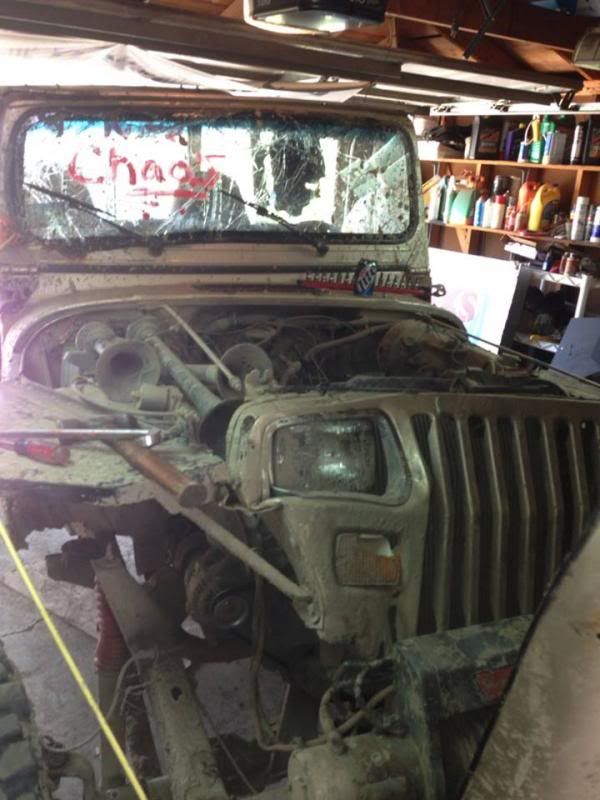

then this happened, i was going up a very tight trail with no room to get a good line. my tire slid and i hit a tree. well i actually drove up the tree and cartwheeled 2 times and was stoped by a tree behind me. so im told. i only remember some of it. i ended up landing hard on the cartwheel and my body fell out of stock seats and i landed on my ribs. 7 broken ribs later, im rebuilding her.

looked at everything and started to disassemble.
the tub, hood, grill, windshield frame, fenders all destroyed.

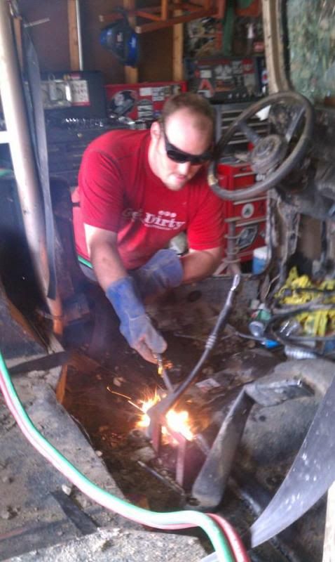

after we got to rear corner armor off, the rear part of the tub was all free so we decided to cut it off to make some room.
this is me, dont tell the doc i was doing work only a few days after i broke my ribs. iw as mostly doing small stuff like taking off wiring, hoses, snapping pics. and picking up tools. only so mnay people know how to cust and weld steel so i had to do that.
after it was cut we removed the back half of the tub.

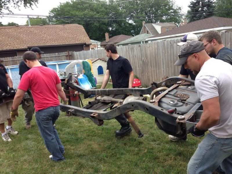

one of the guys in the club brought a trailer to get the new parts from down the street where they are stored.
the whole frame was a roller, so we took the tanks over and i just cut the leaf springs, track bar, sway bars. just needed the frame, this is all the same day so i missed a bunch of pics but you get the idea.
everything loaded up!

we then removed all the bolts and leaf spring ends. then through the new frame on the drivetrain rolle dit in to get bolted up to the engine.
