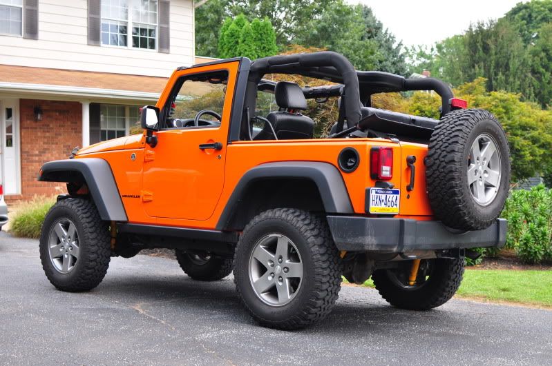

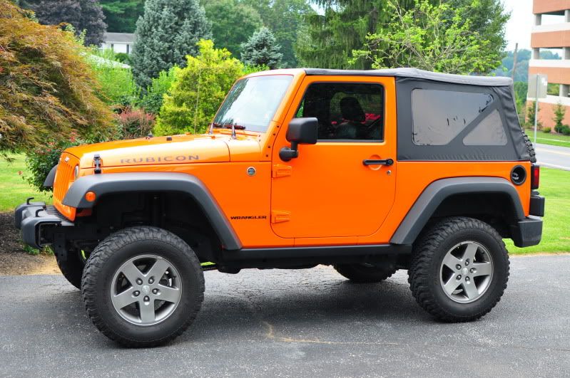

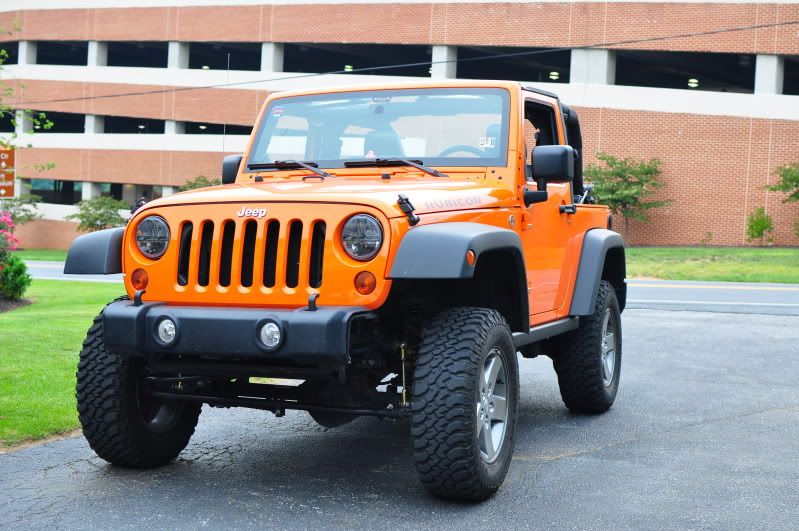

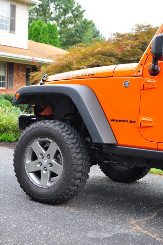

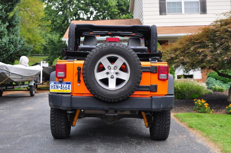

LIFT UPDATE: She's completely installed and sitting ~3.75" higher in the front and ~3" higher in the rear. Blows me away how much of a difference this makes!! My tires look pretty small, but not so small that I can't get away with running them for a few more months before I go to the 37s. I must apologize I haven't taken any HQ picture yet: I'm just an amateur and I lost my SD card, so I have to go get another one since I don't have a backup!
The lift rides GREAT — I would say it's 90% exactly the same as stock, but different in these ways:
  • The compression is softer and more controlled over speed bumps/inconsistencies in the road. In other words, it's just a tad softer soaking up the bumps.
  • Body roll in turns is notably reduced so it feels a bit more planted on highway on-ramps and windy country back roads.
  • It is a bit louder in that some of the arms squeak when going slow over bumps. I'm going to re-torque the control arm and track bar bolts to try and get rid of this.
I am very happy with the pairing of the Old Man Emu Long Travel Sport shocks and the Rock Krawler 2.5" Max Travel lift. They compliment each other nicely, and I couldn't be happier in terms of money spent and performance received. Can't WAIT to see the benefits offroad!
So things I ran into during install:
  1. To get to the passenger side shock nut at the top, let alone installing the new shock, the mud guard and support fins along the bottom of the TIPM need to be trimmed. Both are easily accessible with a pair of tin snips and a sharp chisel. Clearing enough room up there to gain wrench access makes everything a lot easier ... stop worrying about cutting your brand new Jeep and just do it. You can't see it, and any onlooker will not notice your change.
  2. The swaybar is hardened as **** ... I went through two drill bits to ream out the holes to 1/2" for the RK adjustable/quick disconnect end links. Had to take it to a shop to use a die grinder and more powerful drill to get it done. That's the only portion I needed outside help, though.
  3. Apply Loctite and torque the jamnuts for the CAs and trackbar BEFORE installation: this is mentioned in the instructions, but it's worth mentioning again.
  4. The SS extended brake lines are great but rub the shocks up front, and the inside of the rear tires out back ... going to pick up some rubber tubing to zip tie and protect.
  5. Spring compressors for the progressive front springs are must — you will not be able to droop the axle far enough to get them in without!
  6. I didn't have to go to a dealership to get the steering wheel center reprogrammed: I just centered it using the adjustable sleeve on the draglink and haven't had any ESP or computer controls kicking in.

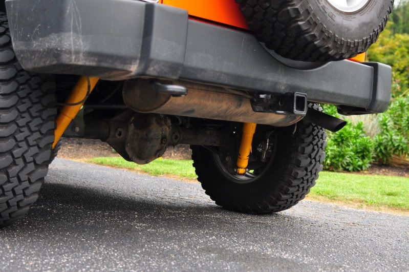

Just flexing things out to make sure the E-brake, ABS, axle breather, and brake lines have enough slack, as well as checking the bumpstops.
I found out where my squeak was coming from: the Currie rear coil spring retainer on the axle side was rubbing the inside diameter of the coil spring ... whenever it would move, *SQUEAK*! So I off the Currie retainers, b/c I still haven't figured out how to get the top portions installed.
Not even close to fully flexed out, with stock 32" KM2 tires.

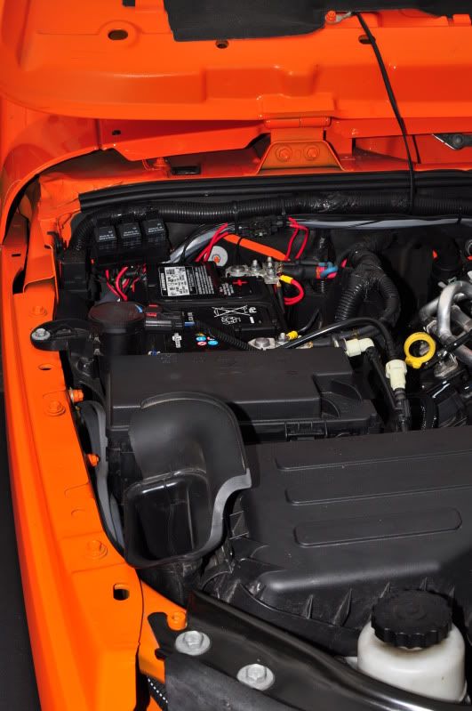

Did you run the headlight harness for the driver side headlight across the firewall and down the driver side? Trying to determine the routing before I receive my harness and lights.
JKUCRUSHMIKE is offline
post #95 of 111 Old 09-09-2012, 07:48 PM Thread Starter
C2U5H
C2U5H's Avatar
Join Date: Aug 2004
Location: Westminster
Posts: 2,220
Sorry for the late reply -- I'm assuming you've done the install already. I zip tied the relays to the main wire loom harness behind the battery and ran the driver side wires behind the main wire loom across the firewall. I removed a few hex screws to shift components around as I went down the driver and passenger sides to run all the wiring as concealed as possible.
