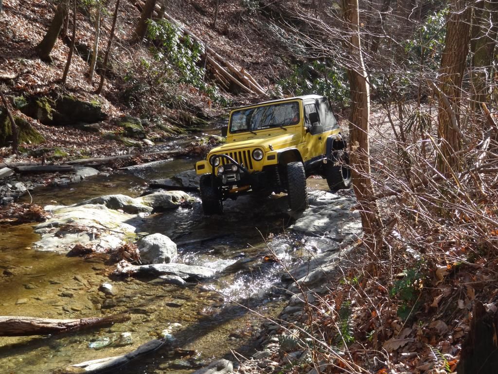

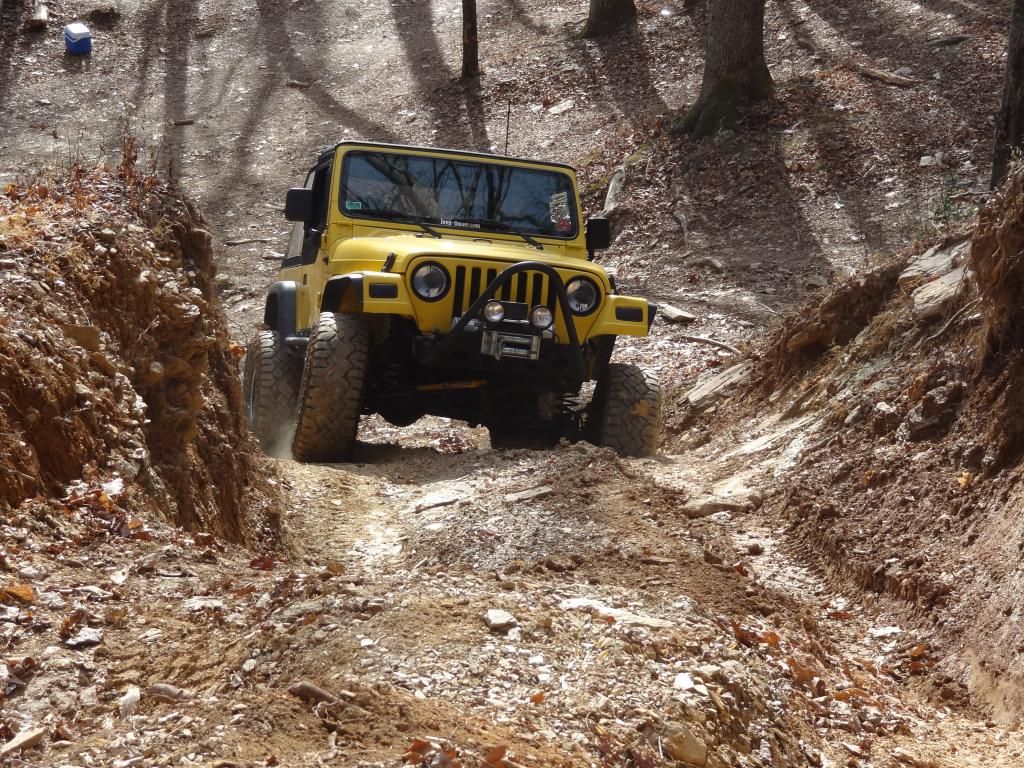

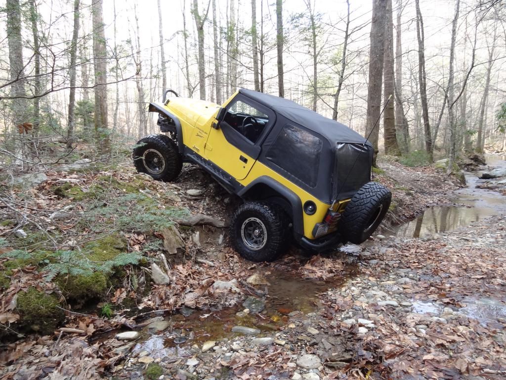

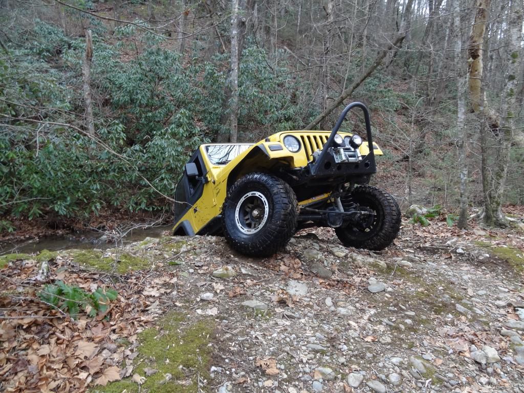

Just recently got home from school and another busy semester. Hadn't really done anything Jeep related at school so I didn't have any updates. Went on a run to Richland Rd the other day with a buddy of mine and had good time. The locker performed very well and I had no trouble making it through anything there, opposed to last time when I had a a little bit of trouble in a rocky creek section. Here are a few pics from the trip. I had also trimmed out my front flares at the end of last summer.
