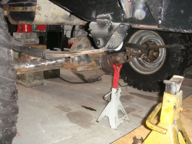

Why YJ springs, out of curiosity?

If I remember correctly, CJ springs are really narrow, YJs are a bit wider.
YJ front springs are a wider, flatter spring which should give better flex and offer a better ride. It's a popular CJ SOA swap. Figured I would use them since I could'nt reuse the other springs.

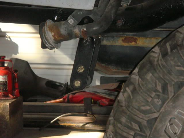

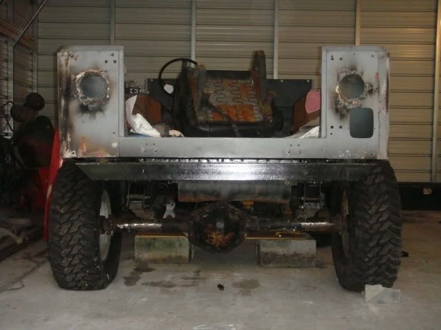

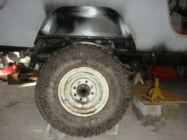

Got the rear all tacked together. I'm going to wait to weld the perches solid until I get a driveshaft and the transmission mounted in case I need to change the pinion angle. Should flex well, the springs are much softer than the other springs. Definitely will need some kind of traction bar though.
And a better shackle angle

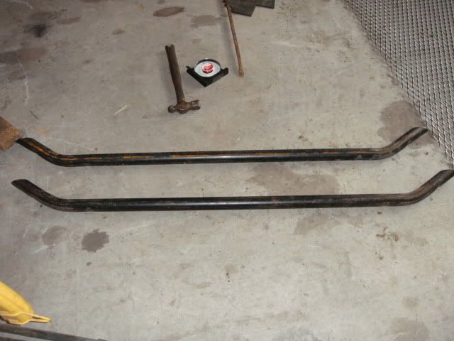

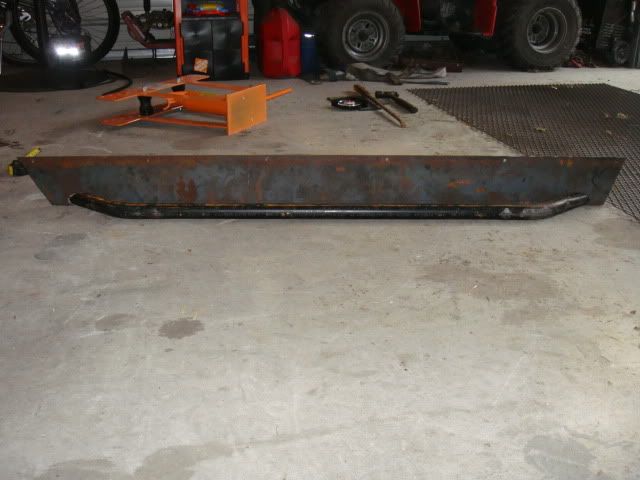

Bent some pipe today for the rocker guards. Turned out ok, a few creases from the HF pipe bender. Need to grind down the ends a little for a better fit. Leaning towards cutting some plate and getting it dimpled died to make a step.

Going to call some fab shops to see if they can do it and how much $$. That will probably be my deciding factor.

i can get some landing matts for free i think ..looks the same and has like 3 inch holes..i didnt think of that..we could just cut out the strip we need from one peice and have a lot left over..sound good..i will get with my dad when hes back from mississippi..dont spend money yet jkl

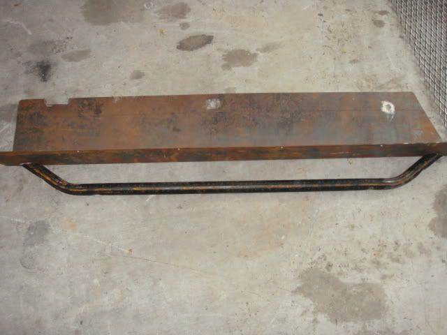

Built the rear bumper last week and finally got around to uploading the pics.
I was going to build it to like the ones I did on my LJ but after some measuring it was going to end up wider than I wanted so I changed the angles a bit. Later on I'll probably add a stinger style spare tire mount.
Here a pic of the LJ one.
Used all the left over materials from the previous project. Cut a piece of 2 x 4 x 1/8 down to 54"
Then cut the angles. Down 1" and in 3"
Cut out a hole for the reciever, then redrilled the pin holes and cut it down.
For the weld critics. May not be the prettiest but they hold.
End caps
Ground down and cleaned up with a flap disc
