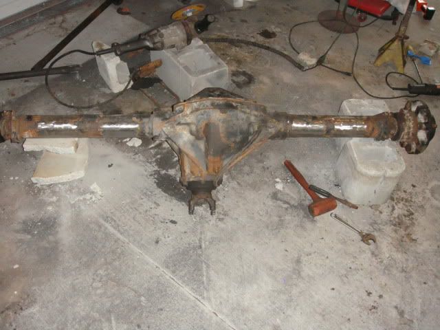

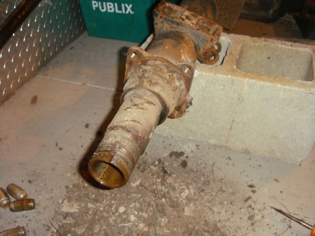

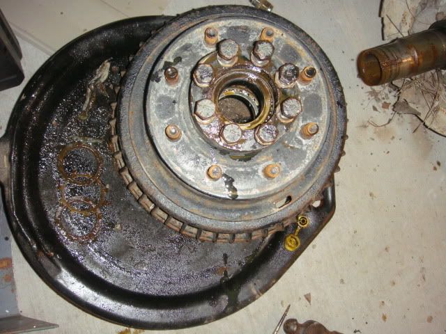

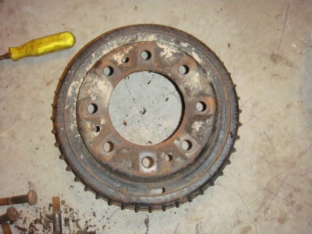

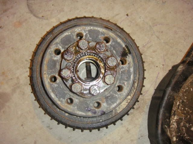

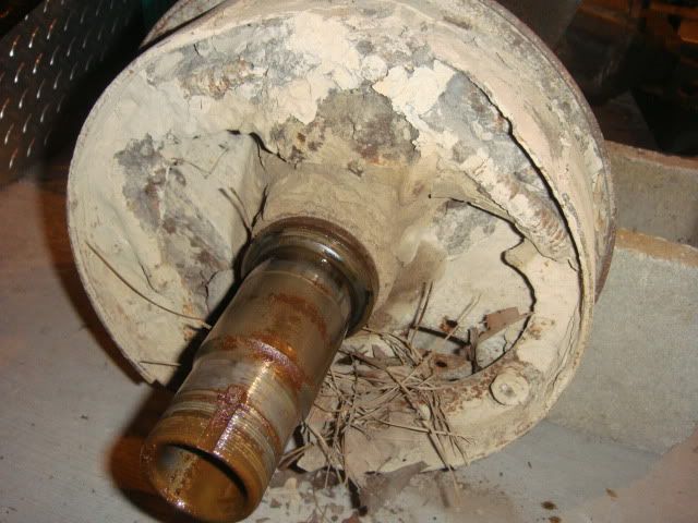

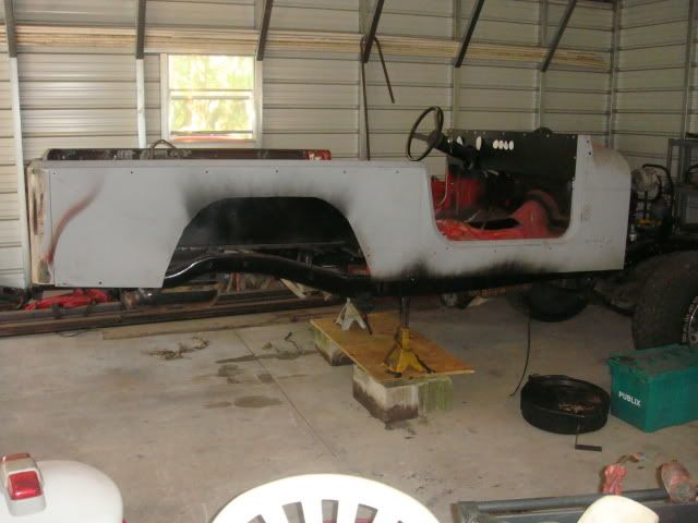

Started tearing down the rearend this evening. Thurs or Fri I'll cut off the all the brackets.
Now I remember why I hate mud.

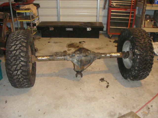

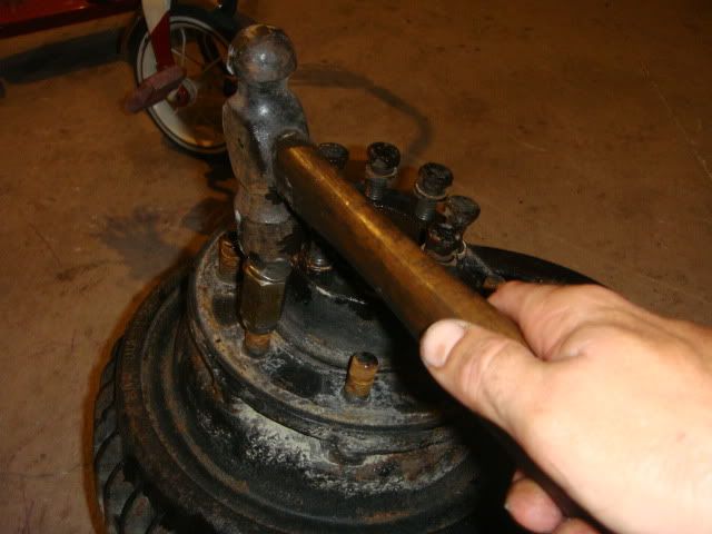

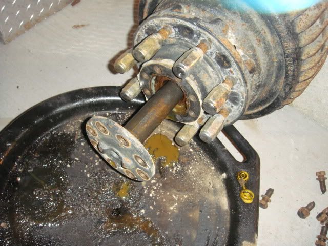

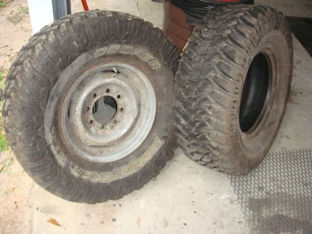

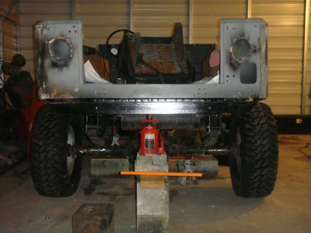

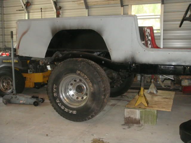

Finally got done cutting off all the brackets. Put the hubs back on and 4 studs back in to put tires on it.
Going to use these tires and wheels as my temps until its time for the big ones. They are 305/70-16 so they are the same size as the front.

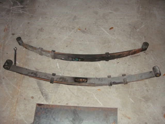

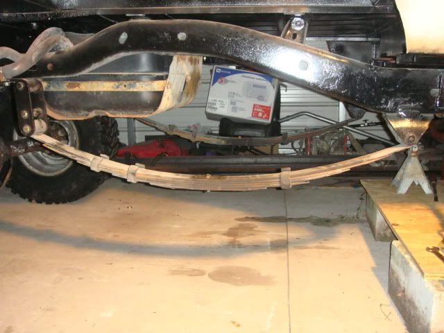

Found some stock YJ springs today. Hopefully I can get them Fri and have the axle under the Jeep this weekend.
Much easier to move around now!

looks like they still got a lot of meat on them

Yeah, they are practically brand new. Had them on my dually and took them off when I sold it. Put the other 4 on the YJ when I sold it to keep the 35's.

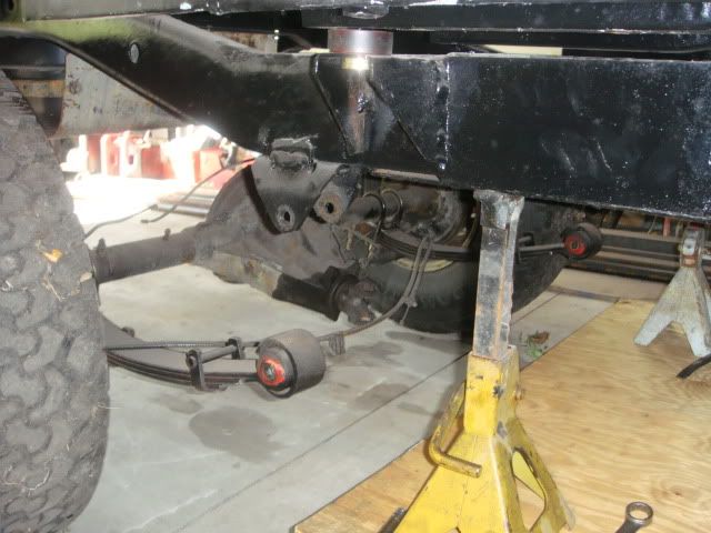

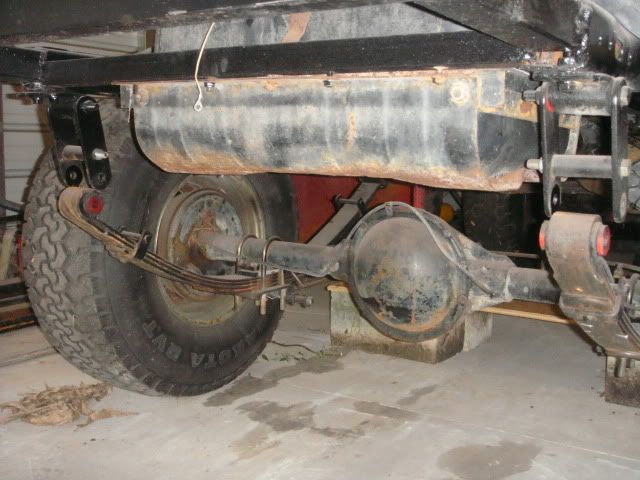

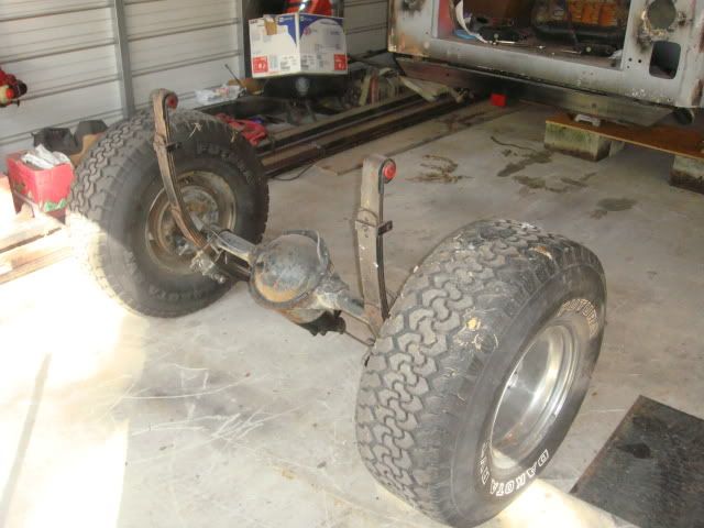

Picked up some new to me YJ springs today and got the rear axle under the Jeep. Got to make a few adjustments on Sat and then burn in the new perches.

Your shackle angle looks horrible...... I'm just sayin'.

Why? I was thinking they should face towards the rear. I know my on my old YJ they pointed opposite directions. Ideas on how to fix it...

Lol nevermind, I just noticed that the spring isn't under load.
Maybe it's a CJ/YJ thing, but on XJs we want it to be about 45* and point to the back.
good angle
at droop:
compressed:
Moving the spring mount back a little, would fix it I think. IKD, if our shackle angle is all jacked up on XJ's we usually have to do shackle relocation brackets or something.
