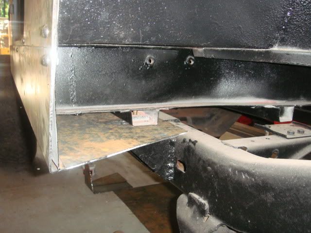

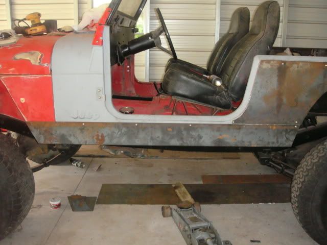

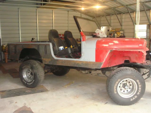

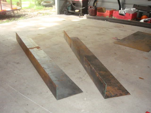

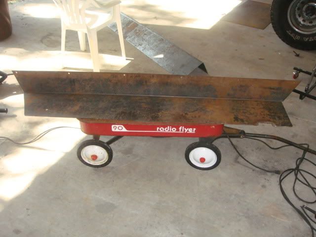

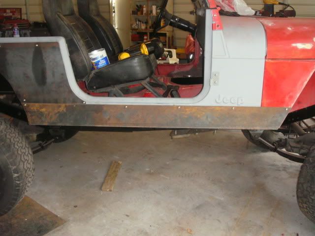

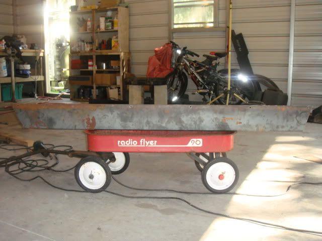

Got the rocker guards bent today at a fab shop. They bent one of them wrong , but fixed it and did them for free for the screw up . Got the driver side finished, should get the other side done tomorrow.
Marking the hole locations
Have trim up a little around the body mount
Ready to be installed
Bolted up
'13 10th Anniversary Unlimited Rubi

I really like this build, I can't wait to see it done. No tubes on the sliders?

There coming. I did a mock up with some scrap and didn't like how they turned out. May go to the fab shop again and have them bend them for me.

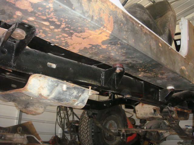

May of found a motor, tranny and transfer case. Hopefully will know something this evening.
Just finished the passenger side rocker guards. Got to pick up some rivnuts for the two holes where the body is double walled.

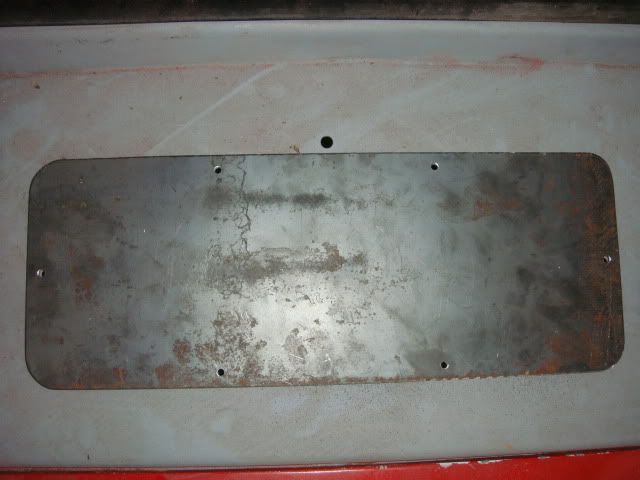

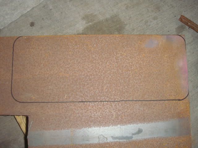

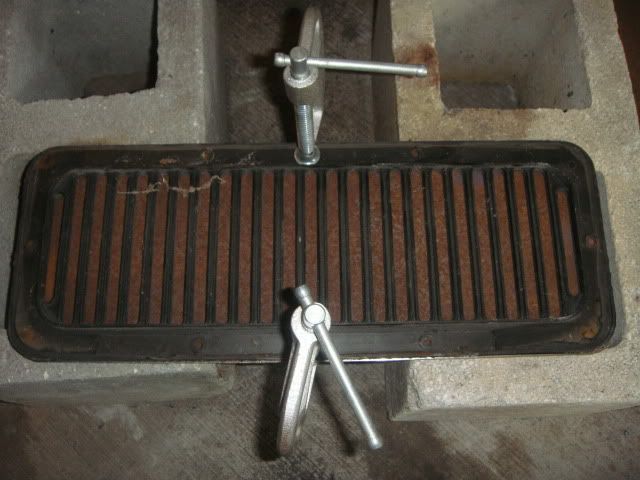

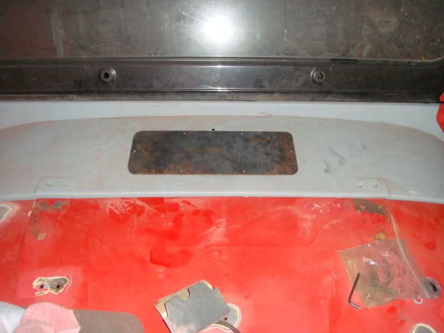

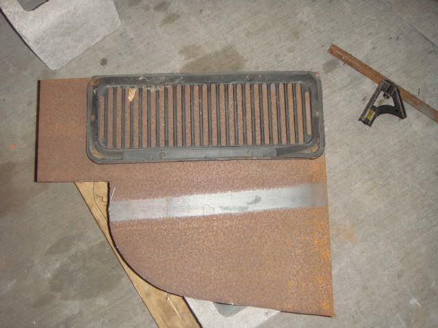

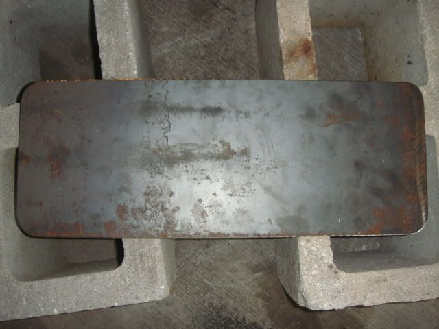

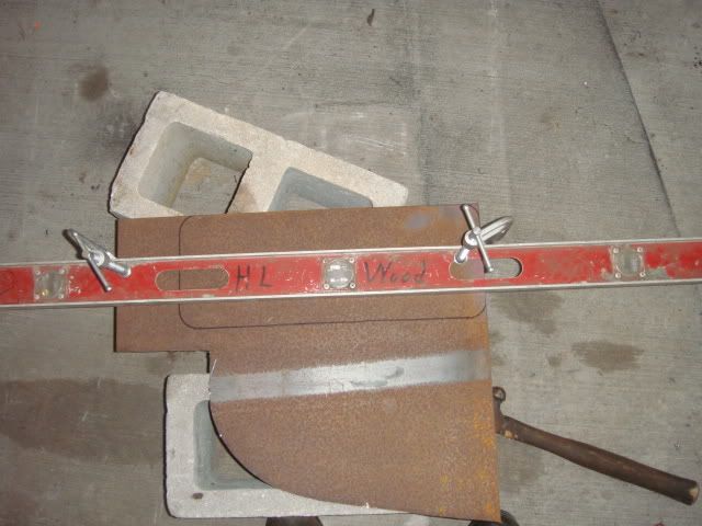

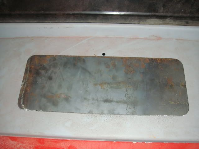

Made a cowl vent cover plate today since I won't be running a heater.
Used the original as a template.
Cut it out with a circular saw and rounded the edges with a grinder.
Marking and drilling the holes. The original cover had four less holes than the body does. Once I get it bolted down I'll mark and drill those.

Is that for removability? In other words, why not weld it shut, bondo over it for smoothness, and then paint over it when you eventually do your paint, so that it's one continuous smooth surface rather than having a plate screwed onto it?
I'm not saying "you're doing it wrong" just curious.

Originally Posted by Firekite View Post
Is that for removability? ....
Yes, one day I may decide to put the heater back in and this will make it easy.

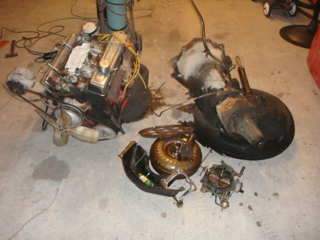

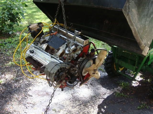

Look what I got last night SBC 350, TH350 and NP205 Hopefully Saturday I'll get them all cleaned up.

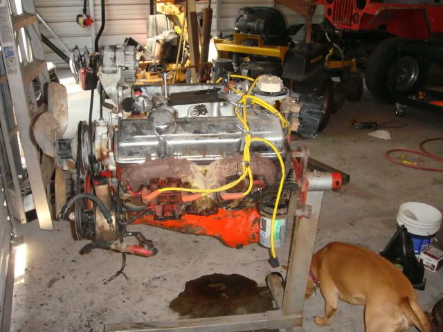

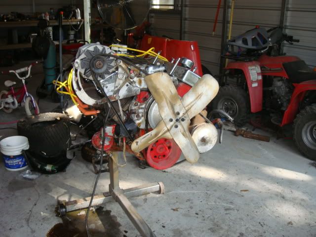

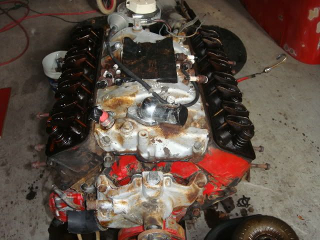

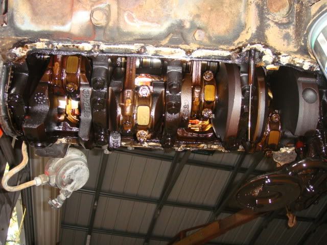

Had to hold over for a while at work this morning so I didn't get done what I had planed. Still have to clean up the trans and transfercase. Everything looked good inside the motor so Im just going to replace some gaskets, water pump and the oil pump. It has a newer short block with low miles.
Pressure washing
On the stand
Tore down
